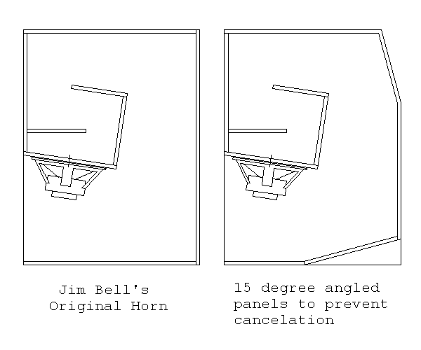

Hi Scott! I really appreciate you sharing your efforts. When you
are happy with the results, I hope you will share the construction
details.
I'm more comfortable with geometry than electronics, so I have
contributed by creating/documenting horn foldings. To date, I
have posted 6 sets of plans, including a version of Jim Bell's big
horn. I am also a builder, having built a single fold TH using the
Kappalite 3015LF and a double fold TH using the LAB12.
Your comment:
"All that fancyesque tapering fixes the upper bass problems and smooths out
the 70 hz or so cancellations caused by parallel walls."
Won't the attached mod eliminate any reflection problems with Jim's big horn?

DON, That should help for a sub only application. The problems I encountered only went away after I minimized the side wall parallel surfaces. Getting most of the taper is easy if you do it in the center of the box so it doubles as a central support. The problem is getting from your drivers entry point to a split horn while keeping it tapered around the turns. This is much worse on the CTH which is where I am hung up waiting for dedicated time to work out the geometry and buildability of the first stages.
