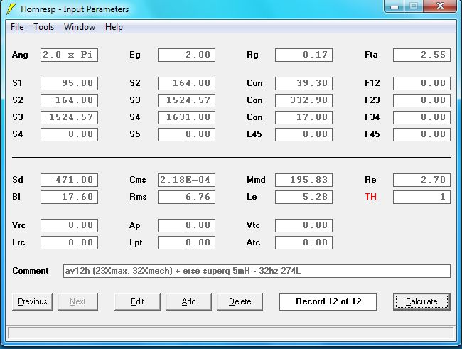

Now can someone please tell me what the deal is with inductors? This box needs a roughly 5mH inductor in series.
What are the downsides to using a design with added inductance? Reduced power handling?
Would the 500WRMS Erse Inductors at Parts Express be alright for the 600W amp I plan to use?
Ta 🙂 :smash:

Sorry to double post this, but does anyone think it's worth my building?
My target is ~30hz -> ~100hz, 2pi space, ~126dB. It's pretty close, and I like that it's done with a single driver (cheaper), and within linear Xmax. I've no doubt I could do a bit better using 2 drivers for the same SPL, but at double the cost.
Thanks 🙂 :smash:

fb said:
Thanks Ian. The Erse XQ 12g look great - though they are a bit expensive even when on special... I emailed Erse, and they suggested that their SuperQ 14G would offer nearly the same distortion performance with my amp RMS rating of 600W. They have a video showing THD vs. input power... Do you think this is a reasonable proposition?
Cheers 🙂
Yes, the biggest SuperQ inductors should be fine at these power levels and are cheaper/lighter/smaller -- at least if Erse show distortion levesl this is far more than most suppliers do.
For 2kW/4ohms and above only the XQ 12g will do... 🙂
