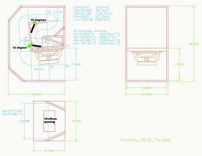

FurySub_2009
This is an attempt at drawing screamerusa's FurySub_2009.
I picked S3's location, because after that point the taper doesn't change, and before this point it does to some degree not matter in Hornresp (S2 to S3 areas and distance only, the actual convolutions are not modelled). The location of S2 and S1, as well as S4 and S5 are defined in Hornresp.
The area for S2 was picked on-axis with the horn, and by definition, in the middle of the speaker throat. As close as I can tell from the information provided S1 is a sharp corner between two side reflectors, I think Hornresp S1 minimum would apply there.
Still does not model too well.

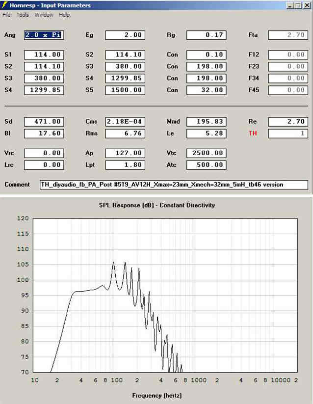

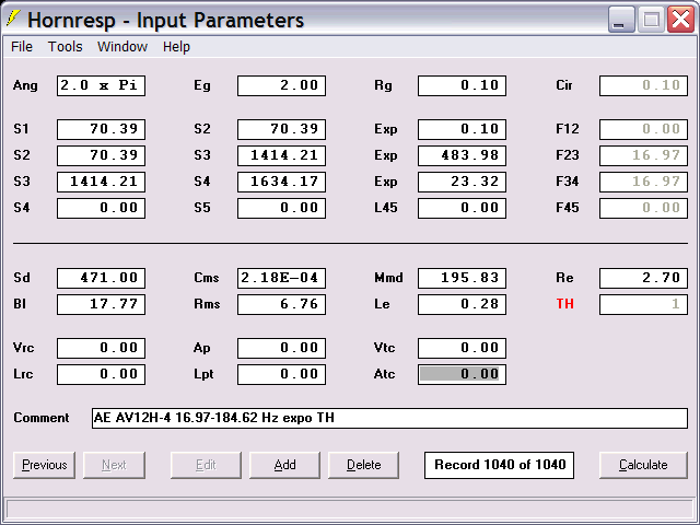

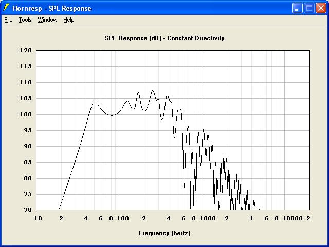

Posts #519 / #529
Hi fb,
Here is another take on building a tapped horn for the AV12H to your specs in Post #519. This one models well CON and EXP. Seeing the difference in response between screamerusa's measured results and the Hornresp model, I'd use OSB for a trial run.
Hi fb,
TB46....wow that was quick. Thanks.
You pretty much nailed it. I added the angle changes to the first two reflectors.
I was looking at some fluid dynamics sims and remembering some basic room acoustic issues and applied that to how the reflectors were done.

FurySub_2009
Hi screamerusa,
On your revision is that 12 degrees for both angle pieces, and is the opening 15x29cm? The resolution is just not quite good enough for me to read.
What do you think about jbell's suggestion (Post #532), that removing the internal reflector resulted in filling in the first response dip, and if so, have you tried removing the 'upper left hand' reflector (squaring the outside corner)?
It's definitely quite an achievement to get this close by modifying the enclosure "life".
Hi screamerusa,
Re: FurySub_2009
One side of each piece is cut at about a 12 degree angle, yes.
15x29cm is the original opening, correct.
I will do some rechecking in a couple of days as this is my bust part of the week. The drawing looks spot on.
Removing the other reflectors all yielded unacceptable dips and losses.
The one "missing" reflector was my insane atempt to "cut" the path length and create a higher spl "Bounce" affecting the 100hz area as I was not getting ANY gain over the direct radiator.
Please remember that the goal was not to build the best tapped horn live sub (That's Tom's job), but to match or exceed a double driver cabinet to eliminate the amount of amps and wall power required to achieve high quality high spl with a 2.6ohm minimum load (3 drivers).. Smooth response at about 102-103 db from 38-125hz would be a realistic goal, for a single
You should see the shocked looks from the "know it all's" around here when they find out I'm only pushing about 5,500 watts on the mains. Except for one moron who insists I HAVE to buy 4 of his double 18 JBLs, not one engineer or bs artist looking for a quick sale, has had anything but praise for the 4 subs I'm using.
That tells me we have something here that is worth refining.
Edit: Hmm. that's interesting. No the reduction was not intentional. Glad someone else noticed it. It does look like
some of the geometry could be altered a bit. to smooth out
the back angles without causing any problems.
