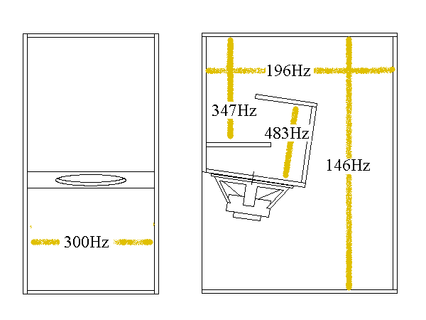

I can only take a few guesses.
1) The I believe the taper in s1/s2 is affecting compression in the throat.
2) Cancellations?
3) While a solid brace cuts the back of the horn in two, it's either the loss of volume, or the way the back of the speaker in the mouth reacts with the horn. I am pretty sure it's only my cab that has this problem as the Danley seems to have a solid one.. ?????????
There seems to be a bunch of interactions and reactions.

jbell said:2. Why does removing the one reflector add +3db at 100hz? hornresp doesn't have any way to model with or without it.
3. Why does a solid rear brace diminish output down low (40-50hz, I'm guessing)
screamersusa said:I can only take a few guesses.
2) Cancellations?
A 1/4wl of 100hz is 29" and your front-back dimension is 29".
Should I assume any place you have parallel walls, you can set up a resonance, and it could either be a constructive or destructive resonance and in this case it was a positive?
I think I can make that argument work, as that is the only parallel wall section in your horn with no reflectors.
However the low end and solid rear brace thing bugs me. Not dividing that horizontal dimension in two with an 'open brace' doesn't line up with a 1/4 wl of any low end frequency.
As to the issue of the front angled panels from S1-S2... and then the 12 degree reflectors -- my only guess is that the benefit here, is that no resonance of any kind can be set up close to the driver, either constructive or more importantly -- destructive.

jbell said:
Should I assume any place you have parallel walls, you can set up a resonance.........
Parallel walls are half WL resonators same as room walls or an open pipe, etc.: http://hyperphysics.phy-astr.gsu.edu/hbase/waves/opecol.html#c2
I imagine the solid brace sets up a pretty severe reflection back to the throat due to a big impedance mismatch. I mean being split up at supersonic speed with no way to flow back together has got to cause some pretty severe shock-waves.
Right, the initial expansion is the horn's HF BW, so get it out of sync with the throat's BW and it affects the response all the way through its mids until the horn has become acoustically tiny and doubly so for a TH since both sides of the driver's output is in play, just compare a TH in 4pi space to its single driver variant.
GM

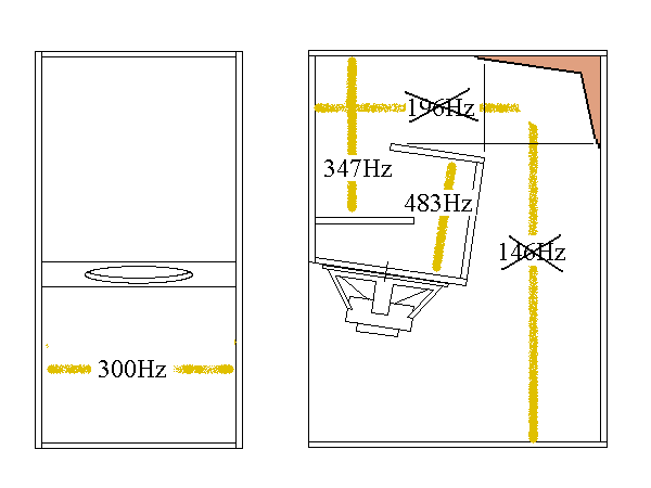

Thanks for posting that Danley bit. I'll be reading that another 40 times (seriously).
After all the discussion about reflectors not having any usefull effect, at the beginning of this thread: I played with them by ear and agree that they may not. It seems however to my ear, that when using sine waves I can hear many of the worst phase errors and nulls at higher frequencies. The 12 degree (roughly)reflectors are used to break up the 90 degree corners. While one might think a 45 degree would be better, my ear tells me that a 45 has little or no effect or worse makes more phase problems.
The steep angle made sense to me as to help redirect and diffract without direct cancellations. Think of a pool table where you try to use a "bounce" off the wall to get around another ball Without the cue ball and target ball colliding before the pocket.
If you draw 45 degree angles in the box you will see all the nasty "collision points" including a bounce right back down to the driver. If you omit the reflectors you get multiple notches. Perhaps someone can make more sense of this. It's a work around for a simple DIY box vs a very complex box nobody will be able to build without getting very frustrated.
screamersusa said:Thanks for posting that Danley bit.
You're welcome! He wrote a bunch more which should be in the PSW Labhorn forum archives.
Right, the higher the frequency, the acoustically wider the bend arc must be as proven by the Nautilus shell.
Note that due to boundary losses the reflection angle will be somewhat less than the angle of incidence, so without knowing the material's reflection impedance there's no way to accurately plot reflections, though if you make the reflectors out of steel the phase angle losses are probably low enough to be 'close enough' to angle in = angle out for the frequencies of interest here.

I am using a 45 degree for that one although I tend to err on the side of caution and throw it off a couple of degrees so that the face of the board is slightly up. For now 45 is fine.
The two 12 degree parts: If you look carefully at the 3rd picture down on the page you can see how they were atached.

Hi Scott,
I hear what you say, but I sure don't understand it!
Here's a cartoon of Jim Bell's Tapped Horn. I have added the five pathways that can
cause 1/2 wavelength reflections and cancellations. If we hope to use this cabinet
for 36 to 120 Hz, and our crossover is 18dB/octave, we don't care if a hole in the
response above 240 Hz is down 18dB or 100dB, 'cause you'll never hear it over the
midbass. Only the spikes are problems, but we can EQ them out
The 146 and 196 Hz reflections could use some help, but I can't see what harm the
others are going to do.

MikeHunt79 said:This is interesting stuff guys, and after seeing that pic Don just posted I was wondering if this would mean that folded TH's would have less cancellations over non-folded TH's below 100Hz or so?
More folds equal shorter straight paths, so sure, the cancellations are at higher frequencies. But wait ... now there are more bends,
and Tom has told us that bends have their own cancellation problems. Tom said it's best to make major bends where the horn
is small (the throat end).
