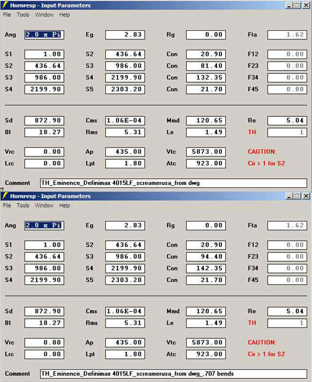

Hi MikeHunt79,
Sreamerusa has documented his design in:
http://www.screamersusa.com/furybox.html
and the transfer page has his Hornresp Input screen.
In Post #530 I added my 2 cents with a drawing, and in Post #534 screamerusa pointed out the angles of the internal reflectors. This led to the updated drawing in Post #535 which also contains the Hornresp input values in tabluar form.

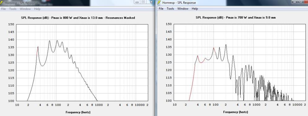

I'll attach my Hornresp Input screens for Post #579's SPL curves. As to the Ciare 15.00SW: it looks like a very fine speaker. It would be nice to hear the input of some of our PA-Pros on that subject.

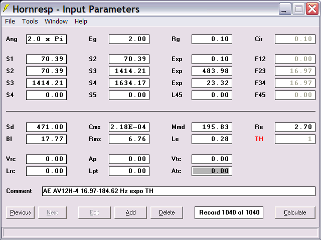

Hmm, didn't think about the EXPORT function, but when I went to test it using the expo sim I did for fb, I couldn't get it to work. 🙁
GM
GM
Works for me. Did you add the first line? (Horn resp doesn't include it.)
Akabak is tricky, but the export function from Hornresp makes it a heck of a lot easier.

Hi GM,
I just tried it again and the export function seems to work.
Let's see, in the Schematic window: File, Export, then from the right: I'm entering Uni under Width Flare, increments that match with inches (0.079/2.54/2.54/0.635), leave the Width alone, and set all the Height inputs to one value (e.g.: 35). Hit OK. Click csv button. Type in a name (up to 8 characters only), and hit save. The file is stored in the C:\Hornresp\Export folder. Open file with Quattro Pro (or your favorite spreadsheet), and everything looks fine.

Did you actually use the sim in question? I mean I can do it with other sims, but not this one and at a loss as to why. I get incomplete error messages and an empty file in the EXPORT folder which I can't delete until I close HR.
GM
Hornresp_Schematic_Export
Hi GM,
I could not duplicate your problems, sorry, but your simulation worked just fine for me. This time I made no changes, just Export - OK - click on csv button - name - hit save.
Well, back to packing for the trip.
P.S.: The attached file is a .csv file as this is not an allowed file type I changed it to txt - just change it back to .csv.
Greets!
OK, since the TH has an expo flare, it's what I was trying as well as the 'uni', but it works fine for me using 'con' also. Anyway, after much fiddling with other sims with no problems I wondered if somehow my sim was 'different, so deleted /re-inputted it, but that didn't help either. Setting 'S2' to 'con' and the others to either 'expo' or 'uni' did work though. Weird.
Anyway, thanks for the effort and hope you have a safe trip/pleasant holiday. Rain's in the forecast for us. 🙁
GM
P.S.: Interesting, I didn't know you could do that. Thanks!
