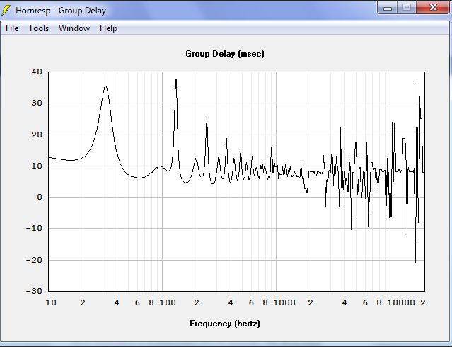

Delay

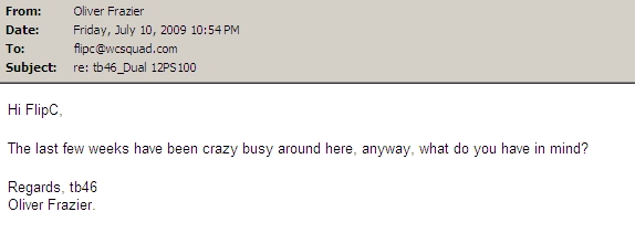

Sorry
The other day I realized I had set my Message Filter incorrectly for that email address. I had created a "Name Spoof" filter but instead of it checking to see if BOTH TO and FROM were the same I had it set to "IF ANY MATCH". Which means it was deleting EVERY email sent to me at that address since July 4th!
My apologies!

My email got bounced back this time.
This is what it said...
Ohh Here is my original Email relating to a question I asked in the Tapped
horn Forum.
