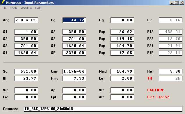

I tried to approximate the cab in hornresp and it looked terrible.
Not even close.
Could someone toss these numbers in ackbak as it's broken into 5 segments and post the expected response. This is what I measured off the working cabinets based on the original templates.
seg 1 0sqcm-506sqcm length 21cm
seg 2 506sqcm- 692sqcm length 10cm
seg 3 692sqcm-989sqcm length 54cm approx down center
seg 4 989sqcm-2292sqcm length approx 68cm down the center
seg 5 2292sqcm-2451sqcm length 21cm
driver entry between s1/s2 throat is 435sqcm
It should be putting out about 102db from 45-120.
The original non-glued one put out 102-103 from 40hz to 122hz.
Thanks.

Hi screamerusa,
I'm looking forward to your measurements, when I plug your numbers from Post #491 into Hornresp I don't get anything close either. Could it be that your seg 3 length is really 154cm (v.54), and seg 4 86cm (v. 68)? 🙂 That would still be a relatively short tapped horn. Naturally, Hornresp doesn't allow 0sqcm, so we would have to set that to 1, and S2 is the point where Hornresp has the driver, so it would have to be 435sqcm???
Anyway, if-in good fun-we would make those little changes we would get:
Hi screamerusa,
I think the s3/4 length may be a little off. The response of the actual cab vs anything in hornresp is way off. Probably because I have unintentionaly done something right like maybe mixing a couple of different horn types in the flare. I wish I knew what the heck I did, remember I built this totally on the fly using instincts and feel after god knows how many computer assisted tries.

These dims don't 'compute'.
GM
GM
