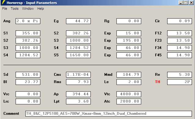

Hi FlipC,
Thanks for posting the pictures and the input parameters for your TH Mini clone. When looking things over I get the impression, that the L23 entry of 2.00cm may be a bit off, from the picture it looks more like 20.00cm from the mouth to the center of the cone.
Anyway, very well done.
Hi FlipC,

Hi FlipC,
Can you please tell us some more about your experiments with the compression ratio, and the driver positioning in the TH_Mini_clone of yours?🙂
I found that in Hornresp increasing the compression ratio will generally increase the SPL, does that not hold true in reality?

My mini follows the OG to a T on outside dimensions.
So 24x22.5x15. Internal is a bit smaller as I believe due to using MDF.
As far as what I originally did
was get some OSB. Build a rough cab of this (though wider as I was using a 15 I had) and made a driver mounting plate to test front to back positioning of driver. Just unscrew lift out. Cut new one. Etc.
As far as the compression goes. I just blocked off portion of the throat from driver like the sim showed. I removed this so driver fires 100% into throat. Went by my ear. I think overall SPL was lowered but sound wise it seemed more sensitive.

tb46
Thanks I will check out your HR inputs but I was referring to actual layout. I have 3 possibilities but right now I am looking at a cabinet
15"t x 27"w x 60" d. Very simple V type build. Just though odd sizing.
Thanks for the info Screamer.
You refer to XTC and CE amps...?
The EP 2,3, and 4 K amps just started shipping.
And they have another one out now that looks exactly like the QSC's.
I will get one of the EP 4000' rip it open and check the specs on the parts. Put it through hell and write a review.
I got through with my taxes
so hopefully it doesn't rain tomorrow so I can pick up some OSB to start on some test boxes.
