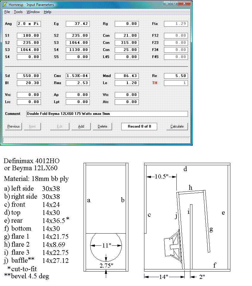

Hi Craig, Freddi
What with 20+ frets forcing the pickup below the 1/4 string length position, and the pickups rolling off, and the speakers
rolling off, and, of course, our ears rolling off, it's a miracle we even notice the E1, much less the B0.
Thanks for the input on the active EMGs, I was going to try bridge mounted piezos next, but I'll consider the EMGs.
I did a double fold version of Cowan's 30 Hz TH sometime back. I just found out that it caught on in Germany (using a Beyma
driver). I think it would be a good bass cabinet.

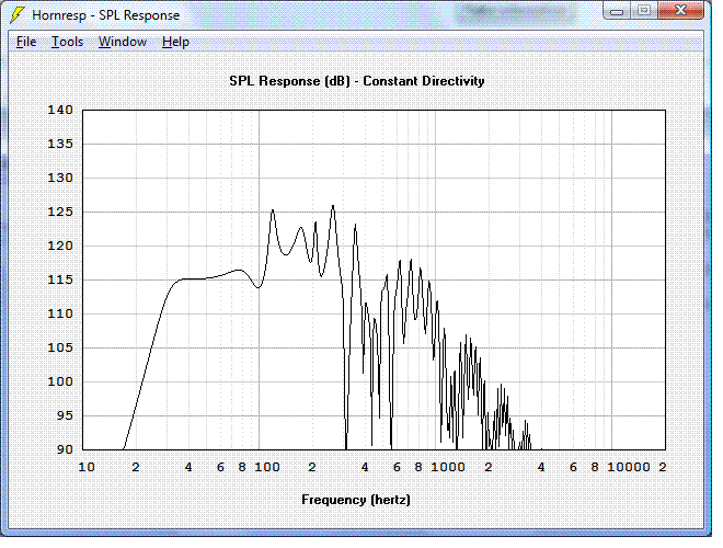

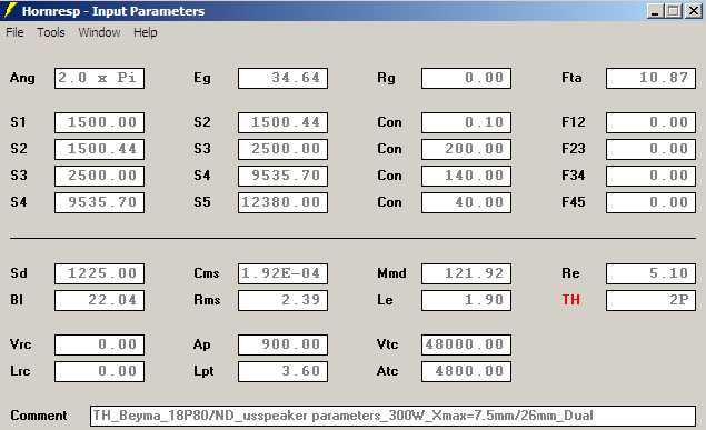

Hi. I need some advice. And probably help.
We need to fill a 25x15x5m hall with bass. I don't thing there is need for extreme output but a little headroom is good.
This will be a permanent installation and two TH will be fitted on the long side wall right above the tops. So size is not that important as long as it don't stick out of the wall too much. Around 80cm is the limit I think but smaller is better. I'm not sure about height yet but it should be enough for a single fold. 170-200cm should fit. Width is no limit other then sensible and material.
I have a really good deal on Beyma drives. 18G40 and 18P80Nd but I can probably get good price on other models if I ask nicely.
15" is an option but is it enough with two?
40Hz as low extension is a requirement. I don't thing we will need to go lower. And as high as possible up in frequency. 100Hz will probably be fine i hope. The tops are not of highest quality and they lack any punch at all, thus the bass requirement. Any TH will probably outdo then in SPL but it't good to have headroom if they are upgraded.
I have already simulated a TH and built it for home use. Worked fine.
But I don't have any experience when it comes to live sound. I don't even know how many dB is needed.
I will hopefully have access to real carpenters(?) to help out with the build.
The hall will be used for aerobics and that sort of stuff. And probably some more. So no concert levels but I hope there will be some headroom.
