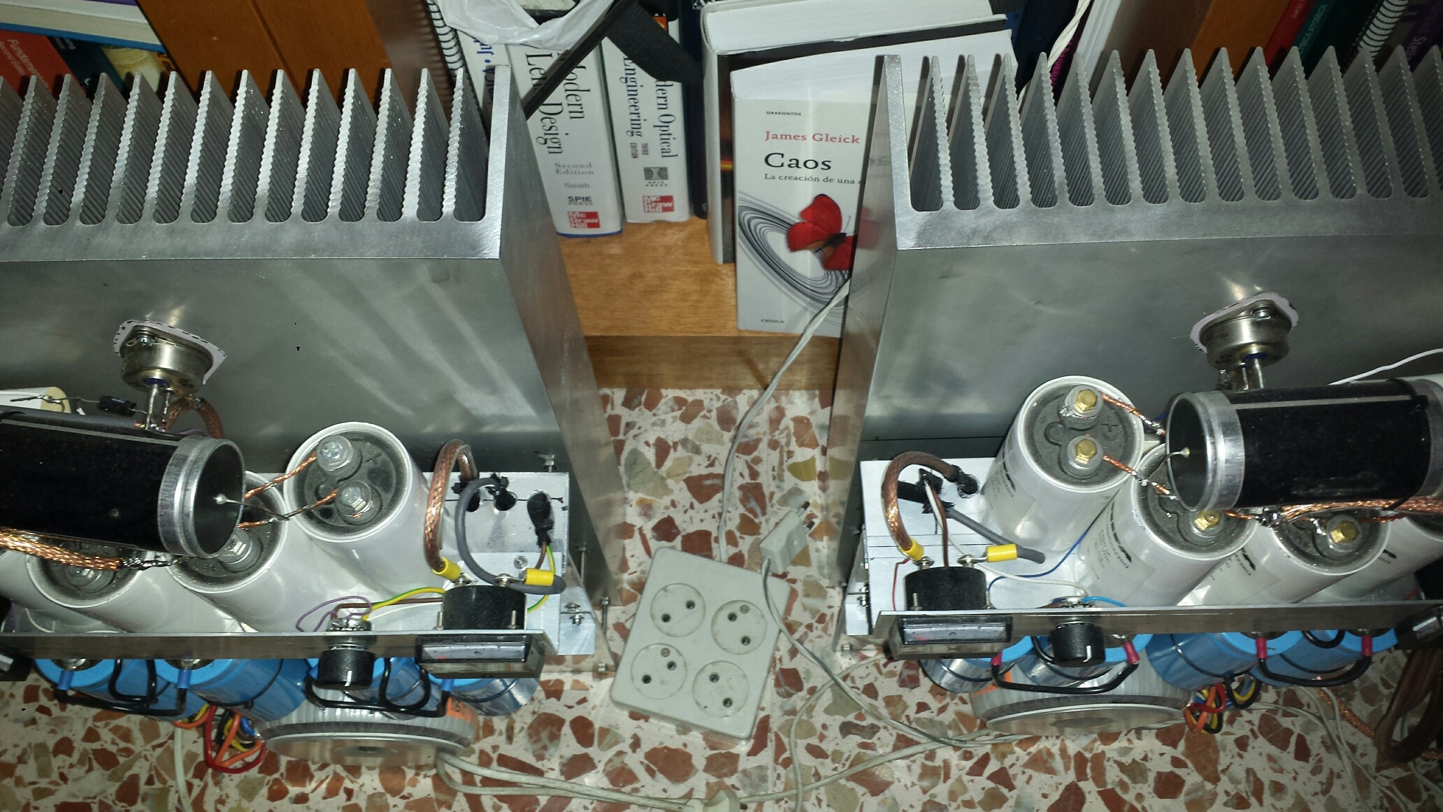

Thanks Michael, I read the same in the LuminAria thread also, so I tried
two SK180 for Tim !

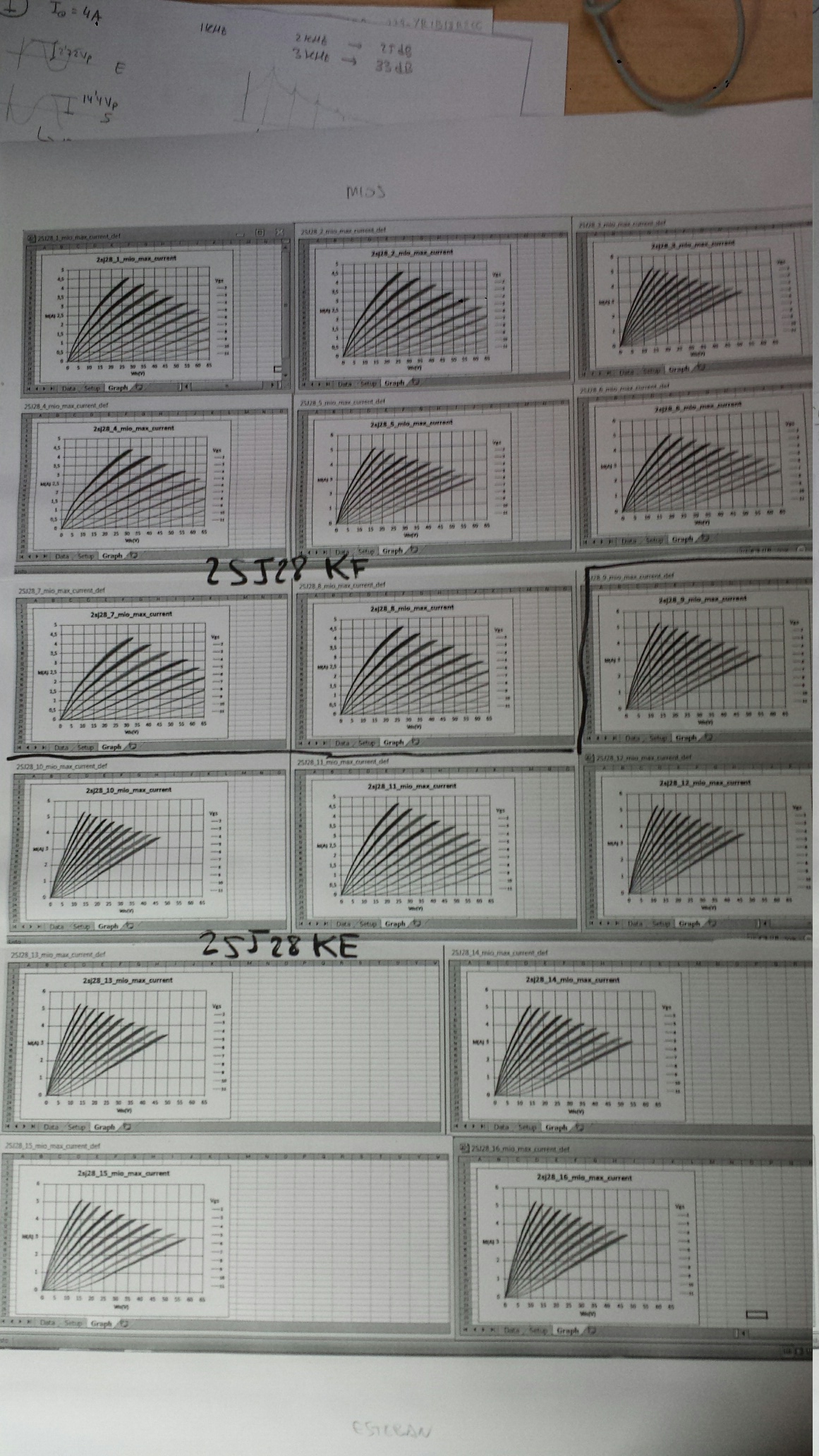

On the other hand, I have measure all 2SJ28 I own (8 KF and 8 KE and a few of dady too). They are very similar. I can group them into two great groups (mixing KF and KE types). This is not possible with tokins. They are very different between them. I hope can do it same with 2sk82.

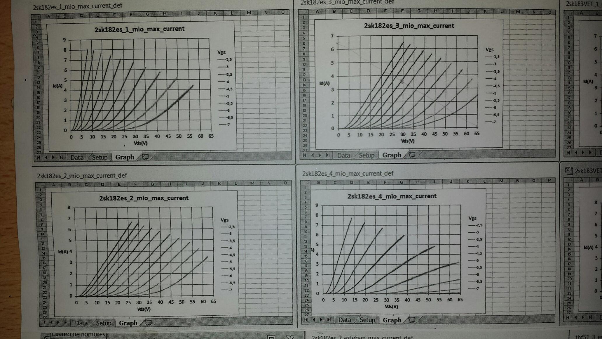

2SK180 is approaching unobtainium even in China, 2SK182ES is far easier to get, but only used ones.

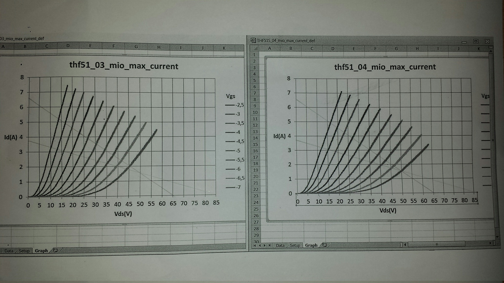

Other option is thf51. There are a lot in China. There is a drawback: its 5000pF. But I have two mounts and for me sound wonderful. Its highs are perfect for me. It is true that I use pre with very low output impedance and very high sensibility speaker (AER MK1).
