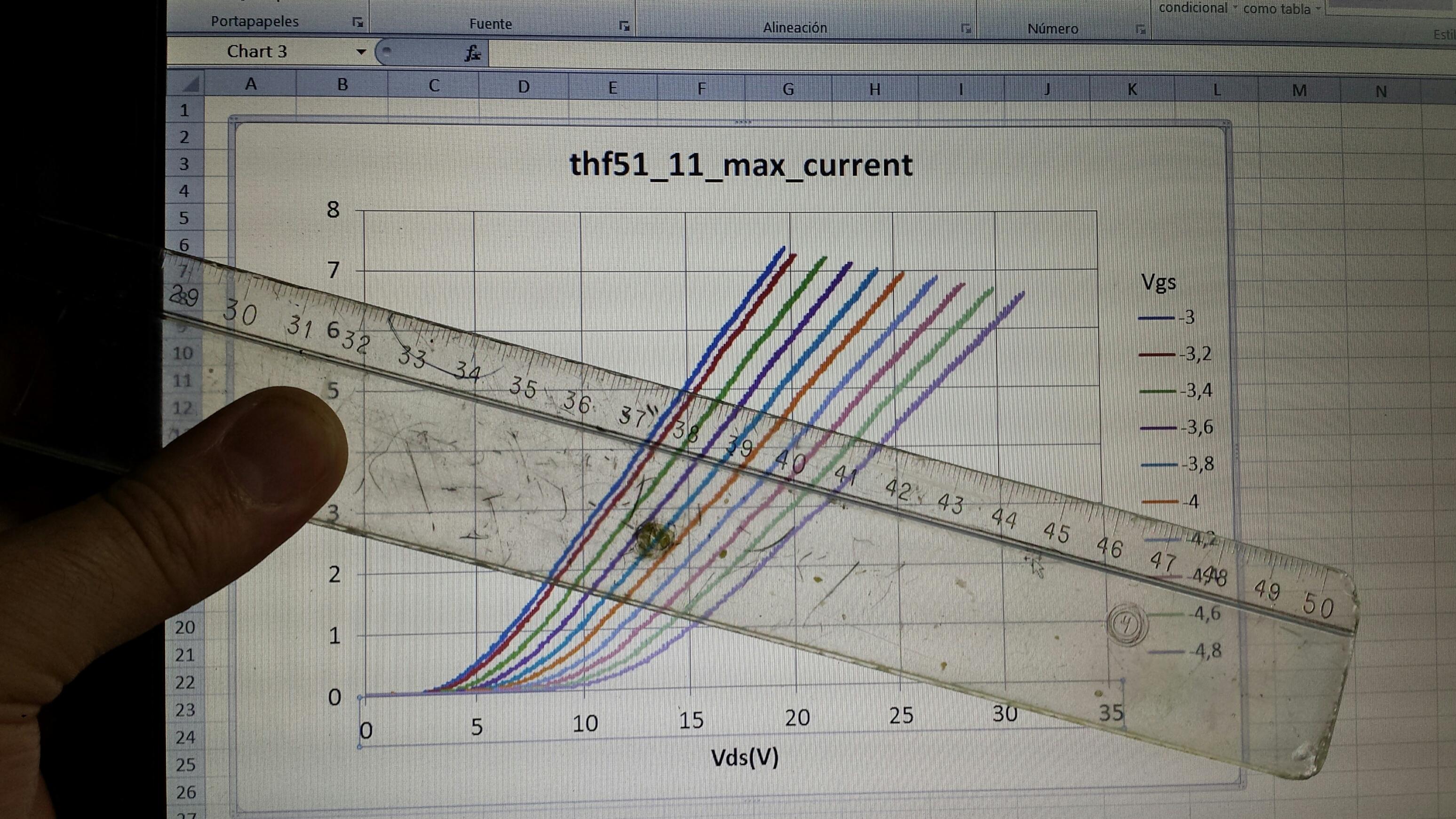

Also, my test with 2SK76 turned out to be not very successful, gain was only 7dB which was expectantly low, but lowest THD @1W I could reach was 0.4% and not any better than the 182ES, and my function generator's 5Vpp max output was not sufficient to drive it to give 10W so didn't measure THD @10W.
However, I finally settled with a 2SK180, at Vbias of -6.7V, Id of 2.4A and B+ of 45V, THD @1W was 0.4% and THD @10W was 1.1% 😀, with 15dB gain. Only issue was the heatsink used was not big enough to dissipate the heat, so I had to use a cooling fan, but I can get a bigger heatsink later.

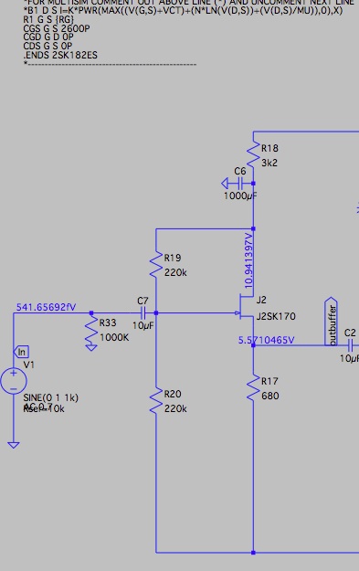

I suppose my buffer is nonsense
http://www.diyaudio.com/forums/pass-labs/269379-live-lab-hangout-1-1-posted-49.html#post4333346
no headroom…... Voltage at source of the J-Fet too low.
I will check with Spice and reissue….. :-(

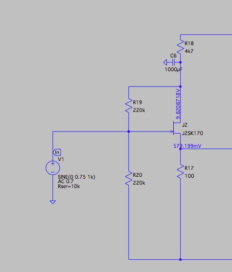

adding the 10uF cap at the input where it should be….
makes Vsource around half of the Vdrain.
but distortion is a bit high, I will go on and report…
of course all is still Spice now…..
and I could also use Mikes buffer from Luminaria but the voltage is much higher so ……..I´ll have to look...
A good 'ol B1 will swing 4 or 5V, I believe, and has an output impedance something like 50 ohms. 🙂
