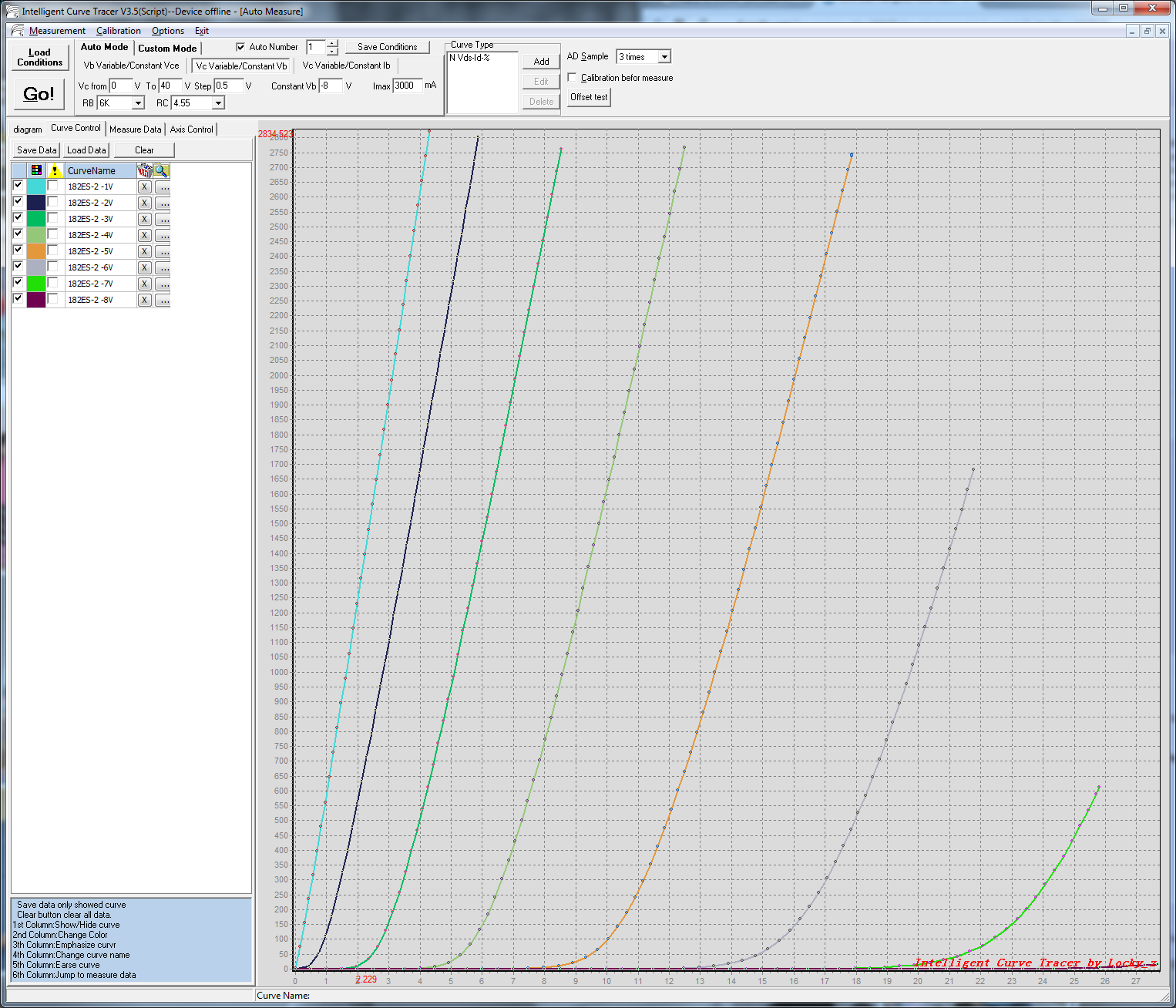

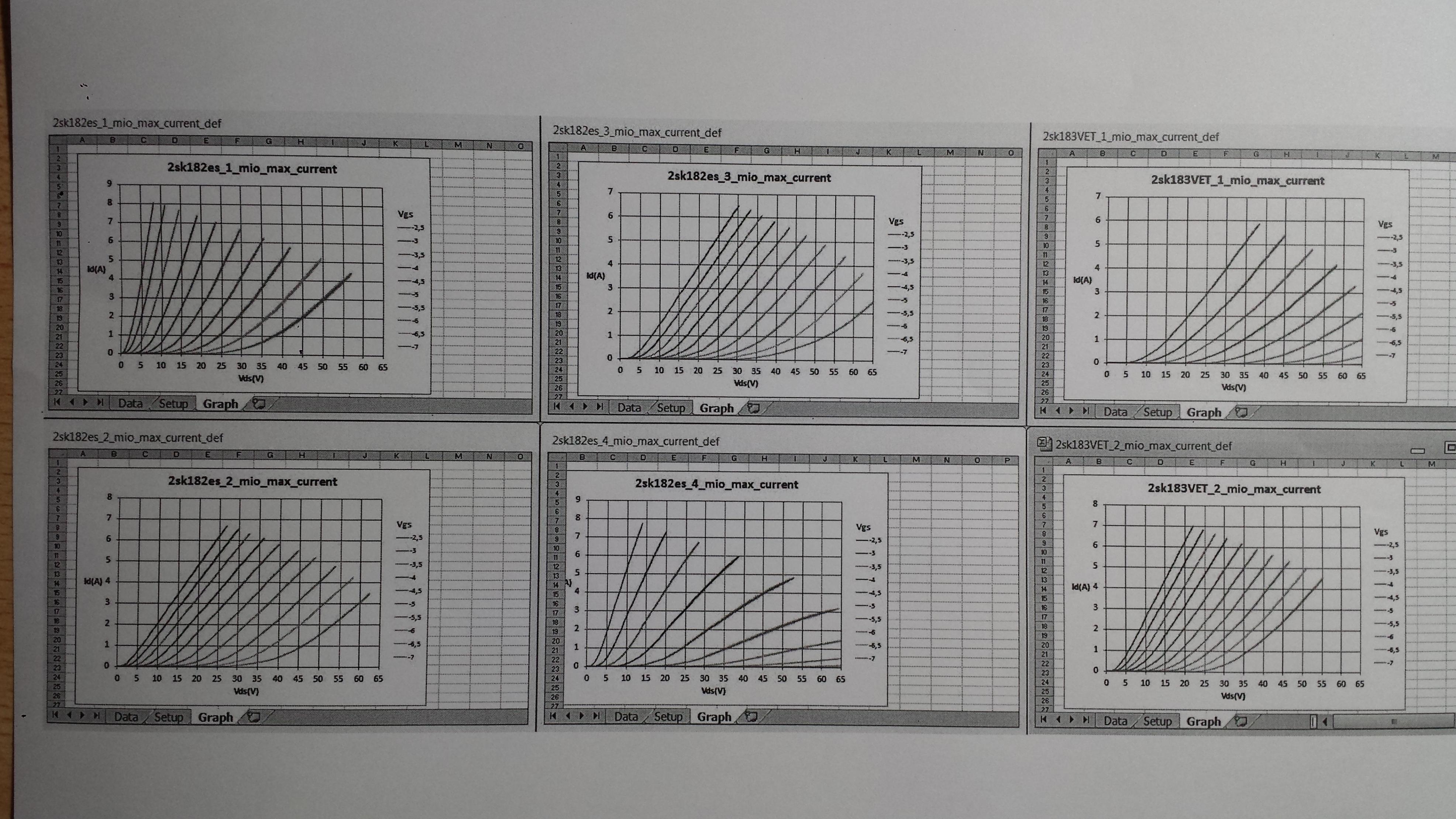

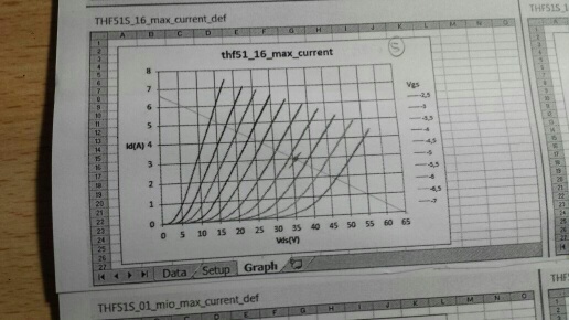

Hello all. Using upgrade curve tracer of Michael I have measure all THF51 I own (a lot of dady and some mine) and some 2sk182es (thanks Tim) near operation point (3 or 4 A). I have found there is a lot of variablility between them. I printed all curves and selected pairs. From these pairs I have used one for mount in resistor loaded amp. Well, using spectrum analyzer I have get this pair have 0.8% of THD at 1Wrms and 8ohm load. And both channels working similarly.
But I have select a pair between a lot, using its curves near real operation point. And curves shown all devices not working similarly, and with some we can reach 10Wrms with lower THD, but this it is not possible with others (lines are not equally spaced and parallel).
All of us have some pieces, but it is possible not have good pairs.
It might be a good idea share devices and search good pairs for all of us.
Any comment?

Hi jama. That's quite an effort 🙂
What is you drain load? 9 Ohms? Have you chosen such a low value for a particular reason? Is 3 or 4A an arbitrary choice? It may help to have some discussion about your operating point and design goals.
Hello Michael. Drain resistor is 10ohm. This is the value of resistor I found (600watt). And 3 or 4 Amp was values found by try and error before could see the real curves for more or less 10w rms with 8ohm.
Ok, so those values are somewhat arbitrary.
I think you will want to try some other operating points and drain loads e.g. see load line video. This may necessitate a higher B+.
Thanks for sharing with us. 🙂
Limits were power supply. I have only 50Vac and 450VA trafo, and caps of 75Vdc. But, yes, I will try other points.
Thank to you...
Thank to you...
Yes, I had the same constraint when I started experimenting with the bigger parts, so I can certainly relate. 🙂
I mention it only because I think you might be able to achieve similar power with lower distortion and cooler parts.

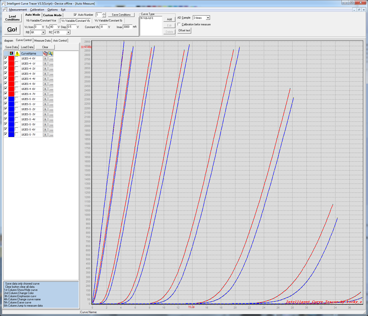

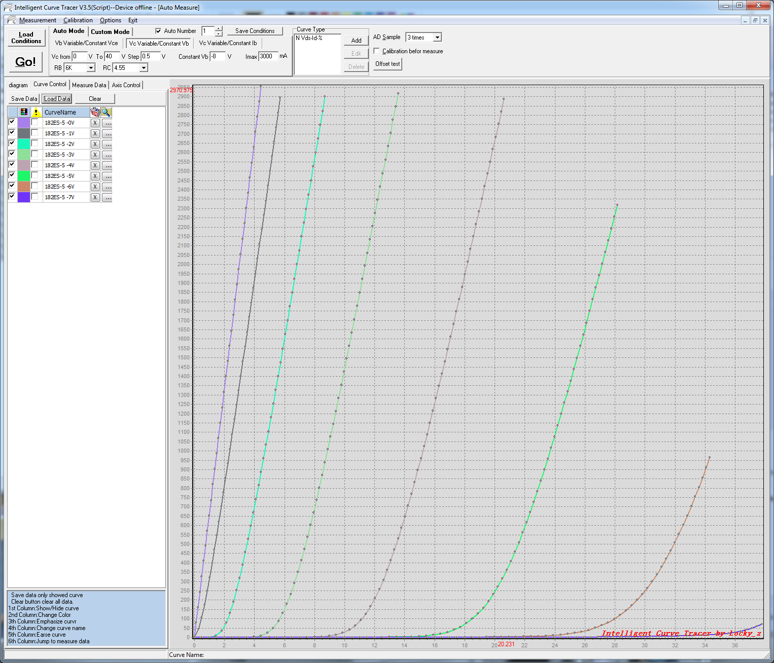

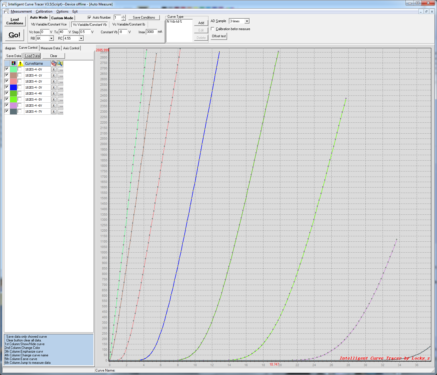

Sharing and swapping is a good idea. I don't have THF-51S, but I have 3 pieces of 2SK182ES that are available for swapping, with their curves attached. As I've decided that for my target power level, 2SK180 is more suitable for me, so if anyone having spare 2SK180s is interested in a swap, kindly send me a PM.
BTW, two of these 182ES are matching particularly well (see the last graph).
It's easy to get excited by the curves and such. I have ended up testing the
parts in the target circuit, adjusting only the Vds against distortion at a given
wattage (1 watt usually). I also note gain, Vgs, noise, Vds and gate current.
Assuming that Vds and Vgs aren't out of bounds and that the Gate current
and noise are sufficiently low, they are then matched by Gain.
The result is very consistent matching of performance, that is to say the
distortion curves are very similar.
As I said, the adjustment parameter is Vgs for a target distortion number.
