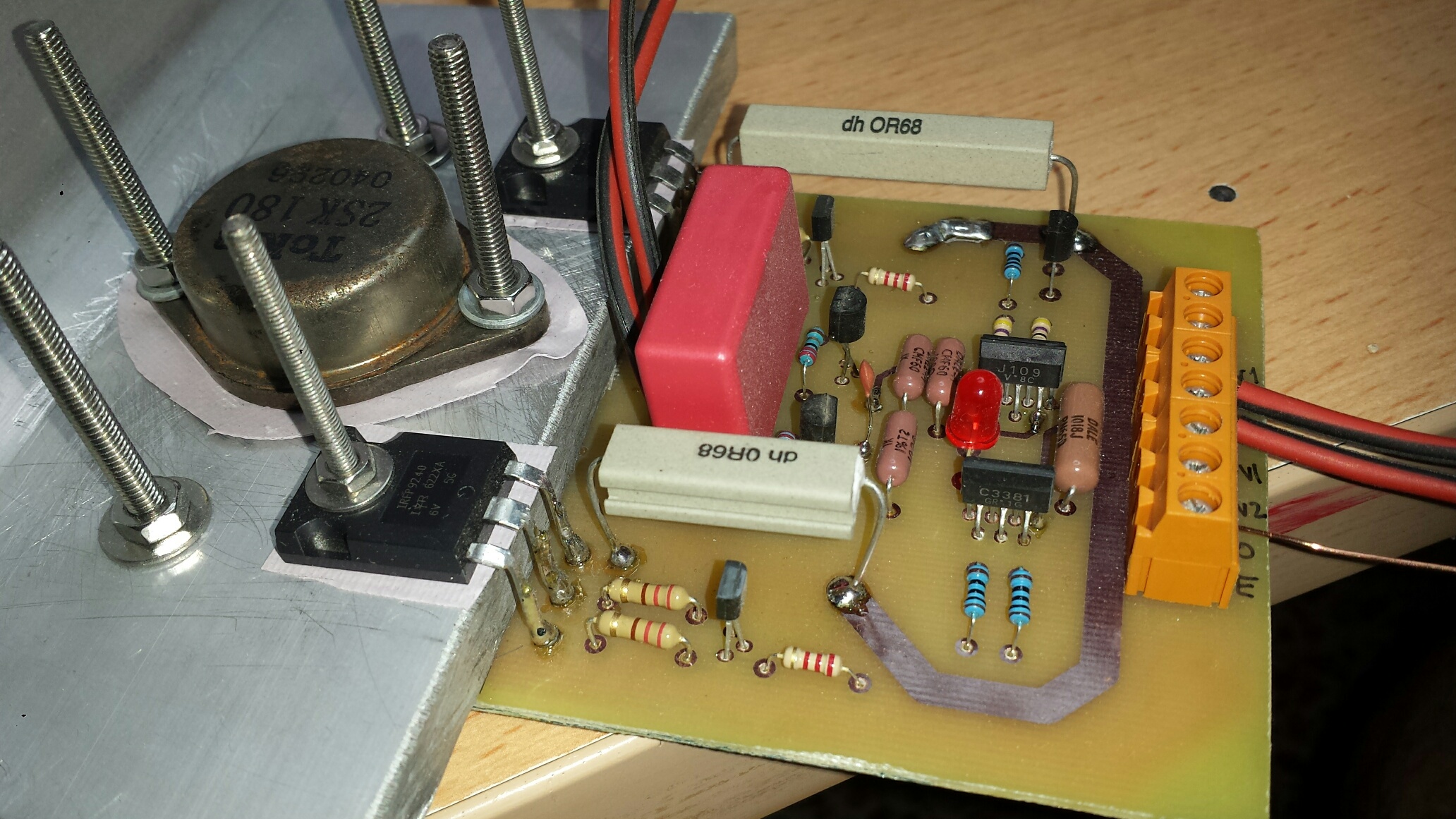

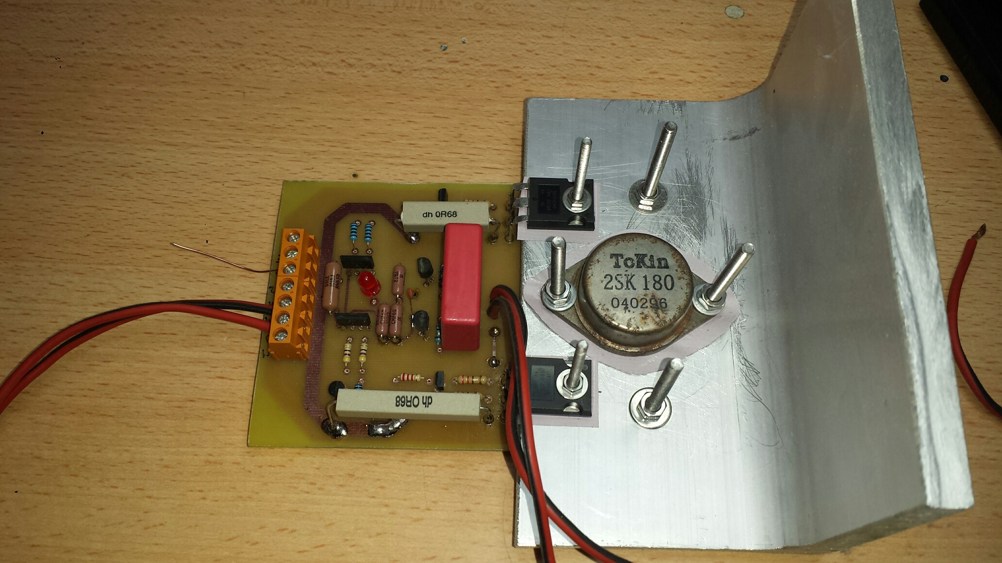

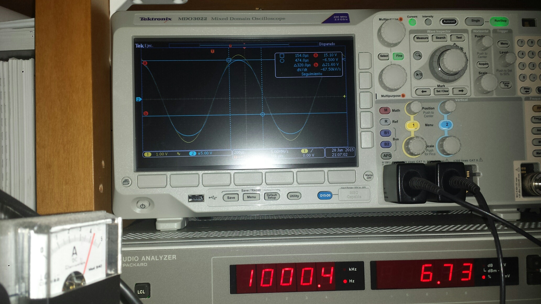

Ah, sorry, I have not look this manual. I will do it. Well, with this tool (it is old but this equipment works very well) I can try a lot of things measuring what happen. The first, as Michael said me, is try with more PS voltage, around 84V and other quiescent point, around 2A (I have get two 400VA 60V trafos and 8 22000uF/100V). Second, use 2SK180 instead THF51. But always comparing with a good system. Fun has just started...
Another way will be evolve circuit...

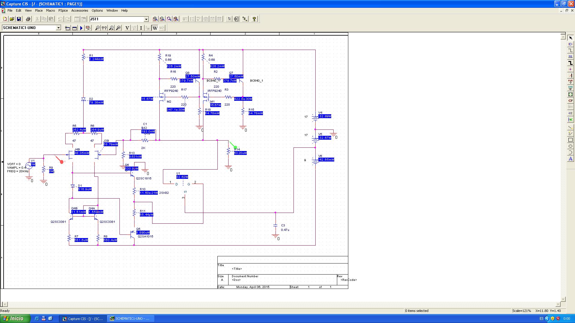

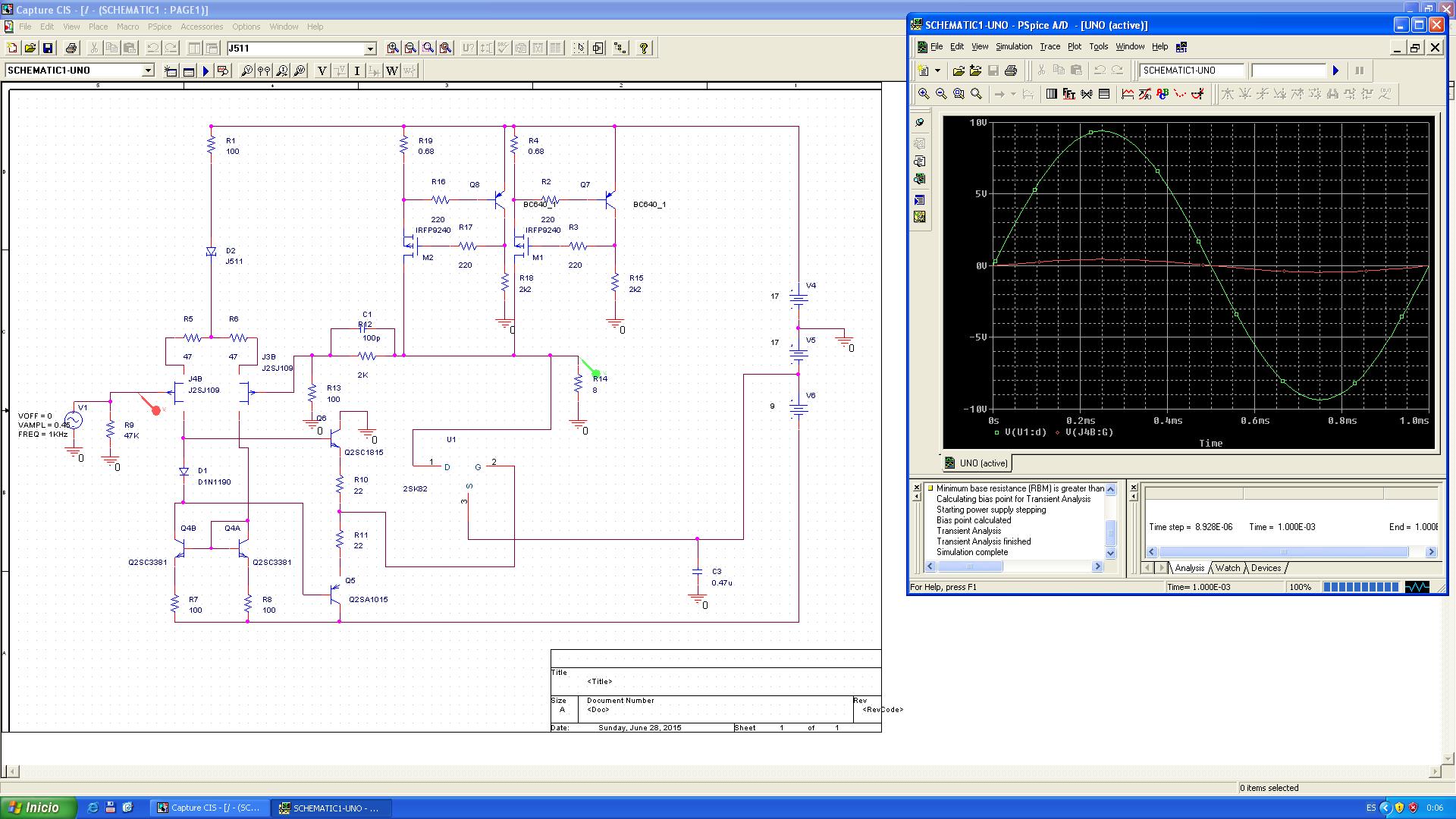

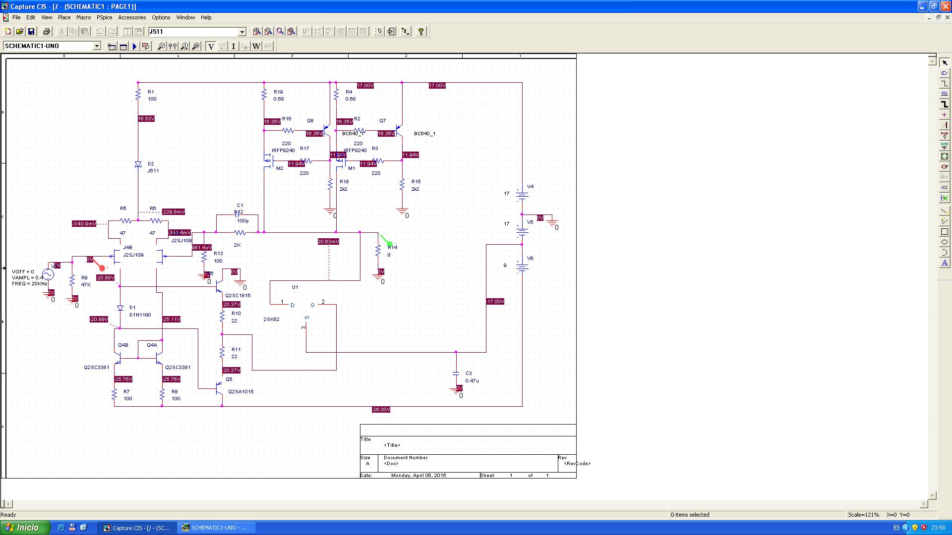

Before doing evolve circuit, I simulated it with Pspice. I could not use 2sk180 model (I tried it but I could not did it without errors). Then I used 2sk82 model from Michael, just to see if works. The first with schematic and input and output signals.

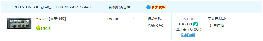

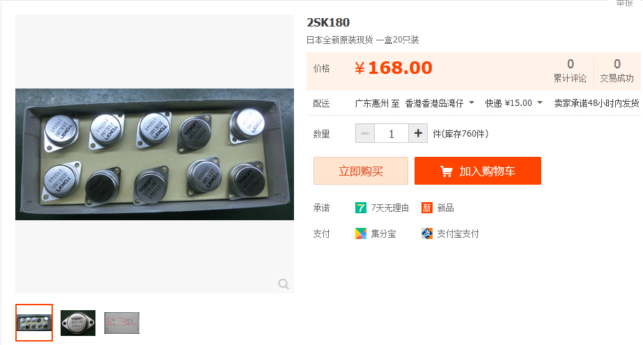

... 2SK180 is approaching unobtainium even in China ...
It seems situation has changed lately. Out of nowhere, someone setup a brand new TB Store (sort of e-Bay shop but in China), and has hundreds of NOS 2SK180 from Japan available, as well as NOS 2SK182ES and THS-51.
I'm hesitant to order anything from him though, it's always a risk to buy things from a new online shop. Also, the serial number (1Y....) of the 2SK180s are remarkably close to those from eyelabo (1Z....) before and they might be from the same source.

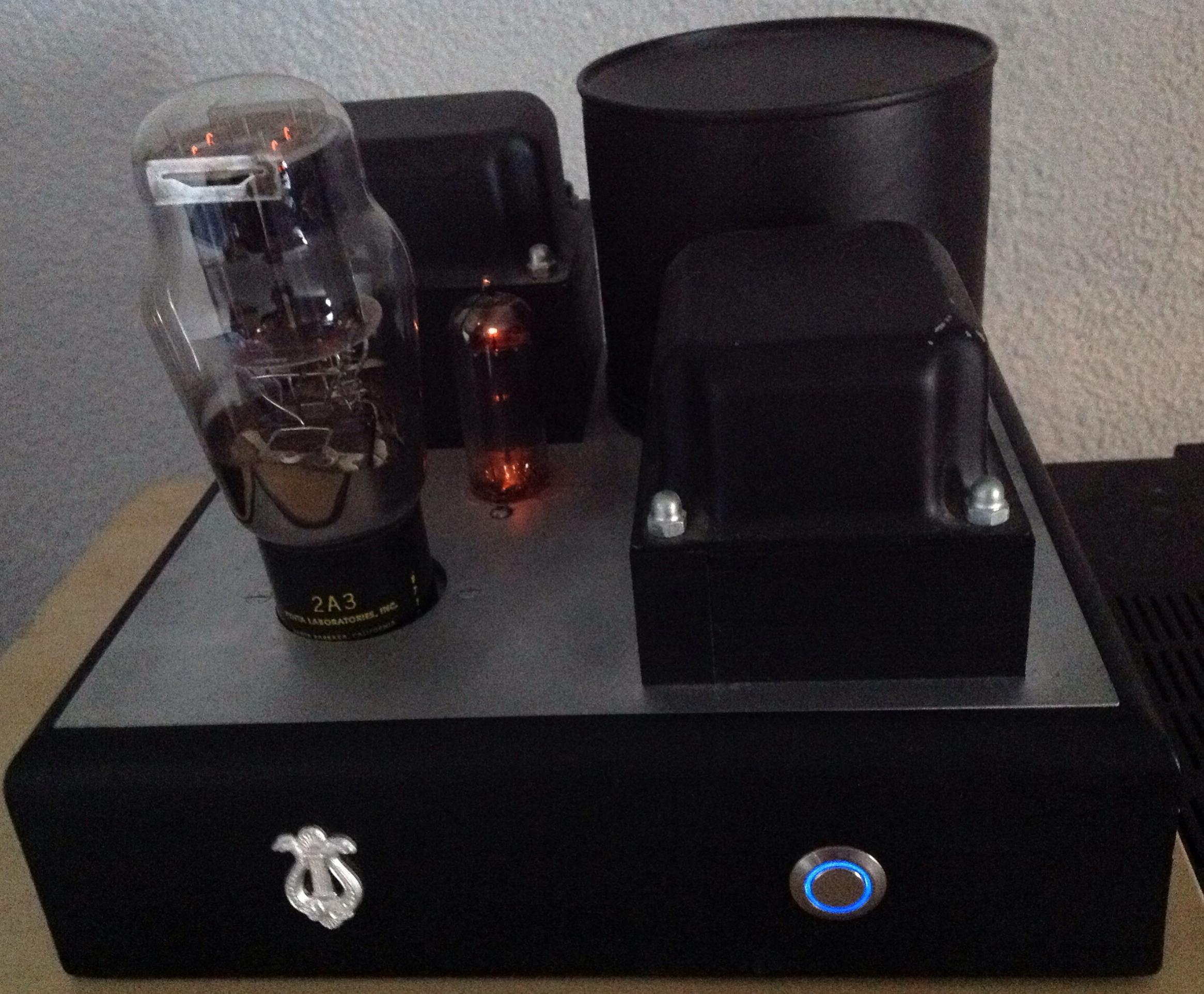

Little set 2A3 triode 3 watt's amp run last days for better know how different
music emotions feel if compare to future sit's amp.
Work in progress 😉

AMAZING WORK BRAVO :up:🙂

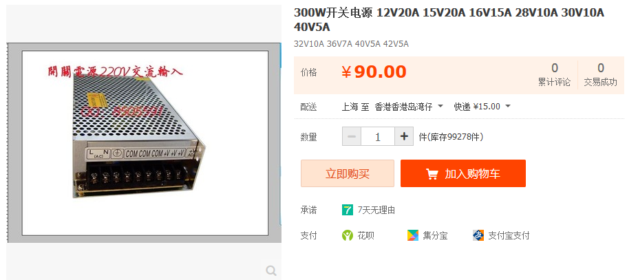

...Btw 40 V smps psu for Locky_Z curve tracer what link to buy good one ?...
I use something like the attached one, when I examined it with a scope, it has some tens of mV of typical switching noise, but it's good enough for the locky tracer.
If you can't find one in your local electronic store or e-Bay, I have a spare one where I can sell you at EUR10 (plus shipping). Issue is that shipping cost to Europe is probably 3 times the cost of the power supply. PM me if you're interested.
