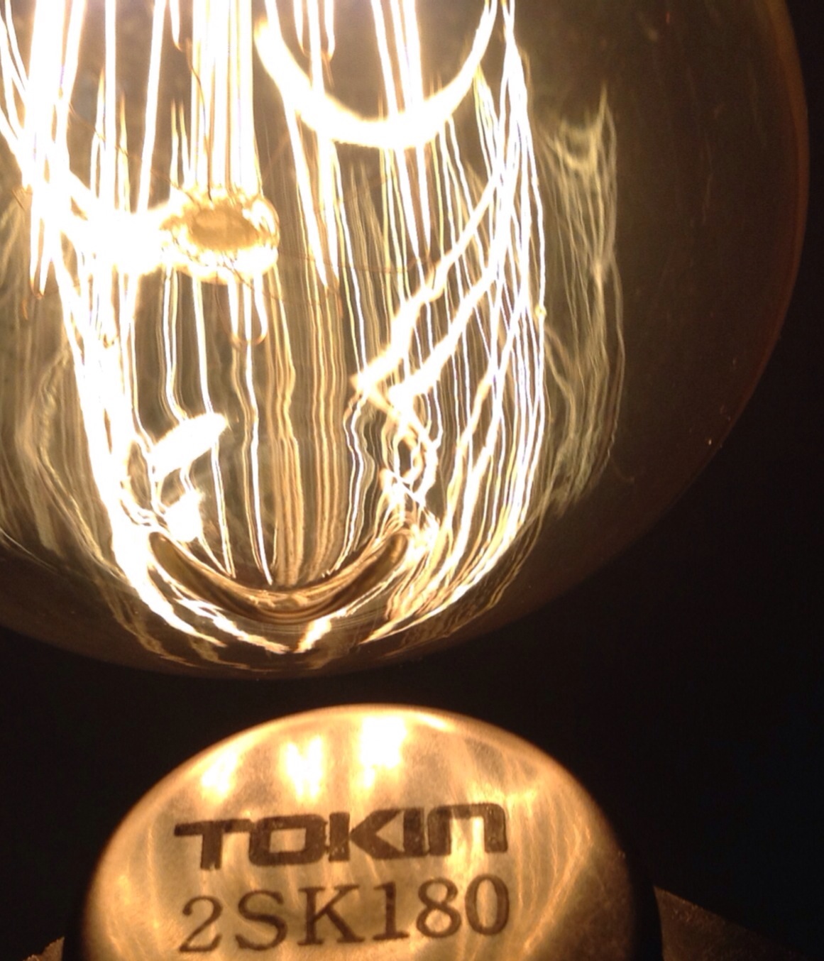

I have gone through 15 2SK182ES from Taobao, I think they're all authentic, but the failure rate was 40% (6 out of 15 were bad).
I also notice that the refurbished ones (rust removed and electroplated to look nice and shiny) are more prone to failure, probably the refurbishing process could damage the SITs.
Don't waste the bad units, you can use them like CCS in a SE like the A3 with monster Vfet.

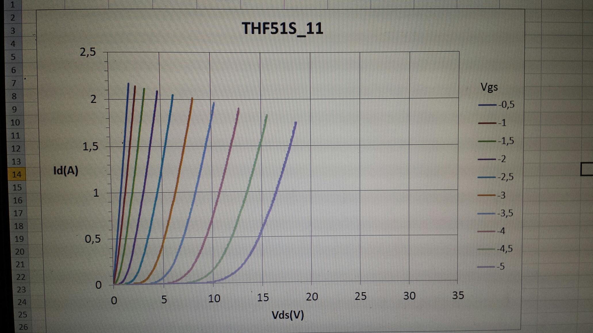

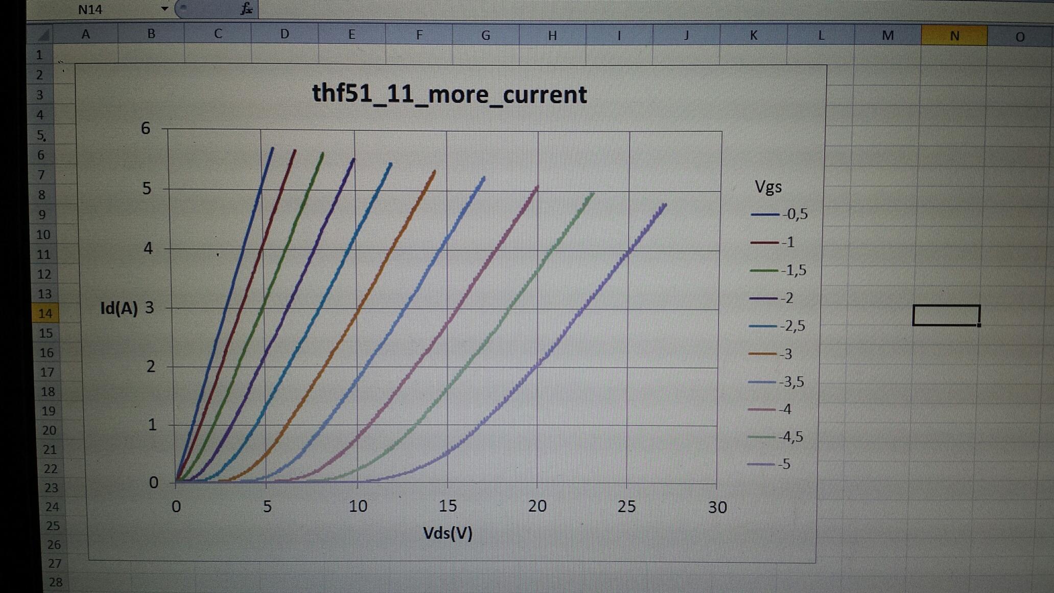

First THANKS DADY for be first who bring us THF -51 sit diamonds
and thanks to Jama , Cwtim01, Generg for all precious informations with sit's curves and distortion graph's.

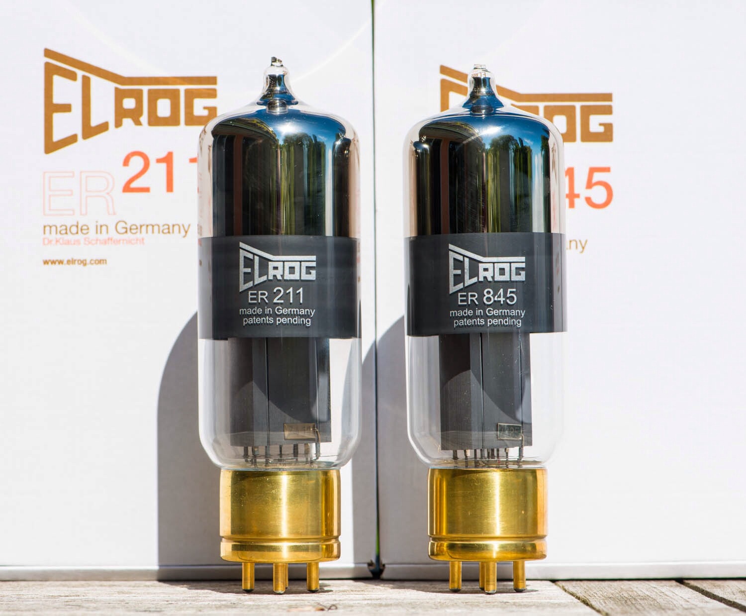

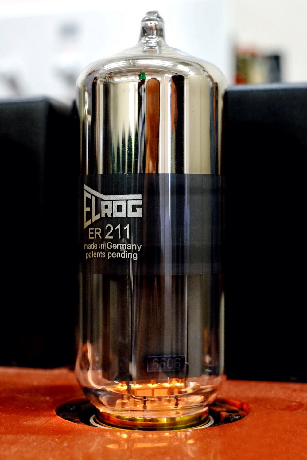

So if Sony 2SK82 vfet are " equivalent " of 300B vacuum triode
, Tokin 2SK 180/182 ES or THF-51 look like biger triodes 211/845.
Tube guys use them for 20 watts output in SE amplification and low end frequency is much better & realistic. I guess sit's can do similar score probably more always in output transformer less topology
because they are 300/500 watts disipation parts ?
Scope curves photo are 211 triode ones.
http://www.tubeampdoctor.com/images/File/ER-211 Datasheet.pdf
Greetings
Christophe

HEHE, 211 give us 30watt or more in class A2, Tubelab got 45. All this with 75 watt maximorum of dissipation in plate.
This is not possible with vfet, the curves are magnificent in some of them but no gate current neither class A2 or other supra regimen of work, I know, I know that the problem is the transformer. But there are good. I know, they have limited live but I had to replace my lowthers DX4 after 9 years because the paper cones was fatiguing. No HV with vfet but for 10 watt you have to waste 200.

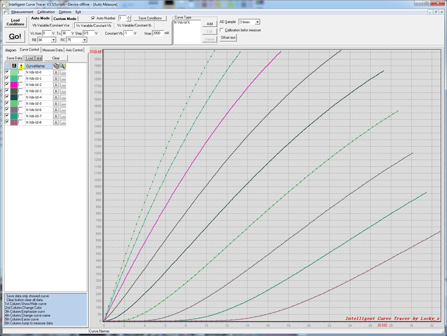

I read Michael's L'Amp part 2 article again, and the THD @1W was around 0.1% and @10W was around 1.5%, using 2SK82.

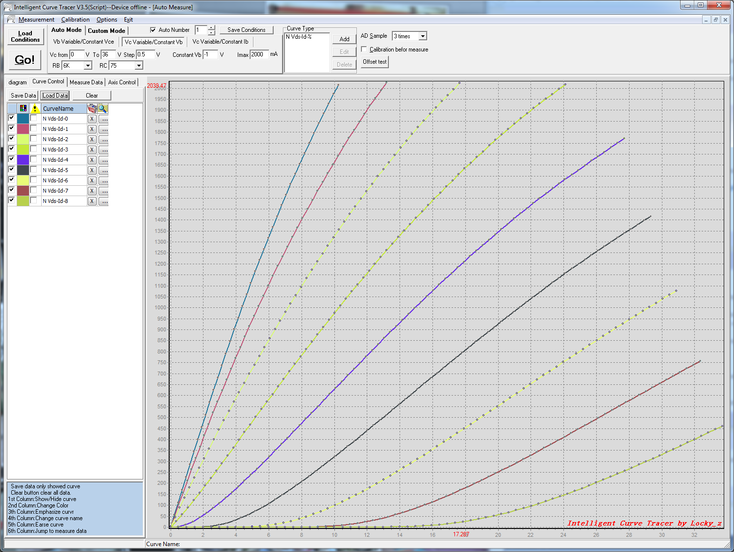

With my 10W target, probably 2SK182ES is an overkill, so I'll try these little Yamahas - their curves look nicely linear, and I'll see how it goes 🙂

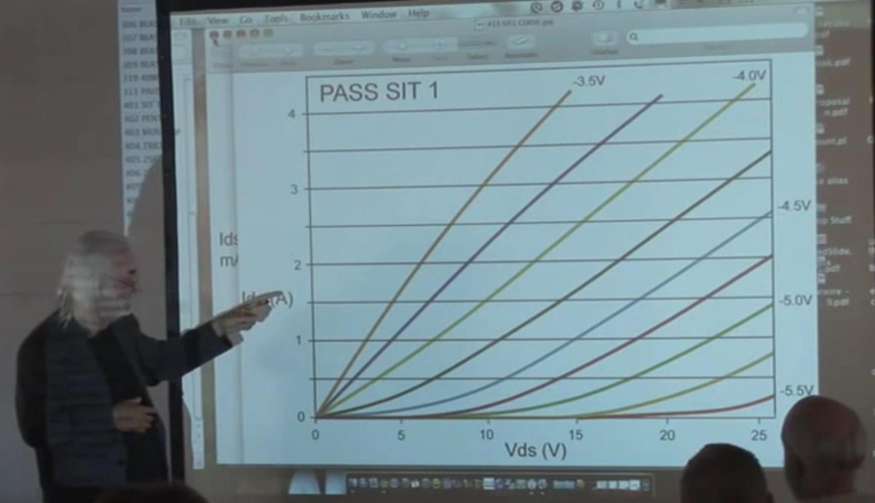

Yours Yamaha curves make me thinking about Mr. Pass Sit -2
CCS topology amplifier, possibly interesting way to try
build wonder with big Tokin's or Yamaha's

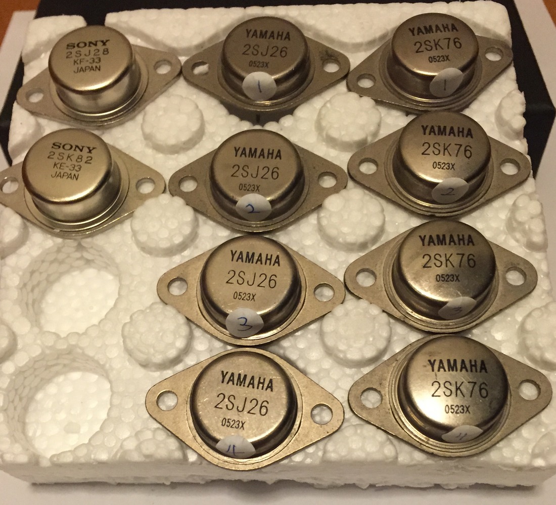

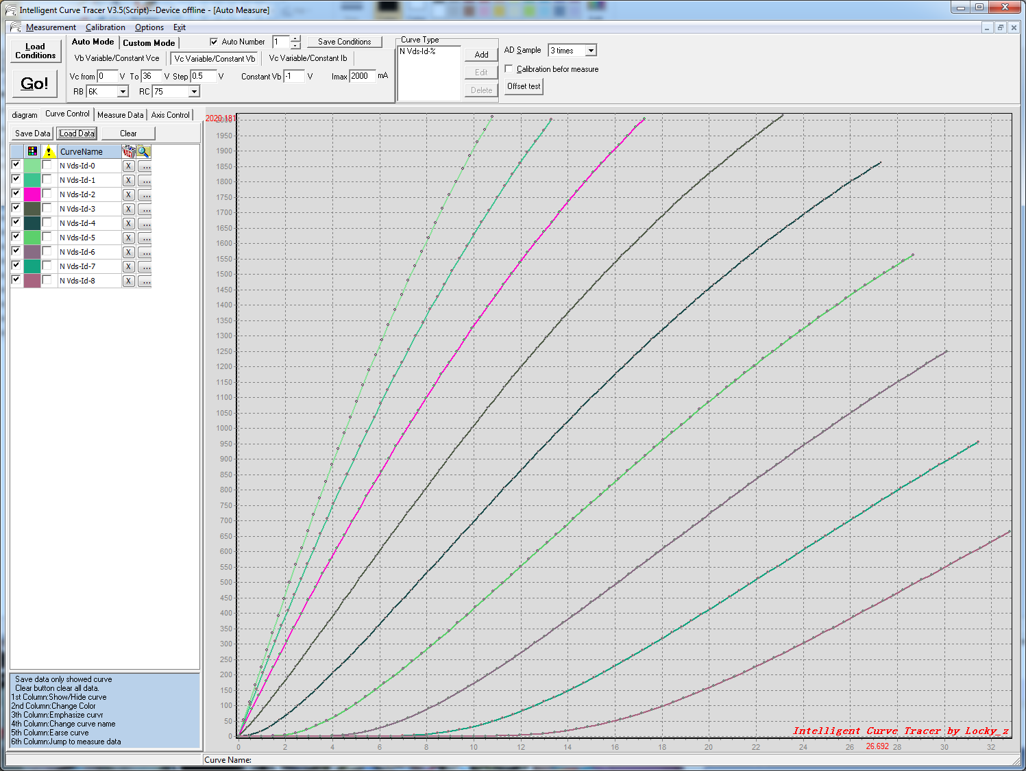

While the 2SK76 seems quite linear, it has much higher Rd and lower Gm, so it can't quite compare with the PASS part I believe (otherwise I might buy them all up from the seller 🙄)
BTW, the curves are in 1V steps, from Vgs values of 0 to -8V.

Sorry, I forgot to check on this last night, but my recollection is that they were very similar to the Sony performance-wise. I only have one pair tho.

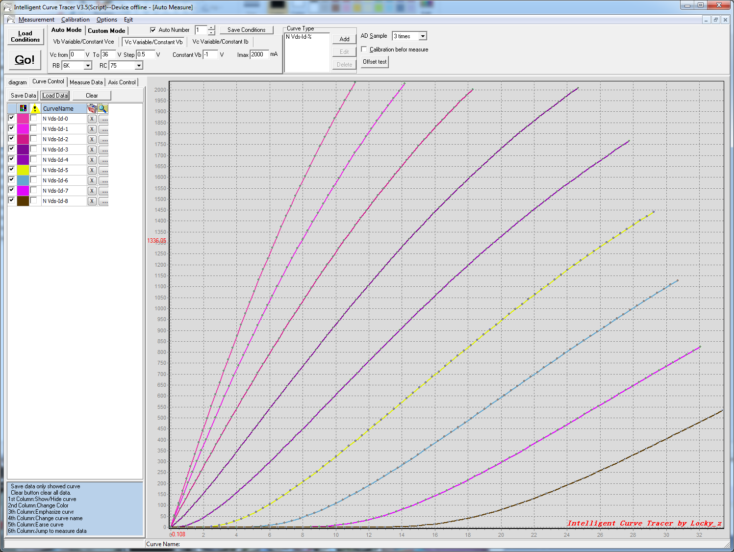

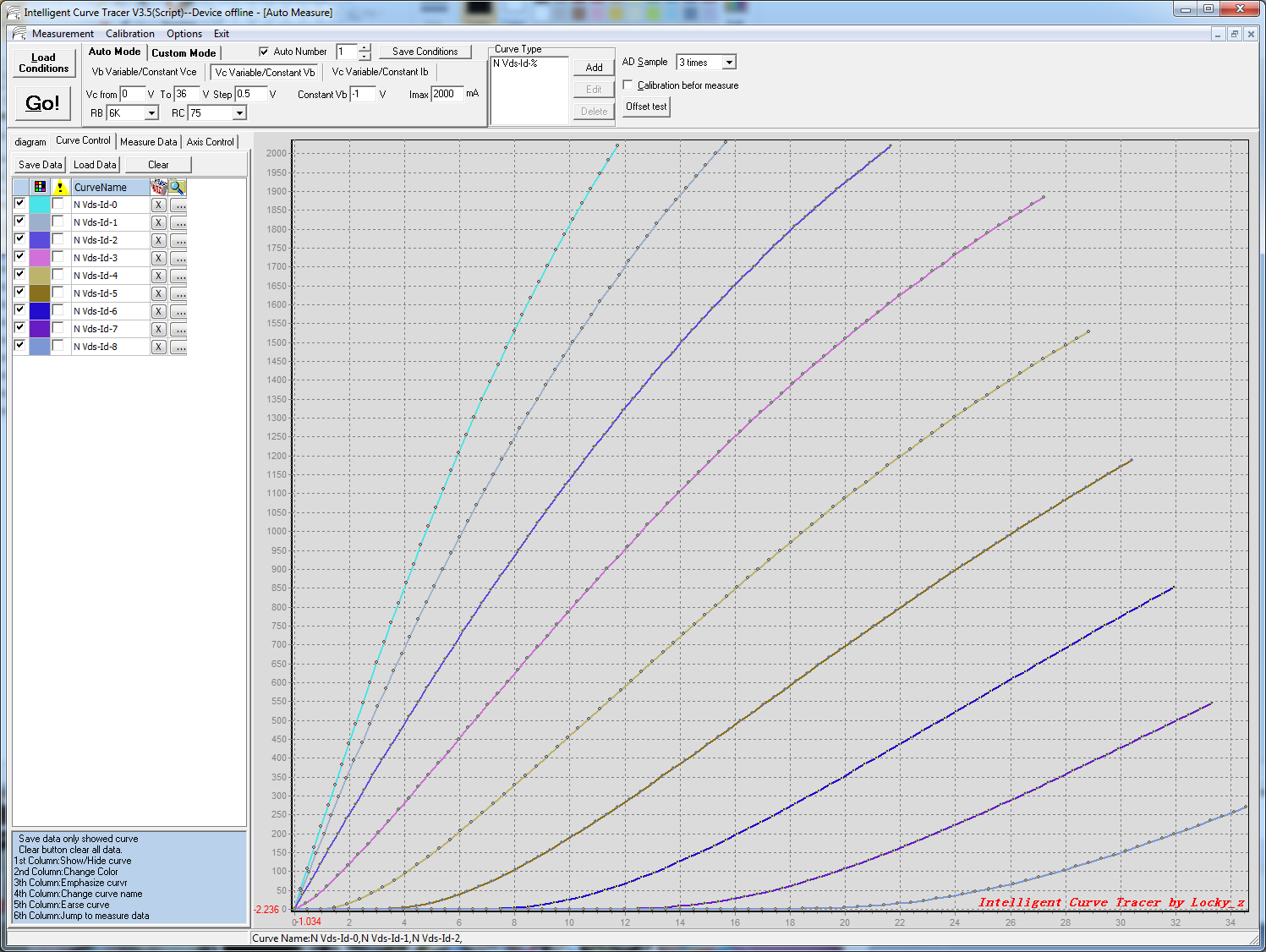

Thanks Michael, I compared the curves of my 2SK82s and 2SK76s and they're indeed quite similar, the 2SK82s have slightly more gm while the curves for the 2SK76s are slightly straighter.
I'll test the 2SK76 setup in the coming weekend, to see if I can reach the same level of performance mentioned in your article.
Tracer grow up....and select them using approximate load line...
