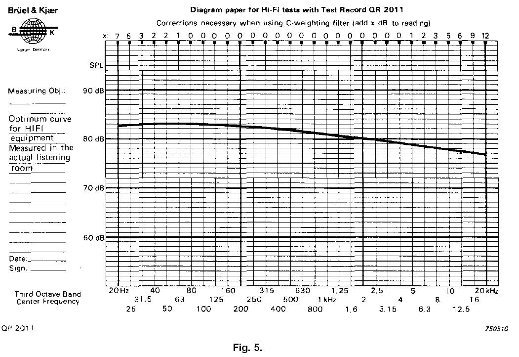

By using the old B&K falling response. It's been posted a few times and is easy to find around the web. I use it, I think Geddes uses something close. It does seem to work well in most domestic rooms.
I'm not sure why it sounds right, unless the mastering engineers are using it, too.
If there's no theoretical justification then the B&K curve exists because someone, somewhere, decided it "sounds" right. And you agree. But there we go again . . . with "objective" measurements referenced to a "subjective" standard. …
http://www.bksv.com/doc/17-197.pdf
Quote from page 4 :
When music is recorded under far-field conditions, it will contain a suitable mixture of direct and reflected sound, and the curve ought to be absolutely flat in that case. This is true for recordings, for instance, made with two B &K condenser microphones in the far-field.
However, since most recordings are made as a combination of near-field and far-field information, the curve should boost a little at low frequencies and roll off a little at high frequencies. A suitably shaped curve is shown in Fig.5.
The curve shows only the necessary tendencies. This curve was derived partly as a result of listening tests and partly by consideration of curves from average concert halls.
According to Beranek (Ref. 2) the average concert hall has a roll off similar to that in the curve shown, but at twice the rate. Only half the rate is chosen because most recordings are equally distributed between near-field and far-field recording.
Practice has shown that this characteristic is absolutely reasonable for reproduction of most commercial recordings.

I have to agree with all of this since all of my mixing rooms have this curve thanks to Bob Hodas advice, and his calibration skill. My own personal hometheaters and multichannel music rooms also have this same curve.
Yes, and if one spends a bit of time on Audiolense, Acourate, or DRC forums, this curve is consistent with many folks experiences regardless of type of speaker or room.
For example, Bob Katz uses Lipinski L-707 and stereo JL Audio Fathom f112 subs, which are clearly different from my horns. Yet we both measure the same frequency response at the listening position, (i.e. the curve I posted earlier in the thread), even though the size and acoustic treatment of our rooms are different.
How do I know this? Look on the Audiolense forum links I provided earlier as most users post their curves. With DRC, one can draw any target FR curve one likes, which begs the question, what should the curve look like? Most find out quickly that "flat" at the listening position is not the desired response. Sean Olive's study on The Subjective and Objective Evaluation of Room Correction Products also comes to this conclusion.
Most folks end up having a very similar curve to the one I posted earlier, which is also similar to the B&K curve from 1974.

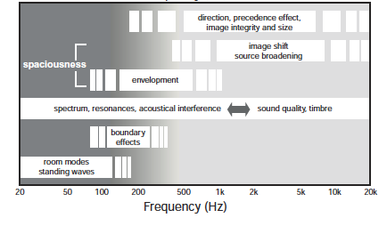

This is fig. 5.2 from Toole's book. At least for any spatial issues it suggests less importance of the range below 500 Hz imho.

Can there be any doubt that out accuity to reflections and frequency response variations has to decrease as the frequency falls? In what way could our hearing surpass the limitations that all physical systems have as the frequency of the signal falls. It is true in radar, sonar; every field of physics where resolution, especially spatial, is a consideration. How could the ear be different? Based on everything that I know it is not. If you have other information that refutes this belief then I would love to see it - as would a whole lot of other people.
And I am not saying that our resolution goes away, it simply cannot be as accute at 200 Hz as it is at 2000 Hz - the physics simply says that has to be true. The physics does not say that our hear IS more accuate at 2K, of course, only that is is possible for it to be so. BUT, evolution says that our hearing would develop to the limits of its capability simply because better hearing accuity would be a tremendous evolutionary advantage. Likewise, it is no coincidence that our hearing threashold has developed down to the thermal limits of capability for a detector of its size - if we could detect any lower in SPL then all we would hear is thermal noise at those level - nothing external to our actual ears. Some people (if they are very young) can actually hear this thermal noise in excessively quite environments like an anechoic chamber.
Now if we accept the above to be true then it goes without saying that a reflection at 200 Hz will not disturb our imaging resolution as much as the same reflection at 2 kHz - hence the "importance" of directivity control at 200 Hz canot be as important as it is at 2 Khz. Everything that I know about hearing is consistant with this belief.
If you see a flaw in my logic or you have data that refutes it then I'd love to see it, but I am not about to go looking through my dozens of texts on the subject looking for specific bits of information that support my arguement - I would do that for a professional paper, and I may write one of those on this subject someday, but for a forum post a handwaving argument based on my knowledge of the subject matter is all I am willing to do.
