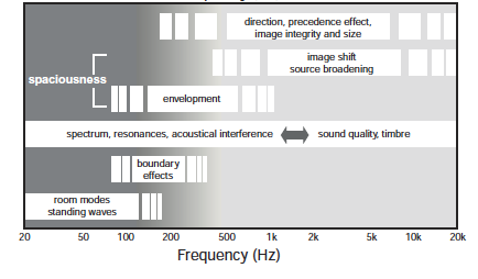

This is fig. 5.2 from Toole's book. At least for any spatial issues it suggests less importance of the range below 500 Hz imho.
That's from an introduction portion of his book. 😉
If you read the variety of tests and their conditions that "suggestion" is illusive at best.
In Toole's book there is this tendency to show that yes, this is what matters.. and upon further reading what "matters" is effectively whittled down into "largely unimportant" through gross demarcations in testing vs. our own context, and a string of caveats.
(..in fact most of the research from a variety of sources was synthetic, and often only conditions just one reflection.)
As far as the underlying matter: I'm not suggesting we can't *detect* reflections, but are we particularly sensitive to them under the context of stereo reproduction? (..and again, under the conditions you removed from my earlier post - basically conditioning on moving the loudspeakers away from walls beyond a meter.)

He shows the same on page 97. That must be a loooong introdution 😉That's from an introduction portion of his book. 😉
You need to steer me to the point in the book, where Toole revokes those diagrams.If you read the variety of tests and their conditions that "suggestion" is illusive at best.
Anyway, I wasn't going to support Earl in the first place, but simply showing that you can't count on Toole for support of your argument 🙂
Rudolf
It is in fact a very long introduction.. At it's on page 70, not 97. Page 97 has a different diagram that has similarities.
But the diagram on page 97 is a decent example of where the figure on page 70 is derived from. Page 97 concerns the field of acoustics - specifically real sources in differing sized "rooms". (..notably NOT stereo loudspeaker reproduction.)
On page 70 in reference to figure 5.2 (bottom of the page):
"Figure 5.2 includes repetition of 4.12, which illustrates that, in terms of physical acoustics, the frequency range is divided into two regions connected by a broad transition zone."
"physical acoustics" is specifically referencing the field of acoustics.
That's not to say that there isn't overlap into stereo loudspeaker reproduction, but it's not a "one-to-one" comparison. In fact more than a few acoustical terms get dragged into stereo reproduction that don't meet their own definitions and should not, nor ever were intended to, be used in that manner.

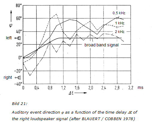

You still haven't looked into http://www.hauptmikrofon.de/theile/ON_THE_LOCALISATION_english.pdf ?
Markus had asked you ages ago to take a look. Now please at least read pages 51-53. I just show you this diagram from 1978 for starters:
Do you see how ITD perception can do without those low frequencies?
Rudolf

As stated in that paper if you are only talking about narrow band low frequencies localization is out of the question, but music is not narrow band. This is the problem with so much of this information it is taken out of context to a true musical source.
