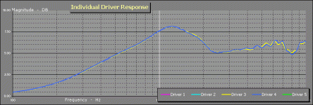

Yes, I would say that is absolutely wrong to call that "baffle step". Its much too high in frequency. It is correct to say that you "corrected" a bad crossover.
Hi Earl, no argument aboiut correcting a bad crossover the new one is far superior to my first effort (though the original one I was going to put in line level baffle step compensation).
I disagree though that it is not baffle step that I have compensated for.
The attached is the simulation I did of the baffle step of the drivers on the baffle before I made the speakers. The main component in the crossover for dealing with the baffle step was a notch filter at about 1.3Khz... I wanted a narrow baffle (this is 200mm). Some might say this is extreme, but I'm very pleased with the results. The actual crossover of course was made based on real measurements not the simulation.
Tony.
