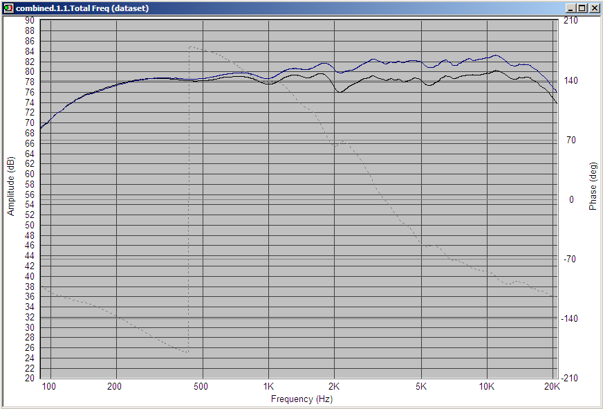

I myself when I did my mtm's started off with no baffle step compensation, in the end I re-did the crossover with quite a lot of baffle step compensation (though there is no traditional BS circuit).
You will see from the attached graph that the gated response is quite different, the revised crossover sounds much better than the original (original is the blue trace). The tradeoff was the drop in sensitivity. I was originally going to do line level BS compensation which would be a better option if the speakers were moved from room to room, but I decided I liked the result I got with the crossover implementation so have left it as is. These speakers would now no doubt sound unbalanced if I put them up against the wall.
So looking at the two graphs, am I wrong to say that the second (black trace) has baffle step compensation? and that it is a farce to say that the speaker without it would be audibly unbalanced?
Tony.
