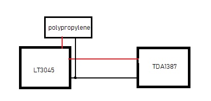

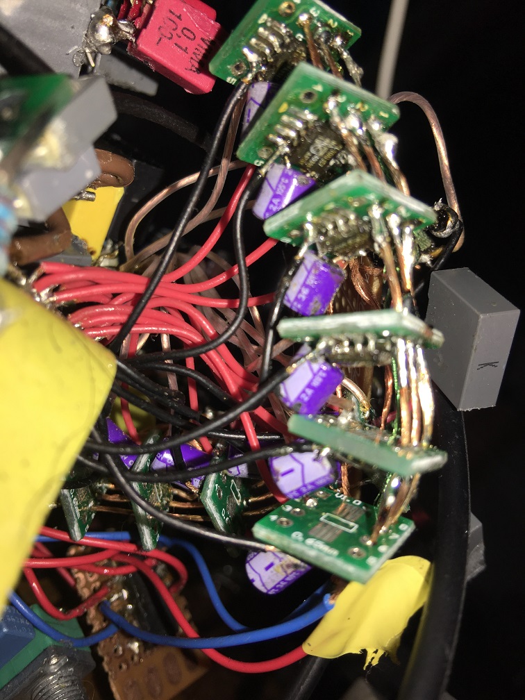

No, that's not my meaning. I mean to say its no big surprise that the film caps had a positive effect when they're going to be the dominant factor in the supply impedance across the top of the band. Mind you, 12 10uF OSCONs ought to have a paralleled ESR pretty low. Got a picture of the layout?
The chips are on DIP8 adapters, and oscon soldered directly to pins/pad, its satisfying that this kind of rough circuit building can allow even closer decoupling with the oscon than what possible on a PCB.
From the LT3045 board output there is a twisted pair to the huge film caps, the chips have individual wires also directly to the LT3045 output, instead of the legs of the film caps as the chip power wires are shorter this way with the big film caps out of the way, if that makes sense.

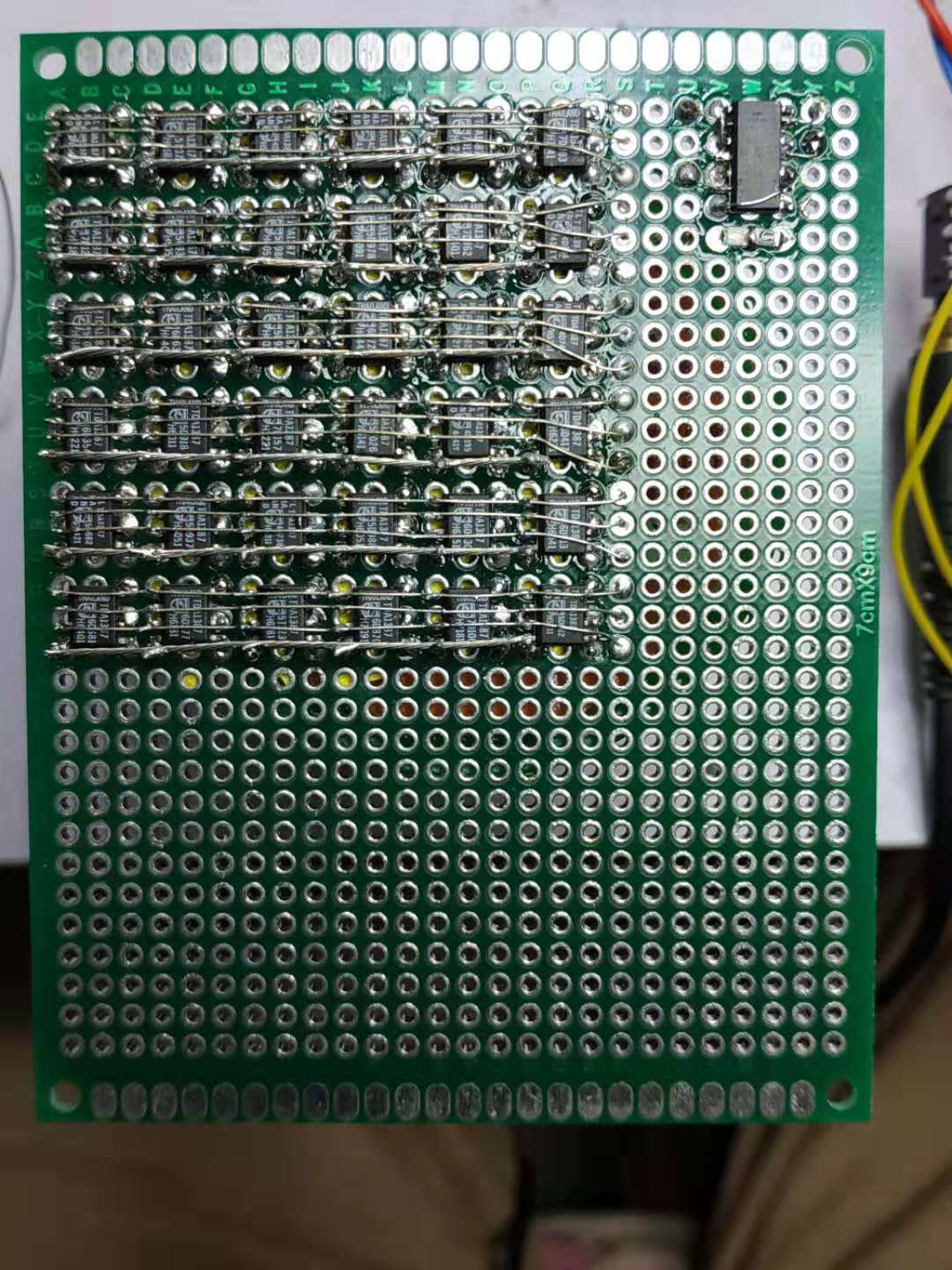

Here's a prototype coming together of a 6*6 'matrix' of DAC chips, running 2 * 18 in parallel, designed to feed a CT transformer (EP17). As I've mentioned already, SQ with this relatively simple I/V circuit is very promising, somehow there's more emotional connection to the music and bass seems more powerful. I'm continuing experiments with different ways to parallel chips.
