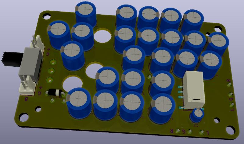

Here's a couple of pics of the next-generation design coming along.
The weakness of PhiDAC subjectively (to my ears) is evident with choral material in that massed voices tend to become rather hazy or blurred. The experiments I did earlier with the 'towers' of caps fixed that on PhiDAC but the build method was completely impractical for anyone other than a die-hard DIYer.
So PhiDAC SE has been developed to provide a slightly more practical way to get that cleanliness on choral works which the original PhiDAC lacks. The rail impedance is lowered by using more caps but the caps aren't fitted to the main board - doing that doesn't look like a particularly cost-effective route. For one it takes the board size well above the 10*10cm lowest cost board ceiling. So I'm playing with ways to add caps without adding significant cost-up.
The pics show a couple of PhiDAC SEs under construction and a prototype attempt at a 'powerbase' using bare double-sided PCB. Its split into half, left and right channels have their own array of caps - in this case 16X Nichicon HZs. 1mm diameter solid copper wires link the two PCBs, adjacent to the power pins of the AD815.

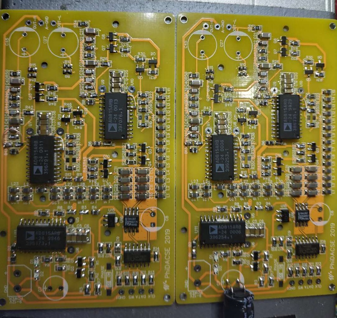

PhiDAC SE rev1
Revised boards arrived a couple of days ago for PhiDAC SE and the first one I built worked first time - at least it played music, I've not checked the flatness of the filter yet.
The extra caps on this design are fitted underneath the board via 1mm bare copper wires. The DAC still works without the off-board caps though as it has a few ceramics doing the local decoupling.
PhiDAC SE is very much at home driving headphones directly, even down to 30ohm impedance due to the far better dissipation capability of AD815s compared to AD8017s. Plus the advantage of additional caps (up to 26,000uF per channel) to provide greater output current without significant 'sag' on the rails.

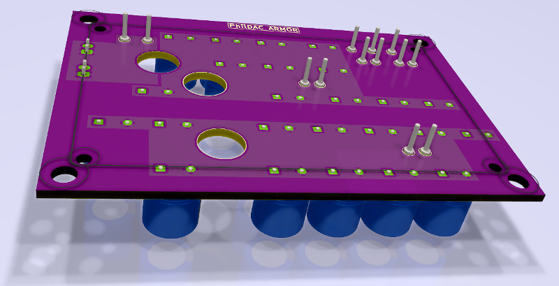

I originally thought to attach caps on a board above the opamps on PhiDAC SE, in a similar manner to the mods I did on original PhiDAC. The cap PCBs then become 'hats' in the manner of RPi add-on boards. But when the PCBs came back I realized that the wires between them are shorter when caps are added underneath opamps rather than on top. So now I call the cap boards 'pants' The cap board with caps at the side is a 'skirt'.

I have some NCC KZH 1800uf 16V = D10mm x H25mm to use on the board.
I have some what the same setup for the board. The cap will be upside down. The exists cap will be solder backward and there will be holes for them.
