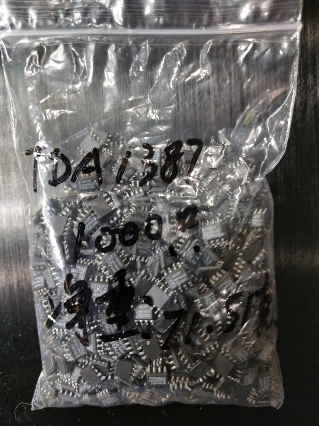

I've been reflecting on the engineering need for more chips and realized that using so many does solve at least one of the issues which has been bugging me with PhiDAC. That is the variation of the gain - an individual chip has something like a 14% tolerance on its output current. An array of 64 will reduce this by around 8 times assuming a normal distribution (which is perhaps a doubtful assumption). The transformer solves another issue - DC offset - as well as reducing the summed output current to a manageable level.

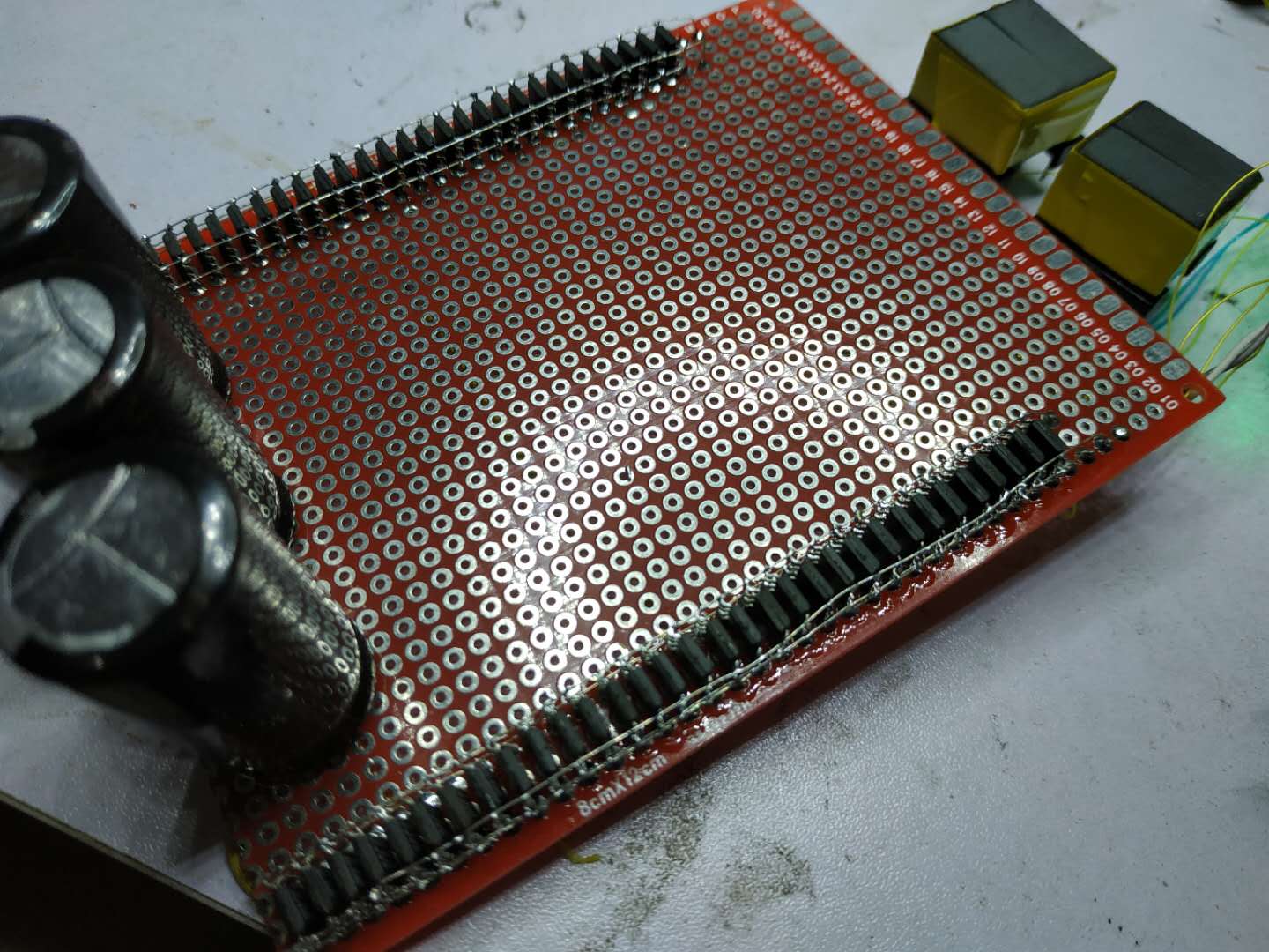

First prototype 64-chip DAC
I've wired the DAC chips on their ends - fortunately that's where both power pins are located. Then run wires all along the pins for I2S on one side and the output currents on the other. The transformers are 1:100 step up and there's just a resistor for I/V on the secondary which then feeds the lingDAC's SEbuff. Quite promising sound for a first lash up. Next is the CLC filter - it needs a high-valued inductor given the working impedance on the trafo secondary is 15kohm.
very intuitive use of the PCB, without it trying to have them secure and positioned to solder the wires is some challenge.
I have tried flattening and bending the pins on the chip directly down to solder them together without wires, works ok but kind of messy and easy to break a pin.
The two rows of DACs in the picture are positive and negative phases so this DAC's already running balanced at the front end. I agree it would be better to dedicate each DAC to just one channel but that will have to wait until I install a CPU to pre-process the I2S. Fortunately a dev board for the LPC55S69 is on its way - this has the benefit of 8 I2S in/out ports.
@laserscrape - in the past I tried direct stacking of chips by bending pins down and using solder to bridge across any gaps. It was a bit unreliable in that its quite hard to see when there's a solder joint in place but at least a quick check with a multimeter between top and bottom can reveal continuity. Holding the chips aligned with each other is tricky too without wires mechanically securing the DACs - perhaps I'll experiment with using thick PSU wires as an alignment aid....
