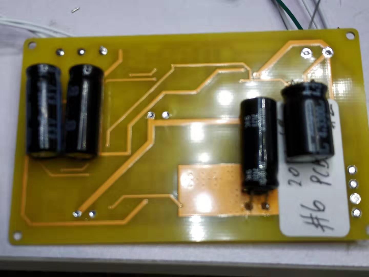

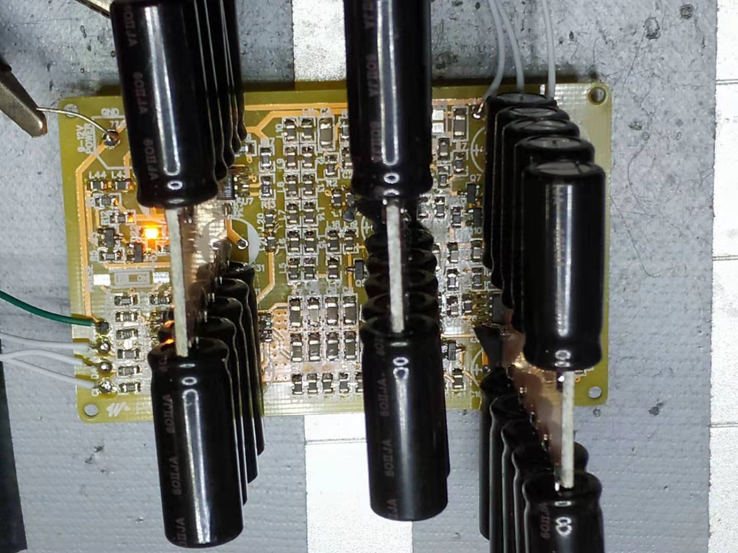

Upgrading the opamp power supplies
Turns out that its possible (though very fiddly) to give all the AD8017s a much lower supply impedance by means of arrays of caps soldered to the top of the ICs. Its not a portable solution as the 'blades' of capacitors are only held in place by solder but its a fun experiment to try nevertheless to discover what this DAC is capable of.
The top mounted caps need to be bottom mounted to clear enough space (see first two pics) then the blades made out of 10 off 1800uF/16V low ESR caps can be soldered to the power pins of the AD8017s. The raw double-sided PCBs the caps are mounted on are roughly 5cm * 2cm.
