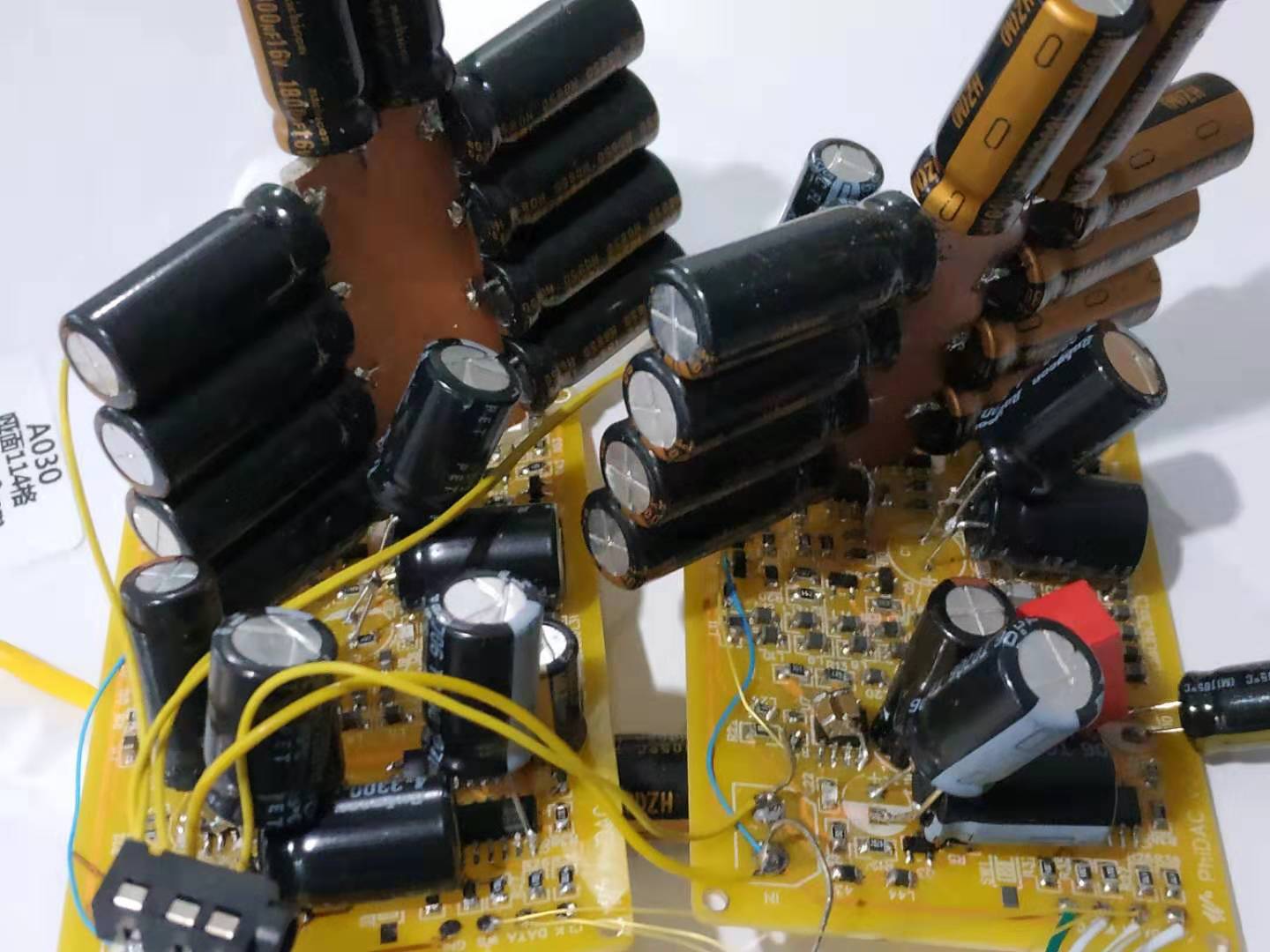

I already have a suggestion which improves the SQ of the PhiDAC even further - but this one is a little bit tricky to implement. I've created two very low ESR capacitor 'hats' to go on top of the AD8017s. They're so bulky that two cannot be fitted on the same PCB so I've gone dual-mono, meaning I need two PhiDACs, one for left and the other for right. But the effort is well worthwhile 😀

Wow ! Thats a lot of capacitors 😛
Can you tell us its purpose ?
Why not a big capacitor instead of many ?

Hi abraxalito, looks great – ESR is in the range around 0.5 miliohm? Only organic polymer caps have better (lower) ESR.
Any current production (aluminium electrolytic) caps with such low values as the Nichicon HZ?

Chris gave the short answer, but there's a bit more to it than just ESR. ESL (equivalent series inductance) is also a concern when impedances are low, such as in power supply applications. A single capacitor of 18,000uF/16V will have a pin spacing much wider and hence more ESL than a 10mm diameter cap such as these 1800uF/16V. The ESL divides down by the number of caps too, just like the ESR. So it turns out, if you really want a low impedance supply, the only way to go is multiple paralleled caps.
I've used raw double-sided PCB material to keep the ESR and ESL low and the caps are soldered with very short leads to the two power planes.
@enregistree - my LCR meter showed an impedance about 1mohm of X and 1mohm of R @10kHz but down at such low levels its tricky to get a reliable reading as getting a good contact isn't easy. I don't know which current production 'lytics achieve the same ESRs - Nichicon HZ seem to come and go in production, various Taobao sellers appear to have them at the moment.
