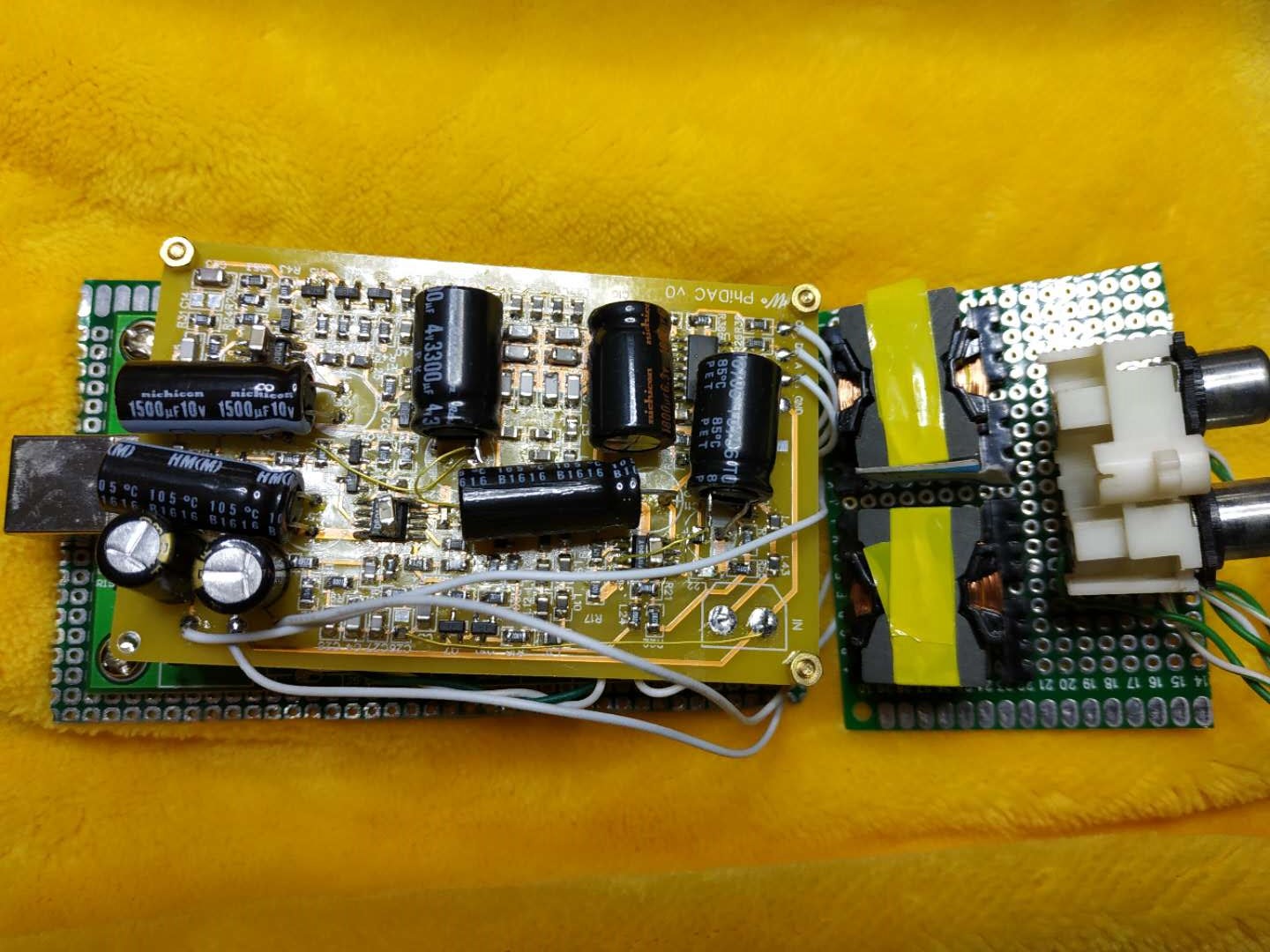

Example PhiDAC application - USB input DAC
@thuanth43 - I'm toying with the idea of putting an MCU on the next revision of the PhiDAC, at that point we can use software to configure the board as single mono/balanced or stereo/SE. That's some way away though, perhaps late spring time as I need to dust off my firmware skills :)
In the meantime, here's an example of how to use PhiDAC as the foundation of a USB powered DAC. There are a few parts to be added - the USB input, a PSU and transformers for the output.
I can't find the link to the USB board I'm using at present, its perhaps hidden because its still holiday period. When it turns up I'll post it.
The PSU is an LM2662 configured as voltage doubler (rather than the normal inverter) and an LC filter afterwards to reduce the switching noise. Its fed direct from USB bus power - I'm using a spare lingDAC power PCB.
The transformers are PQ2016 cores (here : PQ2016???????6+8???????????PC40?????-???) wound with 0.08mm for the primary (1100T) and 0.09mm for the secondary (1100T). Transformers aren't strictly necessary but they do help to improve the SQ when the DAC's fed from such an electrically noisy source as a PC. If the PC you use is a laptop that's always powered from battery they're probably not needed.
