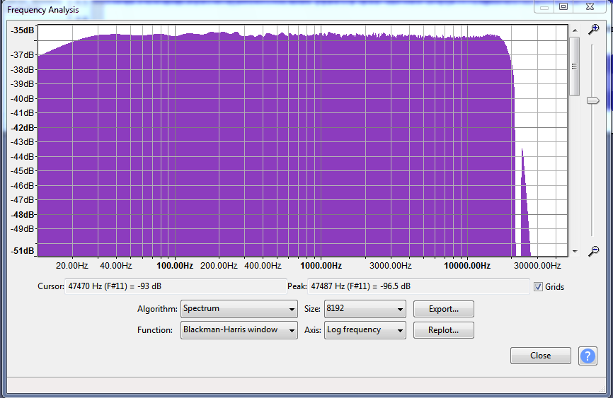

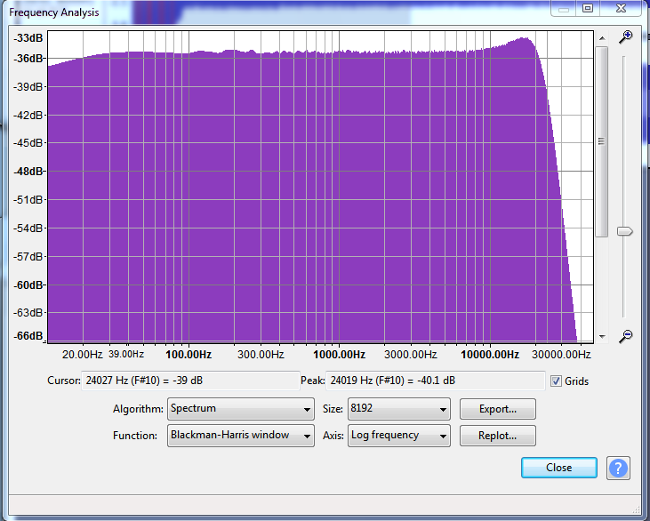

I created a white noise test waveform in Audacity at 96kHz sample rate and played it through PhiDAC, recording the output with my Sony PCM-M10. Here's the FFT of the output displayed in Audacity. The lift in the FR at HF is there because the DAC's equ'd for 44k1 which requires more droop correction than 96kHz. I'll make another recording using 44k1 sample rate to show how effective the droop correction is.
Incidentally I suspect the slight LF roll-off might be in the recorder, I can't of any mechanism in the DAC to cause it.
<later - added the 44k1 plot. The FR is pretty flat to just above 17kHz, then rolls off to -2dB @ 20kHz. The chasm just above 20kHz might be because I downsampled the 96kHz white noise file to create this stimulus.>
