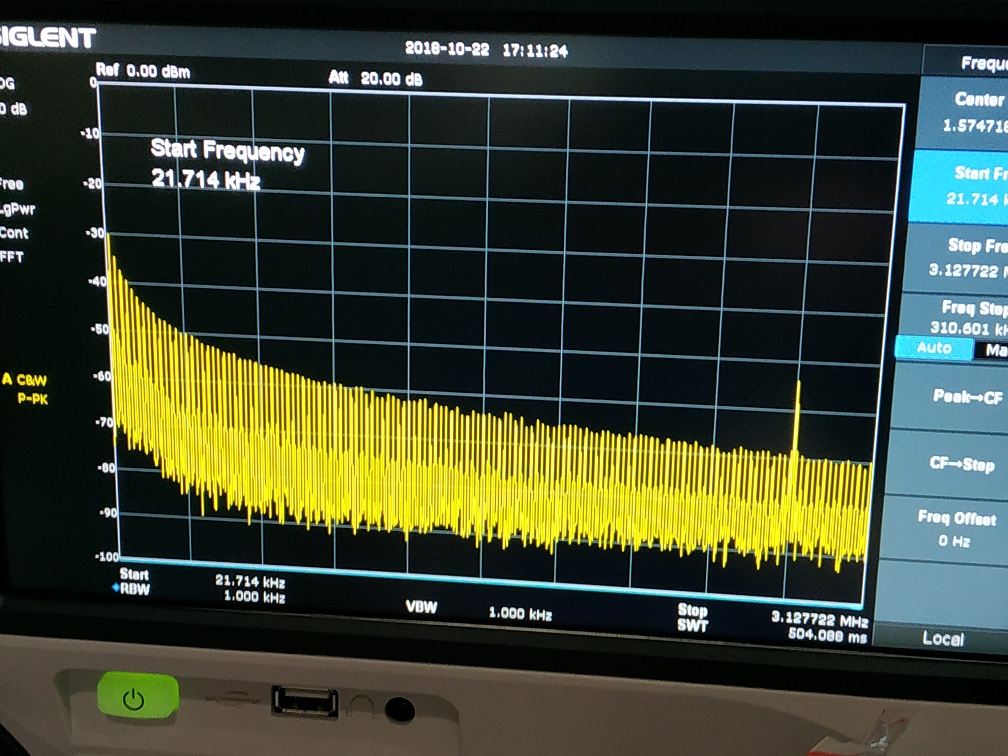

Yes, I had a heads-up from another contributor to that thread. I saw George mentioned me and you said something about 'clock noise' which I wasn't sure about. For clarity, the filter's not for getting rid of 'clock noise' primarily though it of course does help with that, its for eliminating the bulk of the images.
Here's what I saw on my SA from a 'raw' TDA1387 output. The clock noise dominates for sure at higher frequencies but plenty of the lower frequency images (below ~400kHz) are higher level than the clock.
