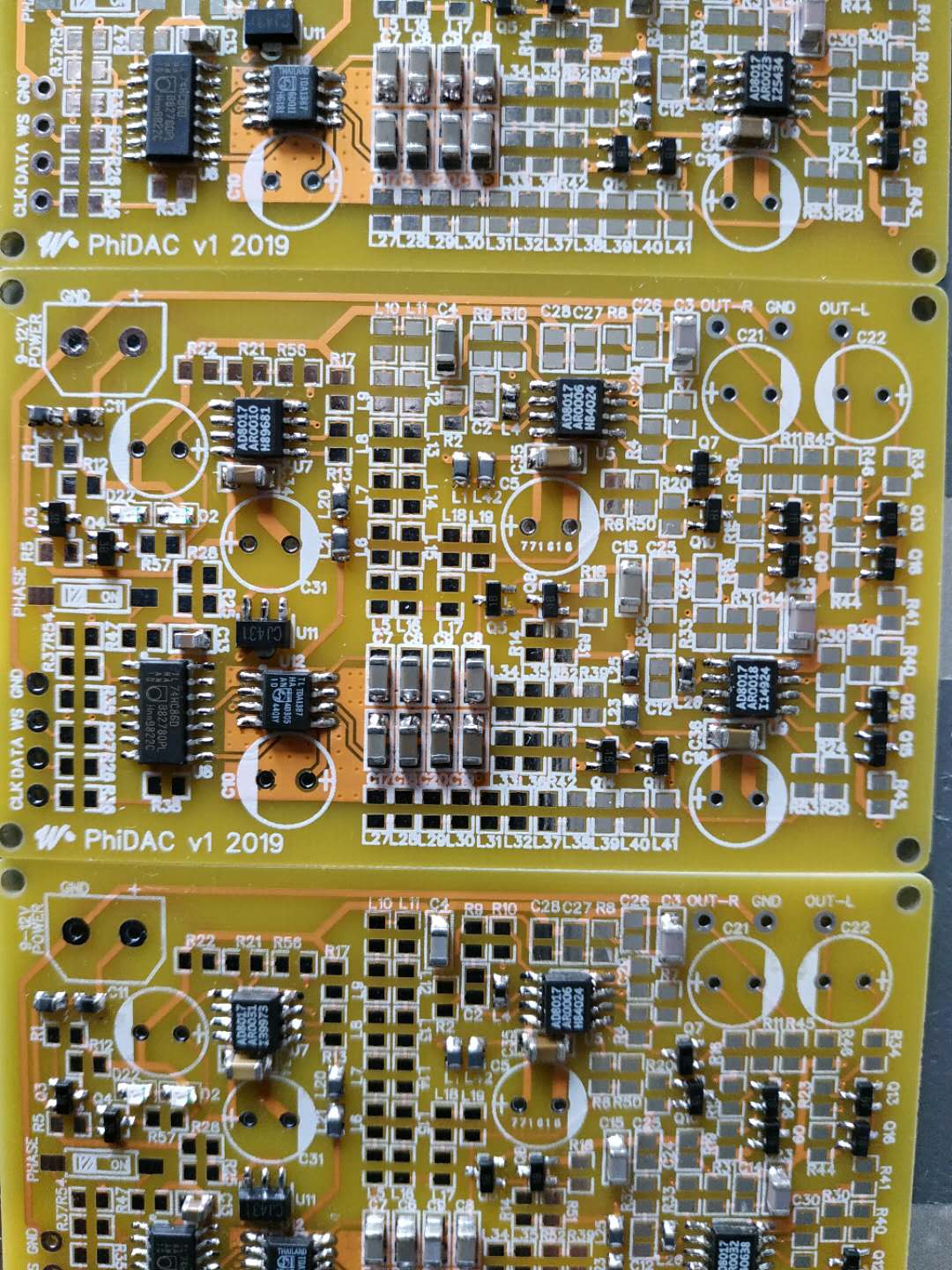

Yeah, let's do that. The v2 PCBs (although I began the numbering at v0 so these are marked v1, I'll call them v1 from now on) came earlier than I expected. They also sent about double the quantity we ordered (and paid for) so I could be quite busy stuffing over the next week 😀 The v1 is easier to stuff because the parts are laid out in a more orderly fashion, I reckon it'll take between 1 and 2 hours per board to get loaded.
Here are the first three boards with the semis and FBs already on, in process of caps being soldered. Incidentally the new one is also lower power than the original, having deleted a current source its draw is a little over 60mA @ 9V.
Once I have a tested working and characterized v1 then I'll update the BOM and start the process of creating kits. Is there any interest in a Mouser BOM incidentally? It'll be fairly expensive to order just 1 off from there, my guess is between $40 and $50 and that won't include the DAC chip because that's not a production item.
Can we please continue with the DAC design discussion?

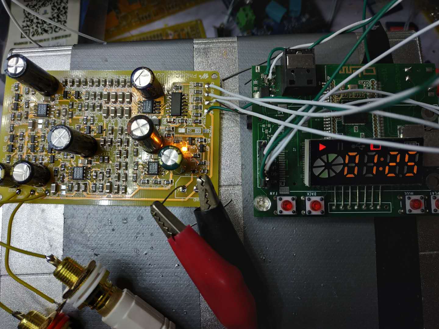

I dug out a much older TFcard I2S player and was surprised it works with the Android APP. A killer bargain-basement combination with PhiDAC - hard to beat these ATS2825 players (with the right firmware, not all such players on Taobao are equivalent).
The first three v1 PhiDACs are now working well, next up is checking their frequency responses to verify the two on-board filters are behaving as intended (NOS droop correction in particular). I plan to do this by generating a chirp using Audacity and recording the output with my SDcard recorder then examining the resulting .wav file with Audacity. Simply feeding the output into my AC voltmeter won't work well enough I fear because the image filtering doesn't suppress ultrasonics fiercely enough. As a result the HF energy gets falsely boosted by the inclusion of images.
