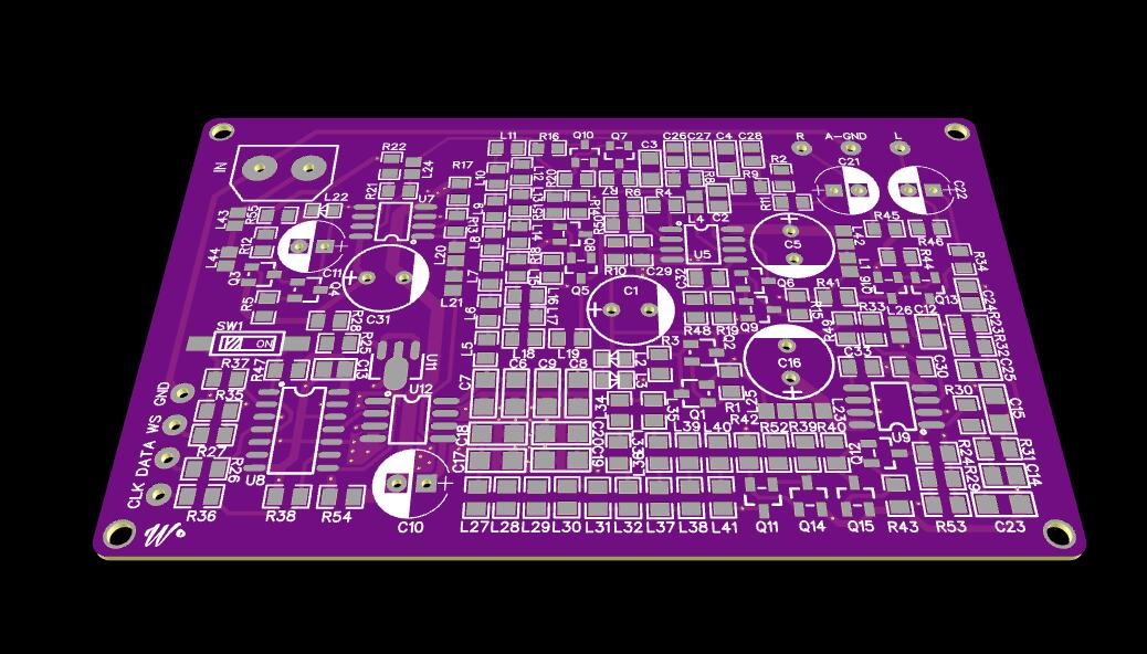

phiDAC's v0 PCB layout has been finished, it'll go off for manufacture now. Turn-around is normally under a week. Here's a 3D rendering of the blank board. Next up - work on the BOM 🙂
I'm not really clear on what you mean here. The DAC chip is current out, the finished DACs are voltage out so there's transimpedance in the I/V stage (so many volts out per milliamp input). Is that what you wanted to know? Or are you simply asking for the output level? In which case they're (ling and phi) both 2VRMS max.
Its gain is a transimpedance - a single DAC chip running at 6V has 1.2mA output range for which there needs to be about 5.6V voltage range. So the figure is 5.6/1.2m or about 4700ohms.
In phiDAC that gain is distributed across two stages, with the bulk of it in the first (flat FR) stage. The filter stage has a relatively modest gain of 7.4X (17dB).

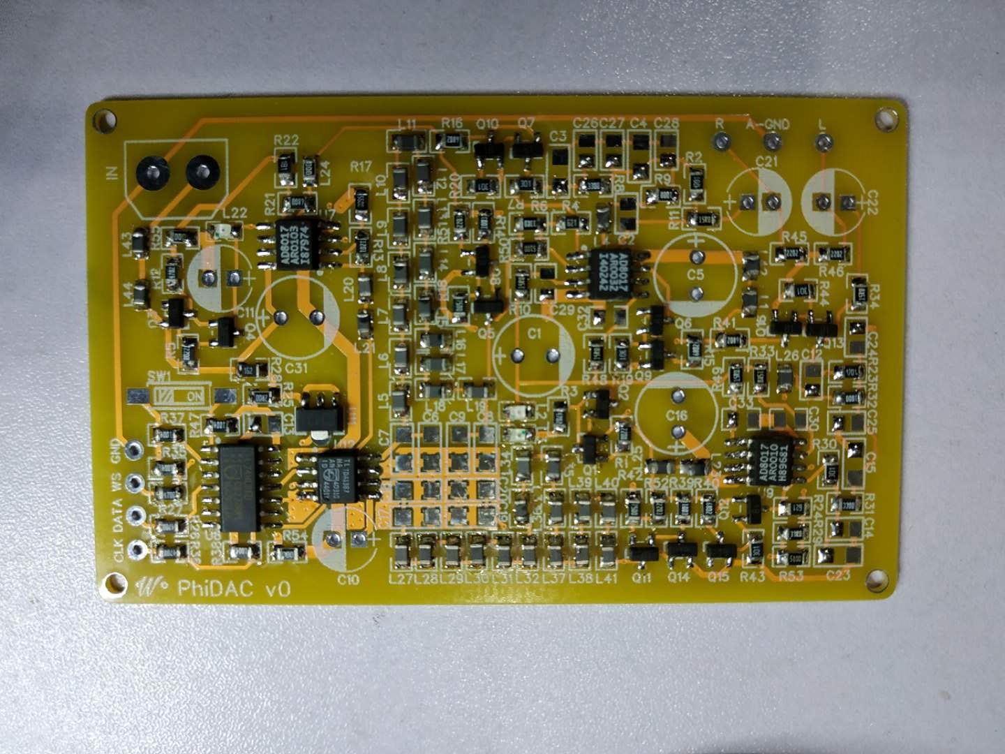

First proto PCB
PCBs have arrived and I've started populating one - here the semis, inductors and resistors have been fitted. Caps to go next.
Costing using Taobao pricing (in quantity 100s or so) is around 20RMB - roughly $3.

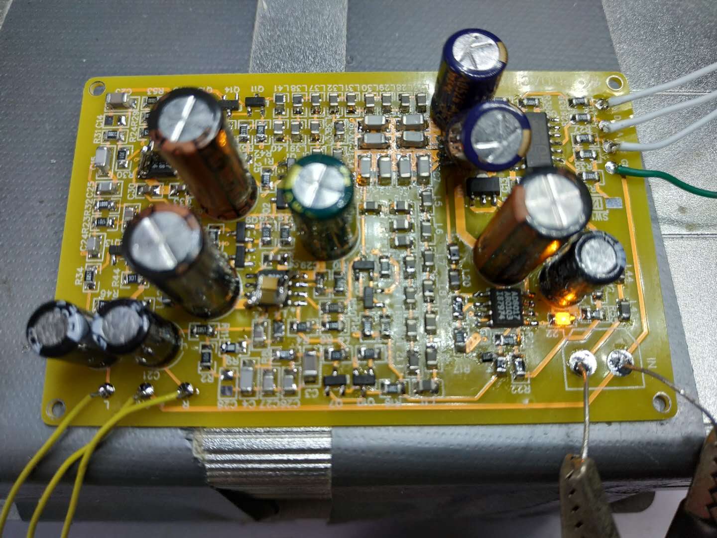

Here's a pic of the first completed prototype on the PCB. Listening relative to lingDAC it gives up a little in HF quality, most noticeable on orchestral violins. If the reference is a typical S-D DAC though, then the HF quality is much improved (not to mention the dynamics are in another league against ES9023/PCM5102 etc). Against lingDAC, the soundstage isn't quite as well lit-up over the full width, it seems rather that the edges are 'brighter' and the centre is a little dimmer. But considering the considerably reduced BOM cost and time spent building, its a trade-off I reckon many won't mind making 😎
