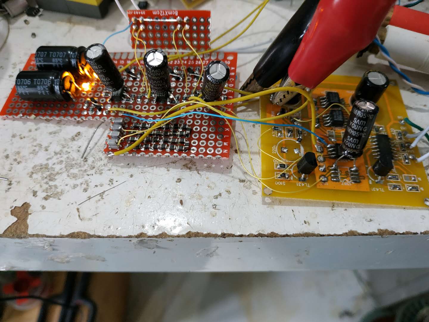

New DAC design, cheaper and easier to build than lingDAC
Since lingDAC requires a certain amount of component selection (inductors) and measurement on test I had the idea to do a 'lower maintenance' design. This is one of the early prototypes, the BOM cost should be significantly lower than lingDAC - its going on a single PCB for a start. Note though that the low BOM cost depends on sourcing components not from the usual distributors as that'll push the price up to lingDAC territory very easily.
To get this to be a 'low maintenance' design I'm using opamps rather than discretes. The opamp I've gone for is AD8017, for a couple of reasons. Firstly its ultra-cheap on Taobao and second its wide-bandwidth with a very beefy output stage. It can therefore not only be used as an amplifying stage but also as a voltage regulator.
Although the pic I've uploaded shows five DAC chips on the old lingDAC DAC board, I'm only using a single TDA1387 in this. Filtering is done with 0805 size inductors and then there's a traditional I/V stage, albeit one providing the correct loading for the CLC filter. Beyond that, there's a 3rd order MFB low pass which can be configured to taste - in NOS mode it provides for NOS droop correction but for those who'd like to use this DAC with external oversampling can be chosen to be flat.
Power supply is a single rail from 9-12V and current draw is under 70mA. Output is the normal 2VRMS. Schematic to follow in a while....

There are a lot of FB in PhiDAC schematic ? Is it Ferrite Beads ? And which are their values & footprint ?
Yes, they're ferrite beads. On the power supplies I'm using TDK MPZ2012S102AT that's an 0805 size. For the -ve inputs to the opamps I'm using an 0603 size at present MPZ1608S601AT. When I build the PCBs I might consolidate to just the 0805 type.
Lookin' at the schematic ...
Why are the I2S lines (into and out of the 74HC reclocker) so heavily buffered? That is, usually, one sees 50-150ohm Rs, not 470ohm.
That's not buffering that's current limiting. The logic level fpr '1' on the input will typically be higher than the supply to the HC86 (2.5V) so those resistors prevent too much current being drawn from the (likely) over-voltage condition.
Vcc
Vcc for HC86 is 2.5V? Why so low? (Although some logic chips can operate that low, per datasheet, usually higher Vcc is better).That's not buffering that's current limiting. The logic level fpr '1' on the input will typically be higher than the supply to the HC86 (2.5V) so those resistors prevent too much current being drawn from the (likely) over-voltage condition.
"Better" depends on what you're trying to achieve. Here I'd like lower noise, rather than higher speed. Since CMOS noise levels go up with supply voltage, lower supply is better here. Provided there's enough output swing to drive the DAC of course.
Dear Toots:"Better" depends on what you're trying to achieve. Here I'd like lower noise, rather than higher speed. Since CMOS noise levels go up with supply voltage, lower supply is better here. Provided there's enough output swing to drive the DAC of course.
Well, resistor Johnson noise ain't a factor then? Can you get that 74HC from Potato? Get rid of all those in-line I2S R's.
No, resistor Johnson noise is way down compared to the logic levels. I have no idea whether the HC86 is available from Potato. Is there any reason for me to look?
