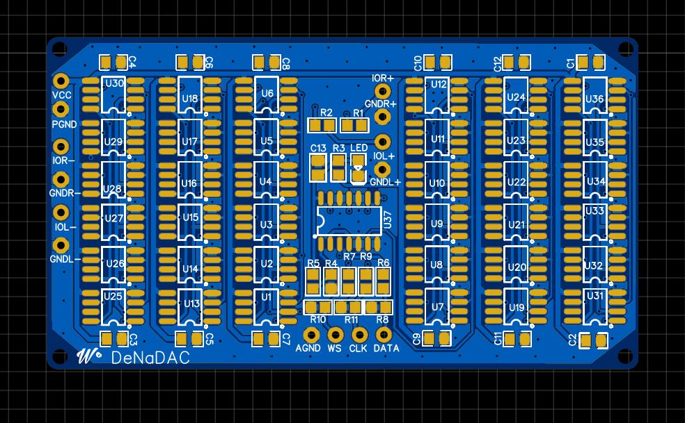

Parallelling DACs progress report
The 36 DAC prototype I featured a few posts back is now up and running. I've yet to come up with a relatively foolproof way of paralleling lots of chips so it looks like a PCB is going to be the best solution. Here's a board that's just gone out for manufacture - once I've proven it I'll share the gerbers here.

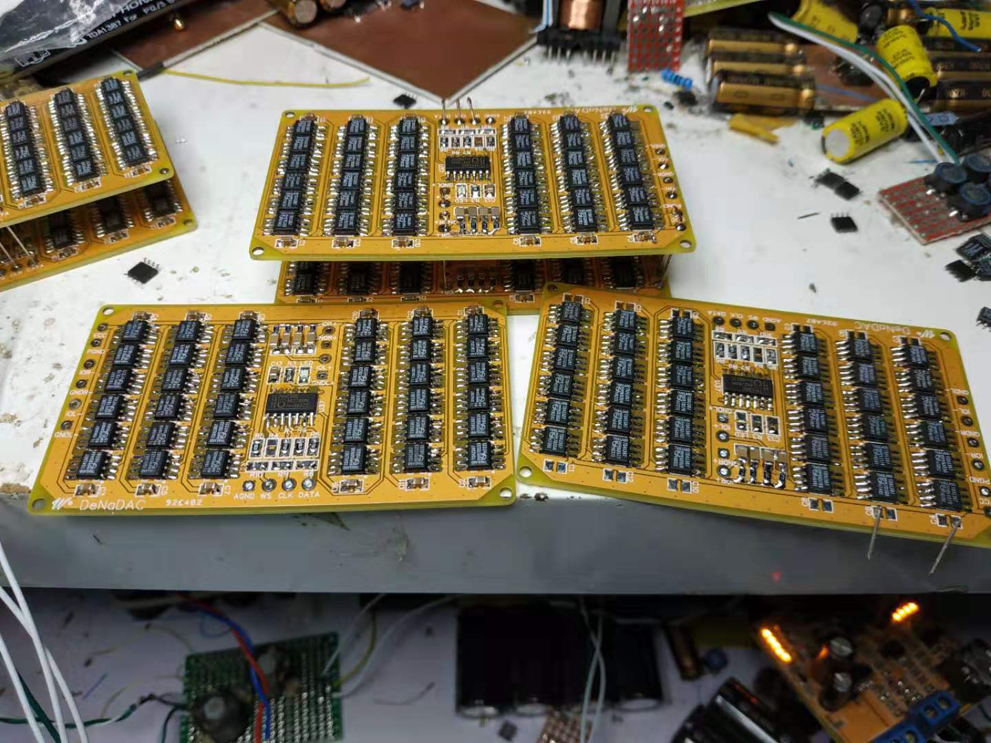

Paralled DAC progress...
The PCBs came in at the beginning of the week and I've been hunched over my soldering iron for a few hours building some up. Initially I decided to build a stack of 4 boards but that turned out to be way too ambitious to do in one leap, without prior testing of the individual PCBs. When I first powered up the 4 board stack it sounded terrible - noisy. Which means some of the DAC chips had failed, so I had to take it apart again to see which. Lesson learned - some leaps are just too great to make!
I was curious to find out if it was something I'm doing in the circuit which was causing chips to fail or if they were suspect even before I plugged them in. As I haven't figured out a way to test a chip out of circuit yet I decided to put them down on the PCB but only solder the two power pins - mainly to simplify extraction if they're proven to fail. With power on, pin7 is the experience-proven way to check if they're OK - the voltage on this pin is supposed to be 1/6th of the supply voltage (so 1V when 6V is used to power them). It turns out that it varies a little bit. maybe 10mV either way but is fairly predictable on a working DAC. But non-working DACs give voltages far away from this - from a few hundred mV up to 5V or so.
So far, having soldered in 216 DAC chips I've found about 9 to have failed. What's odd is that I can't remember prior to this having found a single dud out of the tube, though I've blown up more than one in-circuit. Something of a mystery.
