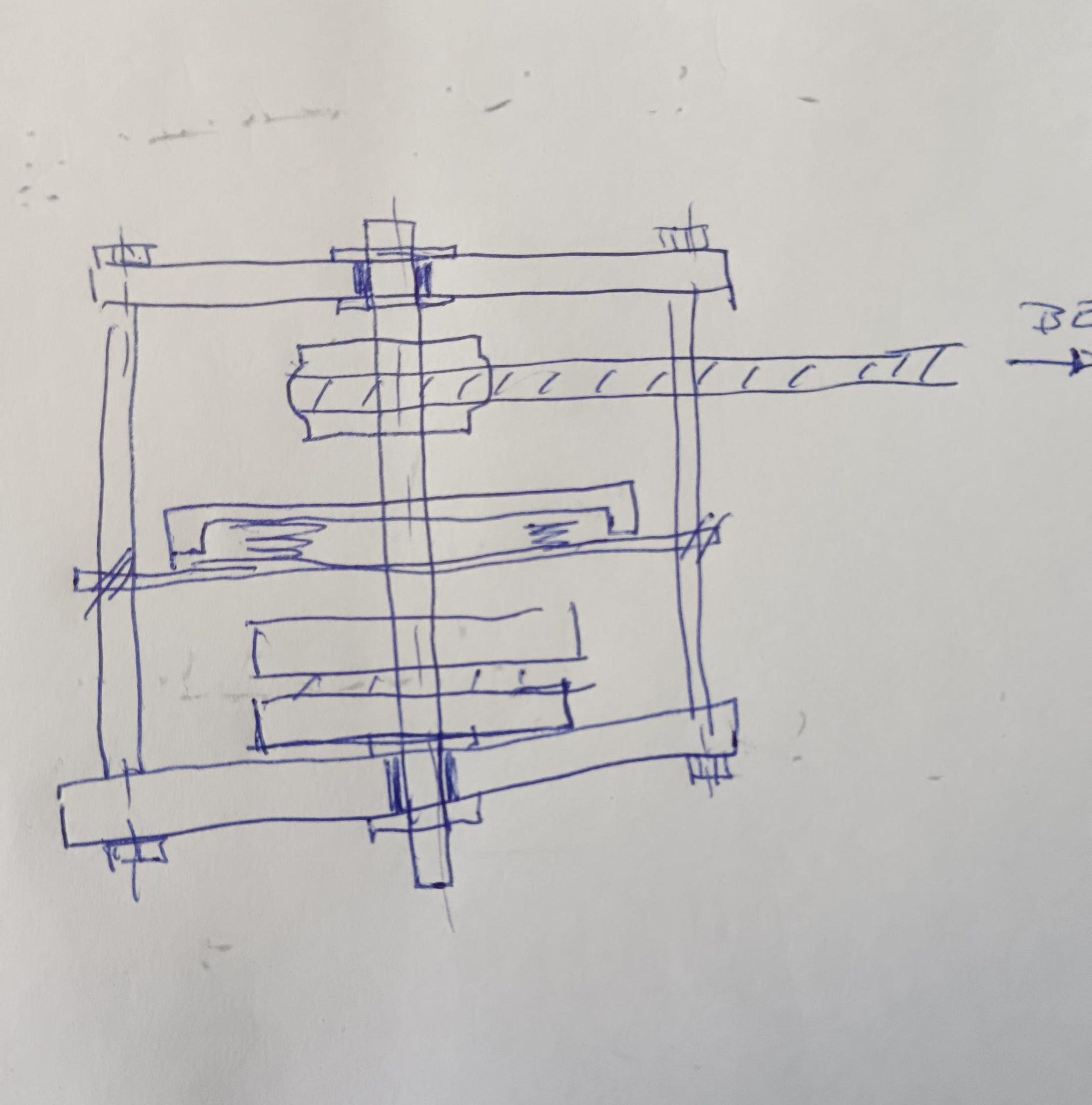

Can you make a sketch what you plan to do? 2 slot-less motors from beta-cams (one is in #308) already have 5mm shafts, but ball bearings need to be changed for bushings, might be a suggestion?

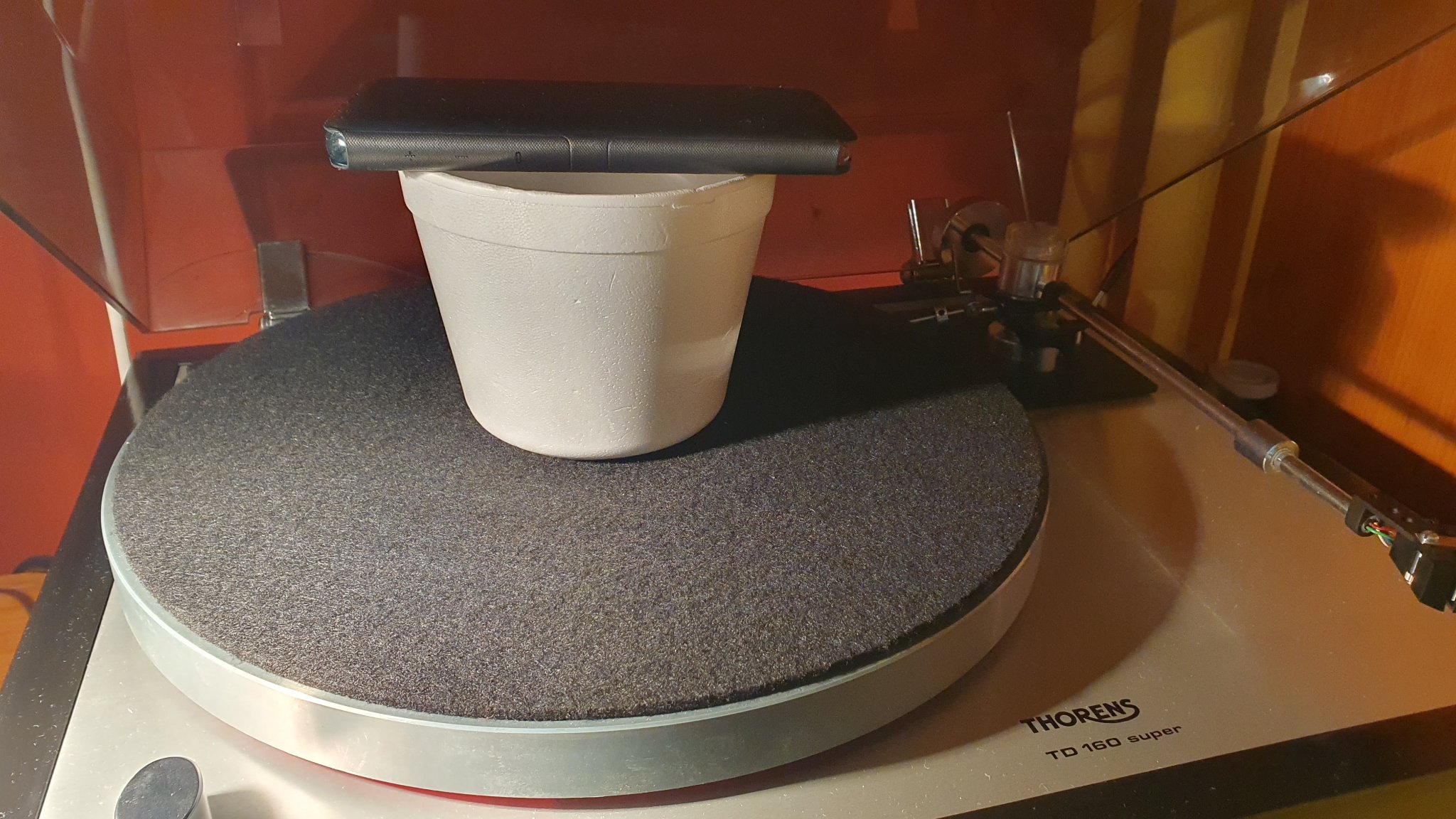

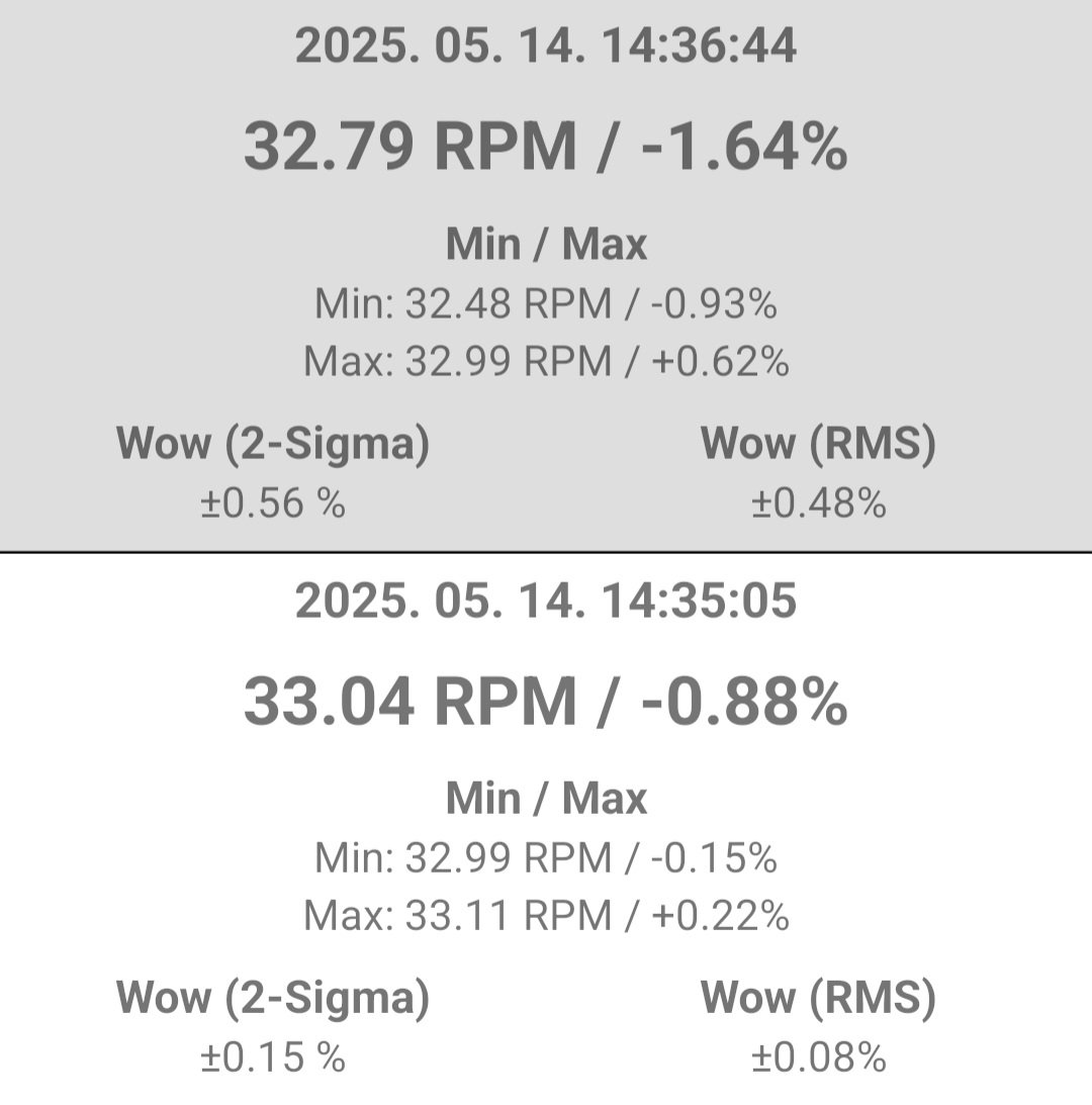

I don't trust this rotating smartphone measurement principle. If you place the phone off-centre, the angular velocity of the sensor fluctuates within a revolution. See my measurements, the first is about centered, the second is close to the platter edge. It is impossible to perfectly centering, and the position of the gyroscope within the smarthone is unknown. I suppose it should be placed right on top of the spindle.
I used an ice cream bowl with a hole in the bottom.
Hi Laszlo,
At beginning I was also skeptical, but more I use it, more I trust it and like it.
I get all the same measurements regardless of phone position on the platter, within 0.01% which is threshold, tried that several times. Dont know why you get different depending on position, and such big one....
In post #253 I showed 2 different phones measuring at same time, results pretty close.

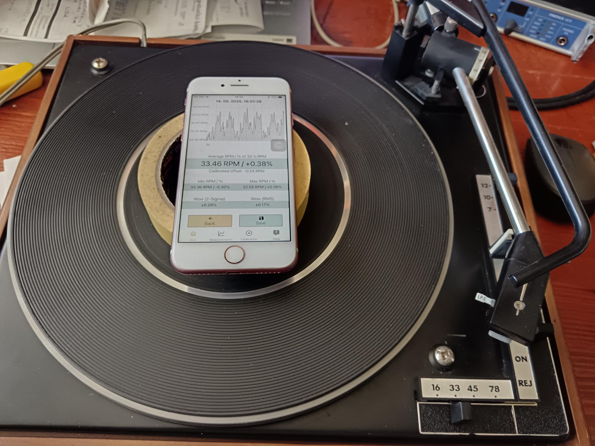

By the way, roll of masking tape or duct tape makes better stand for phone 🙂

I quickly took 2 measurements on my TT, 3 different phone positions: on reel in center, near spindle and 90deg to spindle... All 3 measurements are the same.
Last week I measured Revox B795, fantastic tt, 0.03% without service, 2 kg platter and same in all directions of the phone.
Than just for fun I took out old BSR TT that I want to make for my 9yo son to play with. This TT is super light platter and wasn't serviced in decades. On this one, WOW goes from 0.17% (in center) to 0.57% 90 deg to spindle. Interesting...
Doesn't really need a sketch (which is difficult for me to get into computer). I have in mind two lignum vitae sleeves bored to be as tight as tolerable without excessive friction, one sleeve at the top, one on the bottom. Pulley would be below upper sleeve. Each sleeve would be mounted centrally in a large disc. The discs would be larger than the motor's periphery, allowing three rods to bolt lower disc to upper. To take the weight of the rotating mass, a neodymium magnet on the bottom of the protruding shaft facing an opposing neodymium magnet whose height can be adjusted, probably on a screw thread. That way, we get a noiseless support. Obviously, the awkward bit is that the belt must be fitted before the motor is assembled...
Yes, that's it. I might put the magnets below the bottom plate, but that's a minor detail. Changing the belt will require the three screws holding the top plate on to be undone, the top plate removed, belt changed, top plate replaced, three screws refitted. Not really a serious problem. The pillars will probably be reasonably substantial; 10-12mm diameter aluminium. Top and bottom plates 1/4" thick aluminium (I have a 6ft x 3ft sheet of the stuff!) Haven't decided about the motor plate.

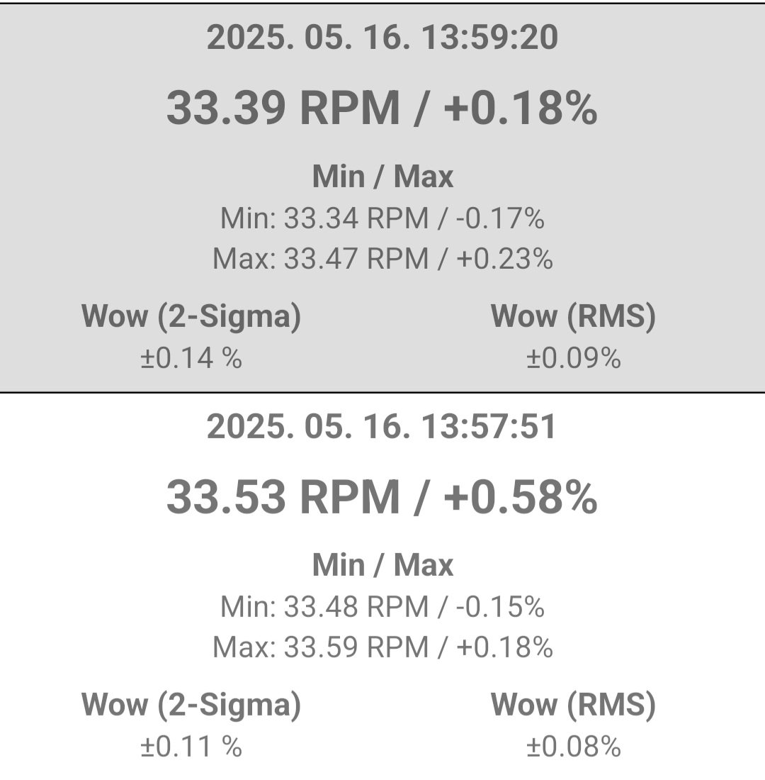

I "serviced" my turntable a bit, eliminating the belt friction to the speed change lever. It is much better now. With and without needle in groove.

Excellent Laszlo,
Funny things are that even smallest changes do affect belt drive TT, and this phone app is capable of capturing them. I found it perfect for improving TT as whatever change I do, I see it immediately., keeping the same measurement setup of course.
