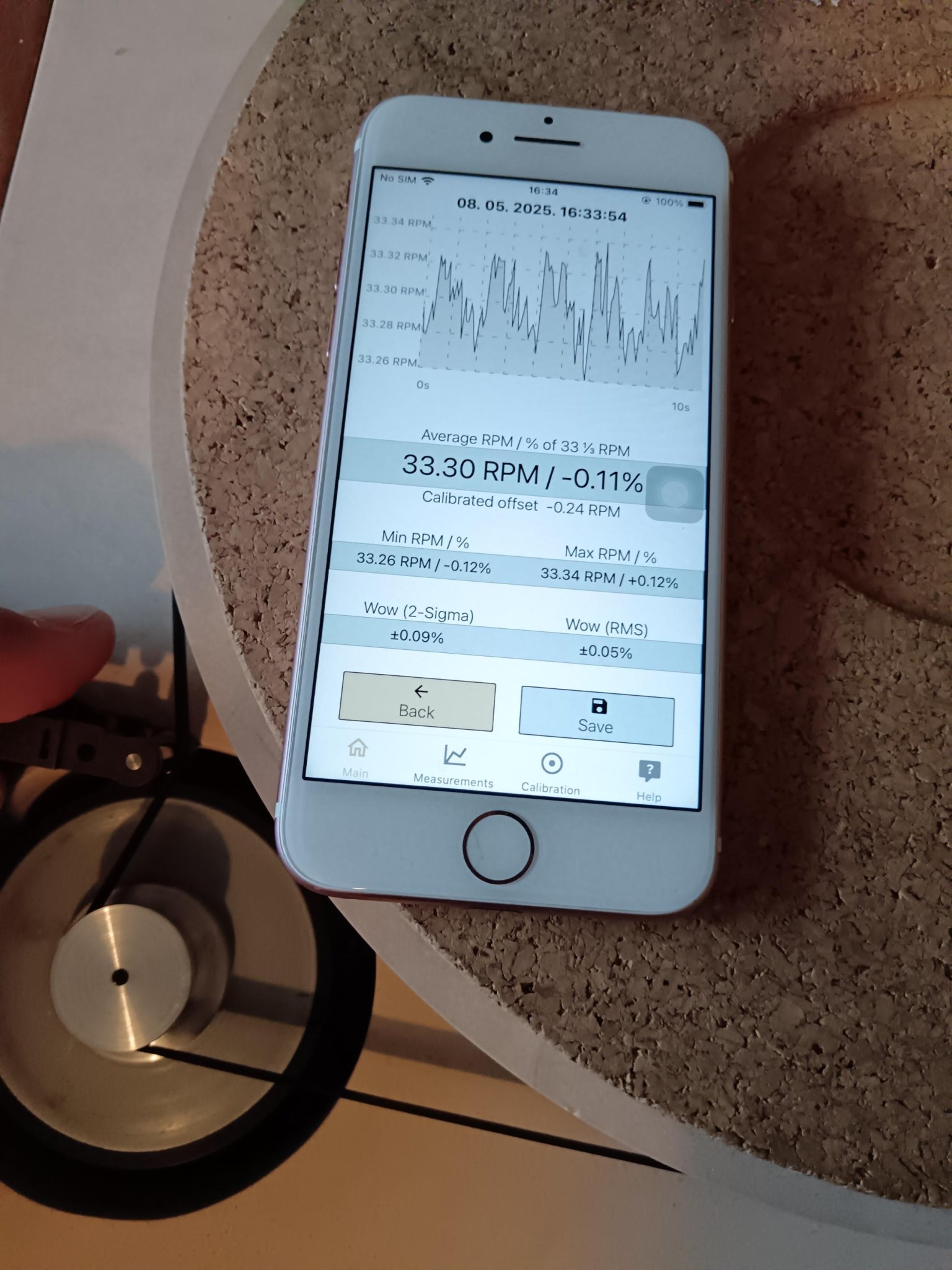

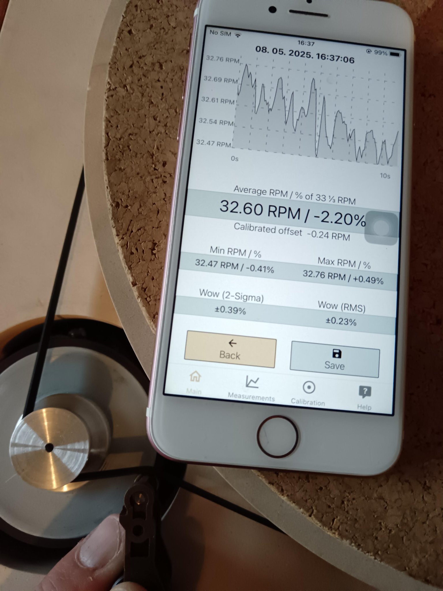

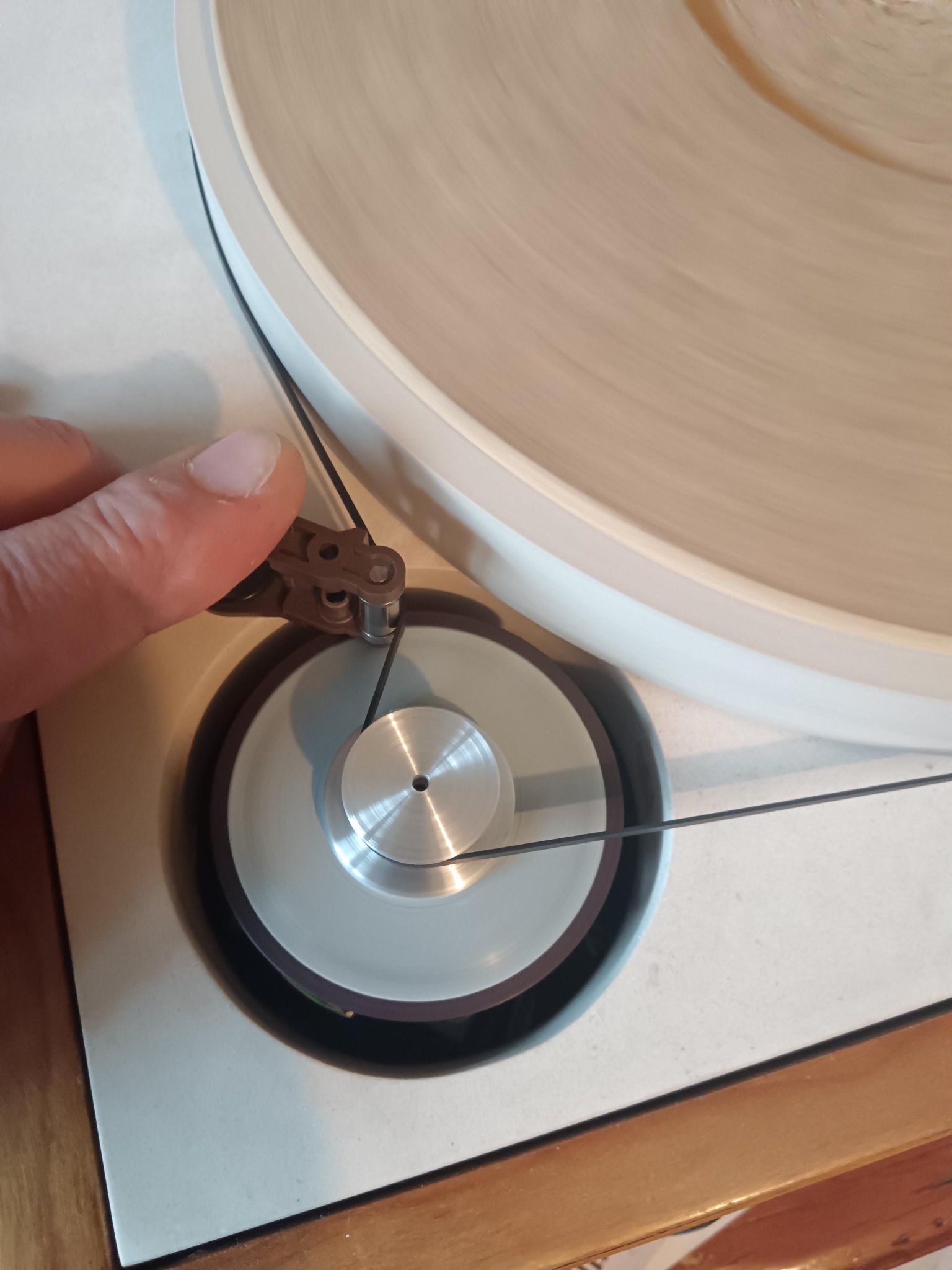

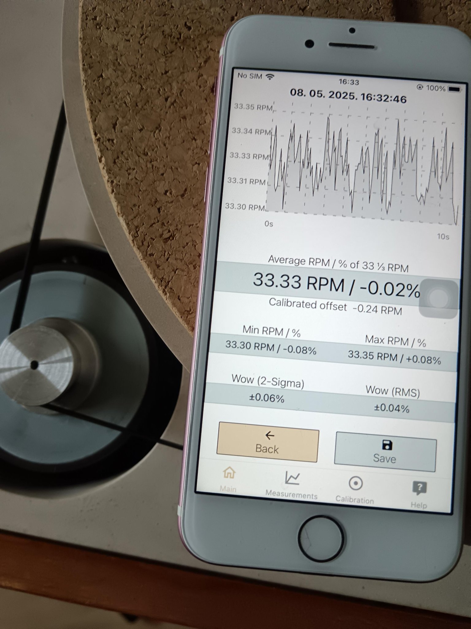

You are right, there is transfer ratio of about 15. But nevertheless I can apply as soft as possible touch on platter, and very hard push on motor, result is same.. Belt is slipping on pulley if allowed to do so.Your finger pressure on a small diameter motor is much less compared to the platter because of the size difference of the two discs. Leverage on the platter will be much more than on the motor pulley. But yes, I agree that it is highly likely that the belt is slipping on the motor pulley. Reminds of what happens to vacuum cleaner belts. They will slip on the shiny motor shaft rather than on the larger rotating brush shaft
There was TT designer that said toothed belt or chain would do best, I tend to agree.
Interesting stuff. The motor is synchronous, so it definitely rotates at constant speed, unless it slips an entire pole, leaving smaller slip at the motor pulley as the most likely cause of speed variation. Something I've been wondering about, particularly in relation to the motor you and I have chosen is to fit a pinch roller and use 1/2" tape from a VHS as the belt. Obviously, a rather larger pulley would be required.
Your acid idea is a definite possibility; Revox/Studer tape machines had an etched capstan and I remember local radio engineers talking about dipping their shafts in drain cleaner to restore that slightly rough finish.
I found smaller pulleys with low angle of attack (aka close to the platter) have more slip. Using a larger pulley and farther away from the platter increases the amount of surface area in contact with the pulley, and ensures that there is a greater arc across that contact.

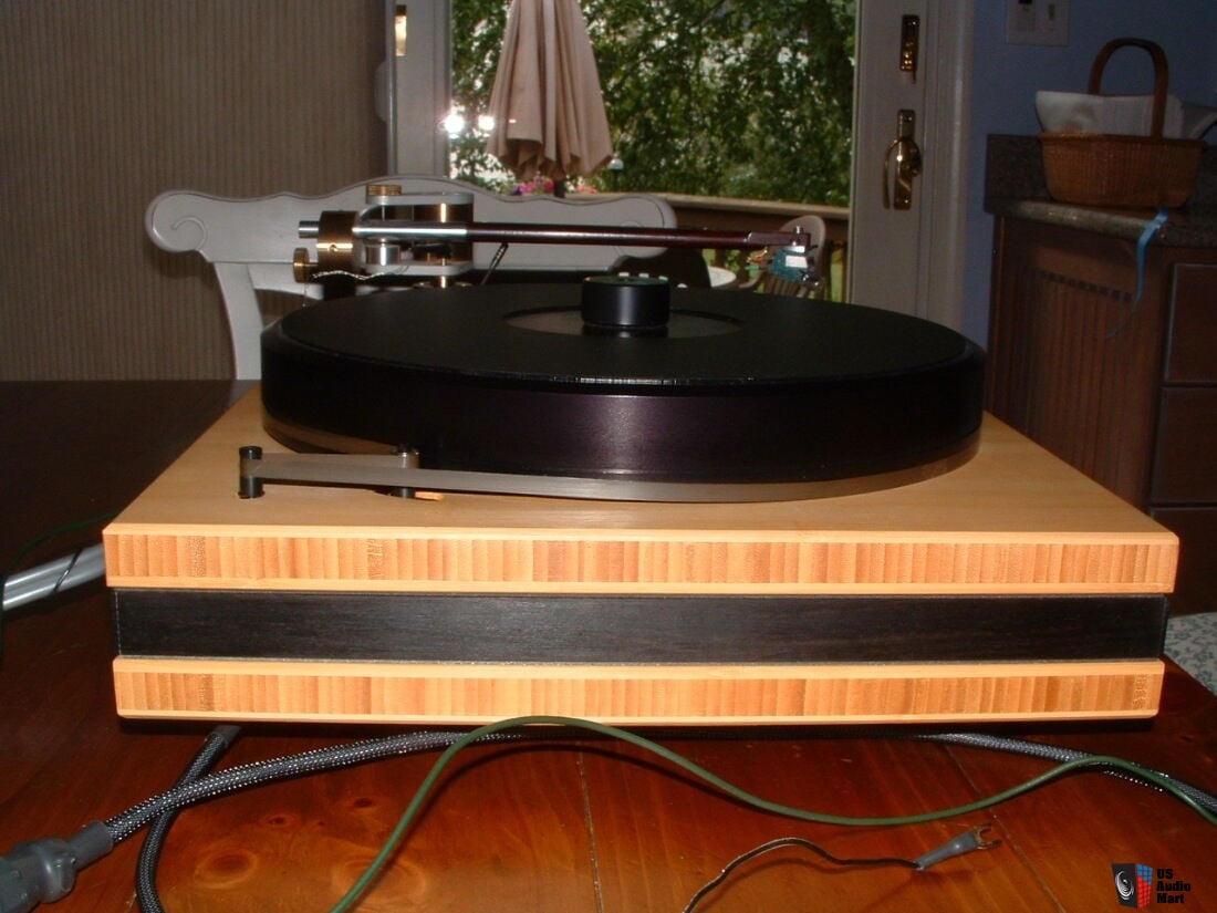

The only obvious limitation of the LAB500 Table is the counterweight is somewhat light requiring low mass headshells for your cartridge.
