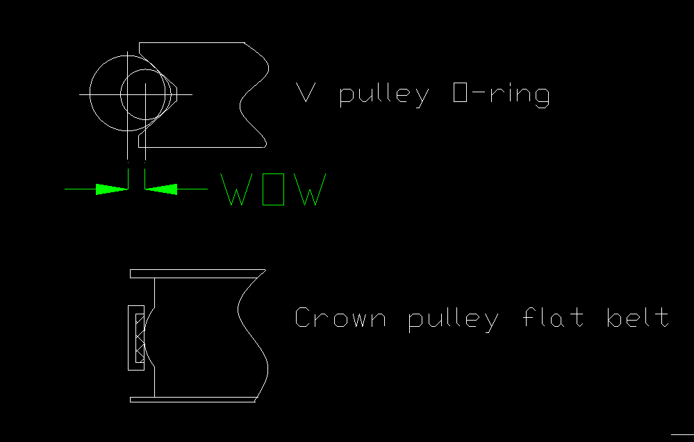

If I'm not wrong in calculating, 2um at 20 mm diameter pulley is 0.0001% or - 80db . that's acceptableThe manufacturer-approved method for getting the head drum on a broadcast videotape machine concentric after replacement was to tap it whilst monitoring runout with a dial gauge. <2um was deemed acceptable.
0.01% is 40db 🤔
6um over same 20mm diameter pulley should give 0.0003% or -70db, still perfect if it can be done in practice.
However, method I have chosen takes some time, than again I'm nt making series production but one off piece, so it is irrelevant cost - time wise.
Sure you are right, Im daft sometimes , or most of the time 🙁No, remember it's a percentage - a proportion of 100. Interestingly, your example of 6um over a 20mm pulley shows why belt drive turntables rarely beat 0.03%.

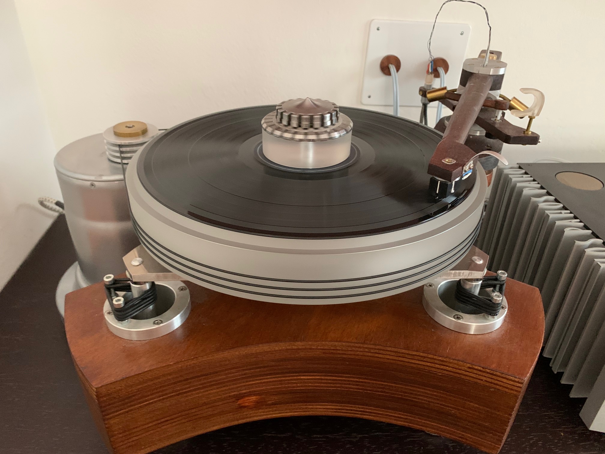

This phone app really gets things done , than I was wondering if there will be difference with stylus in groove and without it. If it is so sensitive it should capture stylus changes in friction too, This morning I removed paper strobe to free platter and this was set up:
As said, measured with stylus on record and without it, no changes to notice at all:
As conclusion, this App does all measurements that I need very sensitively. I can see even graph to analyze where any issue is coming from. A friend also used it on his TT, and results also there seem plausible.
Therefore I will stop playing with strobe and sensor, thing it is not worth it when this is easily available. Next will be test LP , with all variables included (LP, cart and arm).
