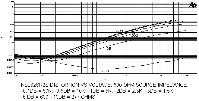

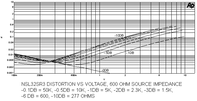

And here's a distortion curve for the NSL32SR2S.
These curves were created with a 600 ohm source impedance,
and the current through the diode was set to produce attenuation
of -0.1 dB, -0.5 dB, -1 dB, -2 dB, -3 dB, -6 dB, and -10 dB
which corresponds to
50 Kohm, 10k, 5k, 2.3k, 1.5k, 600, and 277 ohms.

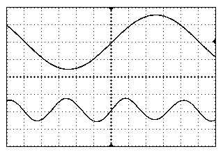

And last post of the evening, here's a scope shot of the waveform
and distortion, showing the 3rd harmonic content.
This shows that the element's resistance decreases in response
to waveform voltage. Used as a shunt to ground, this is a
compressive characteristic. Used in series, it has an expansive
characteristic.

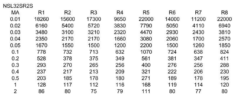

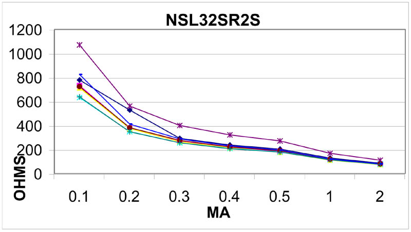

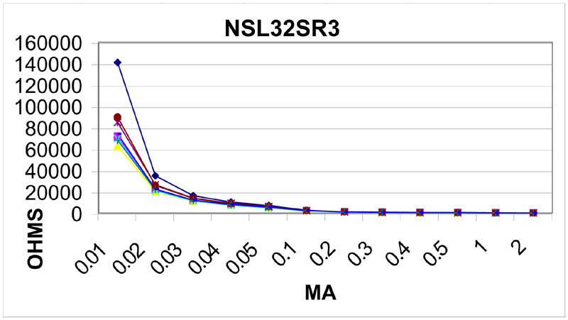

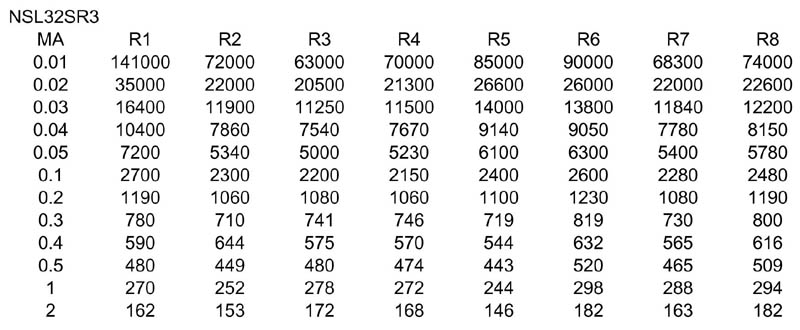

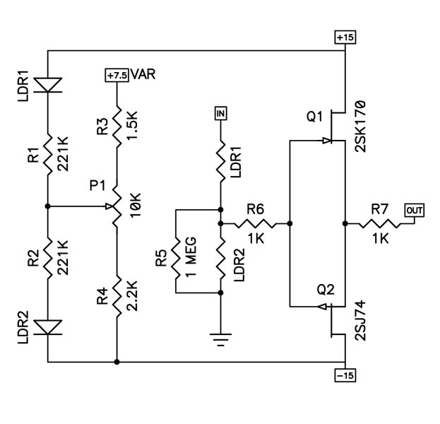

I chose the NSL32SR3 for its better matching, linearity, and range,
and created attached circuit.
The values of R1 and R2 were chosen to make the summation of
the resistors of LDR1 and LDR2 equal to 10K ohm, which then sets
the minimum input impedance of the circuit with the rail voltages
you have (in this case the commonly found +/-15V).
Then you attach the potentiometer with the values shown with the
bottom end going to the -15V rail and the top to a variable regulator.
The nominal value of this regulator is 7.5V, but it needs to be
adjustable so that you get the range you want.
The range that this was adjusted for was -1 dB at the top and
-40 dB at the bottom. More range is possible, but at the expense
of the taper characteristic.
The buffer section consists of matched 2SK170 and 2SJ74, matched
for Idss. If you do not have matched parts and DC offset is an
issue, then consider using an output coupling cap.
The bandwidth of the active buffer is extremely wide, and for that
reason 1K ohm input and output resistors are appropriate.
The distortion of the active buffer is about .003% on a clear day
at 1 V, which is less than you will be experiencing with the LDR
portion of the circuit.
Of course you can tart this up as you like - I consider this the
minimal circuit.

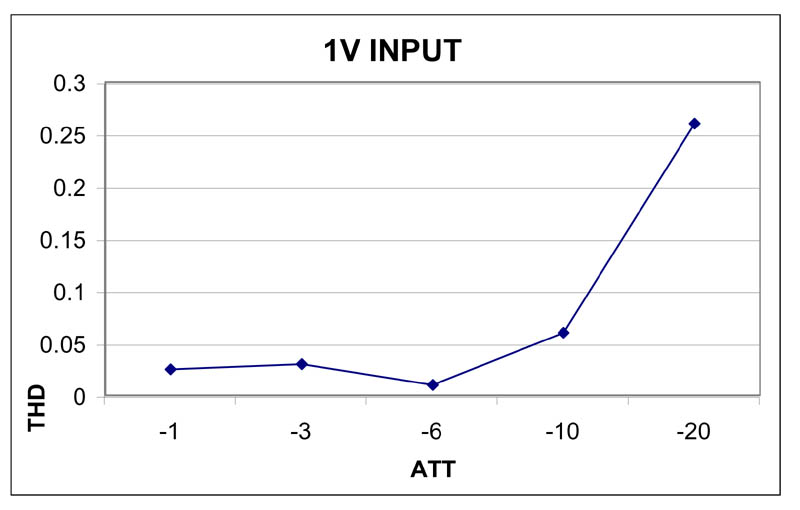

Lastly, here are the distortion figures I got with a constant 1 volt
input to the attenuator. More input voltage naturally results in
greater distortion, except at the -6 dB value, where the 3rd harmonic
distortion of the two LDRs cancels. From -1 to -6 dB, the distortion
is compressive, and from -6 to -40 dB the distortion is expansive.
Any questions?
