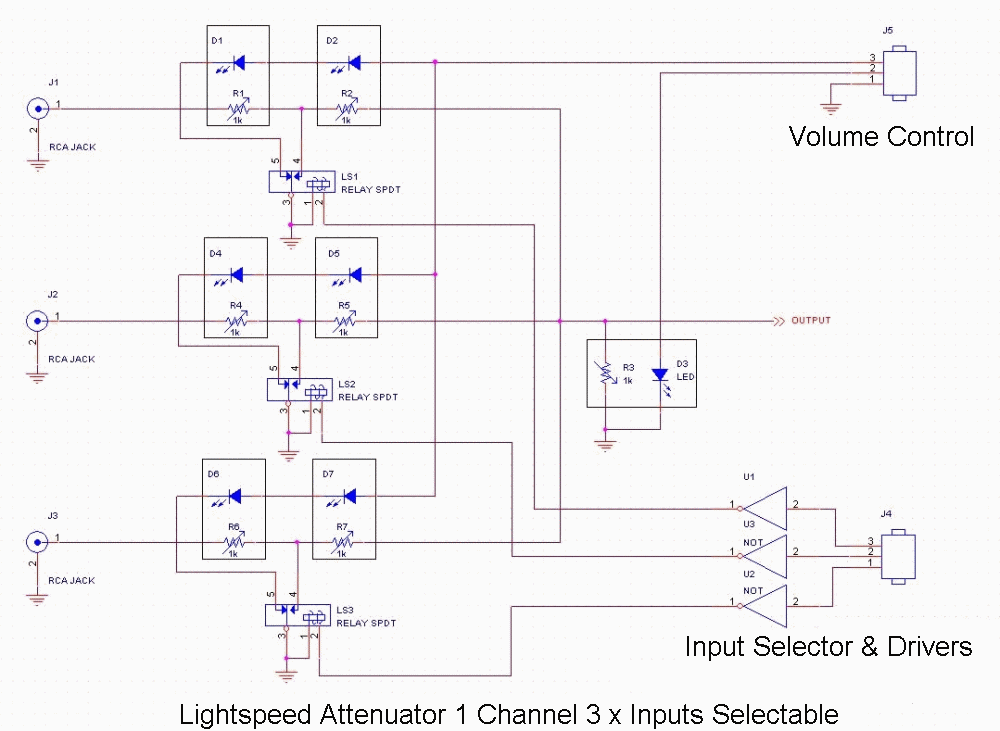

Been reading the entire thread, each and every of the near 1300 posts now, but I still need to ask... how many LDRs do I need to buy to get enough matched pairs? 🙄
Thinking of building the 3-way input selector version posted a few pages ago, seems that I'm gonna need seven matched pairs for decent stereo tracking... right? Is buying 30 LDRs (sorted) from Allied gonna be sufficient?

Hi Ventle, you need 2 matched pairs for my standard 1 input stereo Lightspeed Attenuator.
For the 3 input contactless stereo version, you need 7 matched pairs, the seventh pair being the shunt to ground ones on the output, 30 may just get you home in the matching stakes, make sure you have a carton of Panadol on hand and lots of coffee when doing the matching.

30 should get him home, but I would go the Qed route.
The Qed that I looked inside of had silver coated oxygen free wiring and for the switch it used a double leaf gold contact rotary Alps brand switch, if you have to use one this is about as high quality as you could go.
But still it was heard to be in the signal path, as when it was omited and the source was pluged in direct, it was as if someone had cleaned all the rca's sockets and plugs from source to amps.
Cheers George
Hi George, thanks for replying.
one of my goals with this "no compromise" amplifier would be getting everything in one box (input selector, volume control and power amplifier - just like the commercial integrated amps) - do you think that the contactless input selector version of the LS is gonna be inferior to your original series/shunt configuration? The way I see it the only practical difference is that with this design, you have two series LDRs connected in series compared to just one in yours, will this affect performance?
thanks again, and keep up the good work 🙂
wouldn't that be nice, the worlds first LDR-based contactless input selector😀
