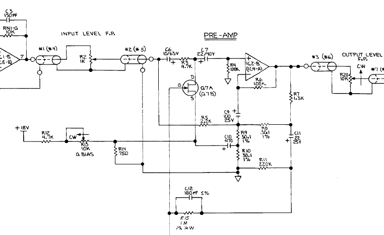

A known topology. Attached find a more refined circuit (linearized). Essentially the heart (voltage controlled gain cell) of the famous UREI 1176/1178 Peak Limiter. If you don't like opamps, replace it with a discrete stage (earlier models had discrete stages throughout) 😉
- Klaus
- Klaus

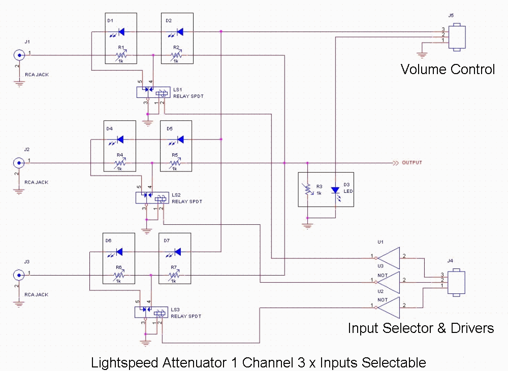

I am about to start building 3 mono LS MK2 clones.
The setup will be 2 Class D mono blocks for the side speakers + an active sub. The mono blocks work balanced and the sub is single.
The idea is to build a central control unit that contains:
-4 deck pot (3tracks to be used)
-2 small pots for L-R Balance.
-power supply for 3 x LS
-1 LS that drives the sub.
(+ 2 DACs and a set of filters + buffer for the sub)
The other 2 LS units sit in the Class D mono blocks housing, and will be connected to the volume POT pins.
I have 3 questions here.
1. I need to run a 4 meter (12 feet) 2 lead control cable from the control unit to the LS in the mono blocks. I haven't got a clue if this will influence my sound (I guess not).
2. Will the LS be able to work properly in this position (impedance??)
3. I am not yet clear on what kind of input selector (3x) to use
What do you think, will this work and ...... give the best sound.
Cheers
Peter

peterhenk said:I have 3 questions here.
Cheers
Peter
(this is the Class D unit)
Hi, Peter, my thoughts.
1: Depends on how strong I/ low z your source is
2: The amp seems to have a buffer option on the input wich is the best but still too low at 18k but this could be just a resistor change
3: If you really want to go all out do the one attached.
