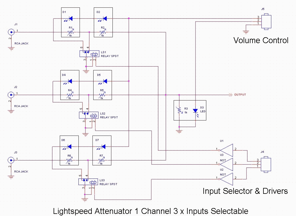

I wan't to add more inputs to my Lightspeed (3 or 4) because only CD is too less.
What would be best for switching? Reed relay, "normal" relays like Takamisawa or Omron 6k or some electronic switches?
This is the best I've seen, one of the members here thought it up, no signal degradation at all. Going to be a b***h to build, but all others are a compromise, no matter which one you use.
If you don't want to use this, then your better off using a QED input switch box in front of the Lightspeed, then when your serious about showing off your system, go back to direct and forget the QED.
Cheers George
Cheers George
Has the member just thought or has he built it? If I understand this circuit right there is much attenuation of the active source in comparison to a relay (0,1 Ohm vs. 80 Ohm). I think it isn't the Silonex 2R part but what is it (with 1k)?
What is the mysterious of the QED device? I can't see nothing out of the box.
