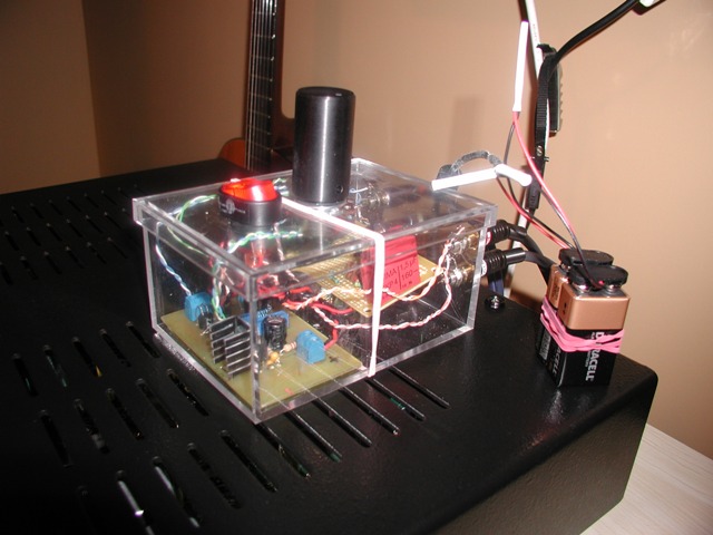

I've put one of these together and am really happy with the results. I'm not using it as a passive though, but as an attenuator in a valve pre. Sound is very neutral and the treble especially is just so far ahead of something like a alps pot.
Highly recommended! (and mine is the earlier version with just 2 LDRs)

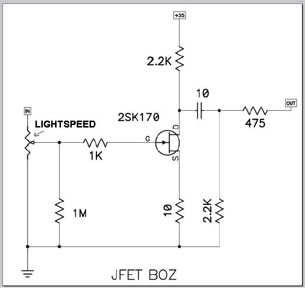

OK all,
I have built two of these LS attenuators and have finally hit paydirt.
I have just the standard LS as suggested from the beginning and but with a single pot, not dual. No fancy caps, or inductors, or anything like some of you have indicated...
Sounded fine with a Laptop Power supply, just needed a bit more gain to drive my Krell Clone/Magnepan MGIIIa speakers. I needed to crank the volume to 3/4 full at my listening level.
Next I tried two 9 volt batteries in series with an LM317 dropping the voltage to 12v on the LS. Much better clarity and presence, but still needed a bit more gain.
So here is what I did. I slapped together a JFET BOZ on the back end of the LS and powered both the LS and the JFET BOZ from the pair of 9V batteries in series.
This is it. Better than my M7 Clone Tube pre, my 12B4 tube pre, and a friends Melos SHA-Gold Reference I currently have.
All the gain I need. Sound is so crisp and delicate...
Listening to some Nora Jones right now and its bringing tears to my eyes.
Someone try it and confirm I am not crazy....

Great that you've seen the Light john65b, (I couldn't help that) the reason for your liking of the buffer after the Lightspeed is that the Krell has a low input impedance of around 22k, that would definitely load up a standard Lightspeed too much.
It would be nice if you could change that 22k input loading resistor to say 100k, (but never turn it on without the Lightspeed attached), then you could get rid of the buffer after the Lightspeed and get an even better sound.
After that and all is well, it would also be better to then change the input filter cap to ground from 470pf to 220pf when using the Lightspeed, this then will maintain a nice fast/transparent top end.
Cheers George

George and Maximus,
Thanks for your replies.
I would change a few things on my Krell Clone as you detailed out in your post, but may just leave it as it stands. This way I can try the LS/JFET BOZ pre on other amps (Aleph 60 and a ZEN amp) when I finish them.
I always felt the low impedance of the Krell was keeping the LS from really shining, but was confused by it sounding very good on one of my equally low impedance (22k) Gainclones.
Anyway, this LS/JFET BOZ combo is really nice and a keeper as far as I can tell. I am having a friend with "better ears" come by tonight to give me his impressions on it vs the Melos/M7/12B4 I have. He has some pretty impressive (read EXPENSIVE) gear compared to my DIY stuff.
Its always nice to see these guys with deep pockets squirm over my "cheap hobby stuff"...
