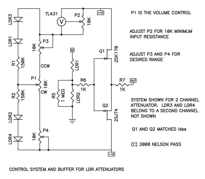

OK, this would be the last manual version that you are
likely to see. It has all the pieces, and allows pretty complete
adjustment of input impedance and range, top to bottom.
As a 2 channel piece, LDR1 and LDR3 should be matched to
each other, and LDR2 and LDR4 should also be matched.
The match should take place around the 5 Kohm resistance
value. LDR1 and 3 do not have to match LDR2 and 4.

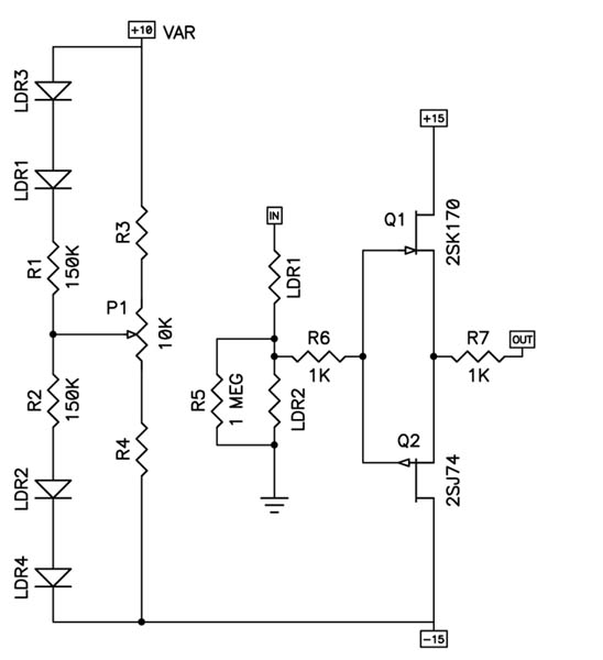

I thing this Lightspeed version has too less attenuation (-40dB) when you put the powerful JFETBOZ (+22 dB) behind it!
Stereo LDR Circuit with Buffers
As posted by Mr. Pass here's the stereo circuit in detail. Let me know if I missed something...😎
Nelson Pass said:OK, this would be the last manual version that you are
Tolu said:I thing this Lightspeed version has too less attenuation (-40dB) when you put the powerful JFETBOZ (+22 dB) behind it!
I deliberately chose -40 dB because the tracking was still pretty
good. In the lastest version, you can adjust the range pots to
get down to -70 or -80 dB if you want.
And of course you can have less gain in the JFETBOZ without
any difficulty.

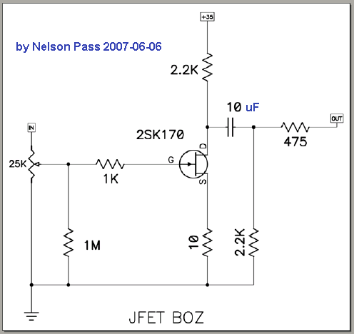

jboz buffer
Nelson,
Newbie question.........
What if I don't want any gain from the jboz. I just want the connection as follow:
" CD - Lightspeed with buffer - poweramp with 12k input."
I thought I'll need a buffer with 600R to 1K output, am I right?
Many thanks
Albert

your proposed buffer could have an output impedance of around 1ohm.
Just add a series resistor to make it tolerant of shorting the output.
100r would usually do.

albertli said:nt any gain from the jboz. I just want the connection as follow:
If by this you mean the 1K resistor already at the output of the
buffer, you'll be fine. You can play with other values, but at some
arbitrarily low resistance the circuits become prone to oscillatory
interactions with the load.

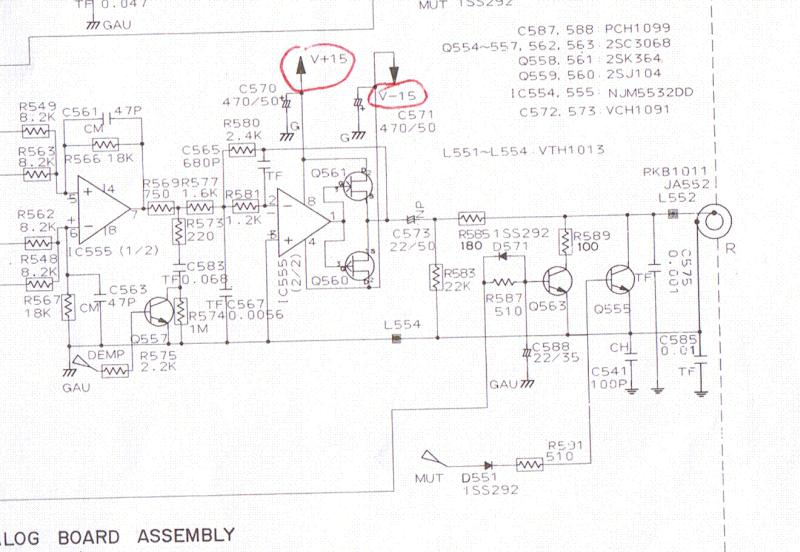

That's where I've seen this buffer before, Pioneer used it as well on the rear end of their top shelf "Stable Platter" cd players like my old PD-77 PD-75, they wanted to keep the poor old NE5532 isolated from the outside world, so they buffered it with this Fet buffer. But they kept it within the feedback loop, and they also used a NP "Nelson Pass" 🙄 coupling cap.
Cheers George
Cheers George

Nelson Pass said:
Hi, I'm late for this thread, may I ask a stupid question?
Are those 2 resistors of 150k (R1 & R2) there for reducing the current on the LDR's string, and making the voltage divisions by the VR string significant enough?
But, they also significantly reduce the voltage and current seen by the LDR's, wouldn't they?
So, the LDR's would never fully turned on, and there'd always be some degree of attenuation even if the VR is turned fully CW.
If I need this without the "buffer" stage, how can I modify the circuit?
Thanks a lot🙂
