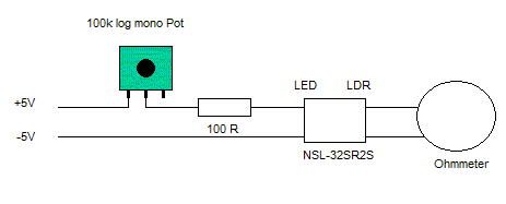

I think that your 100k pot is stereo and you doubled the impedance to 200k, or!? I just have a mono pot. On your circuit of mkII was only 100k log. So your highest LDR resistance will be higher than mine at 100k LED attenuation (3.3K). It would be nice if you can cofirm this and tell me what your highest LDR-resistance is at what LED-resistance.
Only to avoid any confusions about my LDR-R values, here is my measure setup:
@Andypairo
That's a good point which I haven't considerd.:smash:
If you drive 4 LEDs instead of one current decreases, logically!
I was just a little bit confused because in post #97 is a drawing of George with a dual pot. The later one in post #758 is just a single pot.
I think only for matching purposes it would be better to use a 200k or 1 Meg pot.
This evening I will complete it with plan mkII.:angel:
Regards
Thomas

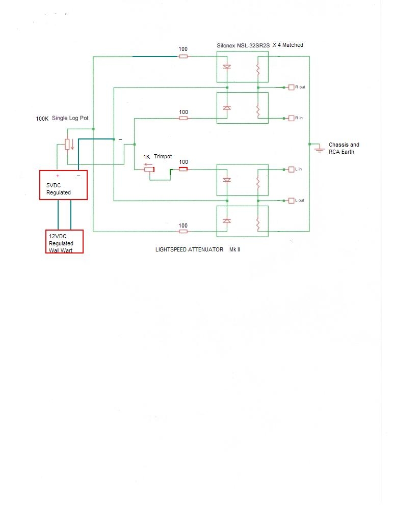

I am currently building my second Lightspeed, this time using a single 100k log pot and a LM317 Reg (orignal LS was dual 100K Log pot with LM7805 Reg). All LDRs are the R2 version.
After some critical listening in my UCD400/Magnepan system, it almost sounds out of phase - some music seems missing.
Bad matching of LDRs? I admit I didn't spend much time matching the slopes...nor did I do much on the second LS (lazy and busy with other things)
I am hoping the change from the dual pot and regulator may be the reason...but could bad matching cause an out of phase issue?

john65b, bet you have bad channel imbalance at your set listening volume, a couple of members have said the same as what you have to me, "out of phase, something misssing" then I told them to reverse channels, and then they saw the light. "BAD LDR MATCHING" what they had was no central image.
Cheers George

The newest schematic has a single 100k pot... +5V supply to wiper and two other leads from single pot to the LEDs...no need for a dual 100K pot anymore.
The single 100K Log Pot I have now is switched, so I can turn off the unit from the knob. Real handy.
Wow. I had no idea about the new schematic! That's what happens when your on vacation huh!
I'll do another pcb for the new setup and try that one.
Thanks for the heads up John.
Bear
Bearman,
Your PCB is fine. No need to modify it.
You have three connections for the pot on your pcb. One "5V to pot" and two "from pot". The "5V to pot" connection goes to the pot wiper (center lug on pot), and the "in" and "grnd" of pot goes to either of the two remaining " from pot" connections on your PCB.
That should do it. One side rises while other side falls.
