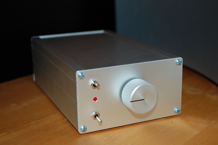

First report
This evening I had a small listening session with Diana Krall and Holly Cole.
The counterparts: Lightspeed MK II and Tolu Opamp Preamp
The amp: Atoll AM 100
The speakers: Tolero with Eton 9"-bass and 6"-mid and ER4 for tweeter
I am very confident with the Lightspeed because matching was a full evening job but I think I did it well.
Conclusion:
The LS played well at all. The spatiality was impressing. Mids and bass were good and appropriate. Voices are paramount.
The Tolu Preamp: He gave more details than the Lightspeed. If you know "the girl in the other room" from Diana Krall, there are many cymbals, brushed hi hats, bells etc. With the opamp pre every little detail was hearable. The well-known curtain was blown away. But these many details let sometimes miss the complete impression at all.
What I liked with the Lightspeed is the laid-back atmosphere. He isn't a nitpicker but a gentleman. He plays with maturity and dignity. I like that. But I cannot say he is the winner so far if it is even possible to judge black or white.
I would say for the moment: tie (with little advantage for opamp)
Well, wait for next game.
Regards
Thomas

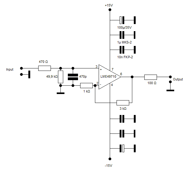

Tolu said:The counterparts: Lightspeed MK II and Tolu Opamp Preamp
do you have a recent circuit diagram for your op amp pre amp ?
what op amp are you using ?
mike
Hi Tolu,
how about reporting the effect of adding 100nF from pin7 to pin4?
and whether lowK ceramic (NP0 C0G) works as well as film in it's various guises?
AndrewT said:Hi Tolu,
What effect on sound would you expect with the C between V+ and V-? It's a little bit inconvenient, isn't it?
I haven't tried various part qualities so far. Do you have some good proposals for replacement? (Manufacturer, part #)AndrewT said:and whether lowK ceramic (NP0 C0G) works as well as film in it's various guises?
The PSU has much room for improvement as well (7815, 7915, cheap Cs). The attenuation is at the moment a cheap Alps RK09.. because I burned down my blue Alps pot. Relay control would be next step because I like R/C!
One research goal is the improvement of spatiality. Perhaps a relay attenuator with 1% or 0,1% Rs will get it.
Tolu said:Hi Mike
here it is. I am still in research state but I am almost very content with it. It hasn't to be always discrete...![]()
Regards
Thomas
Are you inserting the LS at the input or output of the opamp?
Whether...nor!
I tried them separately. The LS as passive preamp versus my opamp pre! The opamp pre has an own pot! But perhaps it is a good idea to try the LS as attneuator for the opamp pre!

AndrewT said:how about reporting the effect of adding 100nF from pin7 to pin4?
mount the rail to rail cap directly on the pin7 & pin4 on the back of the chip i.e. on the copper side and lay the cap flat against the PCB with the body of the cap as near the middle of the chip as possible, not off to one side and NOT outside the profile of the DIL pins.Tolu said:What effect on sound would you expect with the C between V+ and V-? It's a little bit inconvenient, isn't it?
It should help to remove glitches in the power supply from affecting nearby chips/circuits and it should help meet transient current demand inside the chip. This could help clean up transients and help treble clarity. i.e. it should sound nice with no sibilance (we hope).
