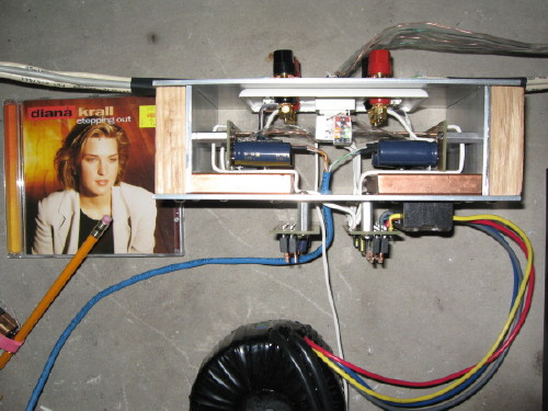

Another convert to the Lightspeed
Gents
You have another convert. After reading this entire thread, I felt that the lightspeed is the best in price performance for high quality attenuation. I wired it into a Peter Daniel chip amp I just completed, and I could not be happier with the performance. Thank you Georgehifi, Panelhead and Mikelm for your thoughtful research. A description of my project with pictures is at:
http://www.diyaudio.com/forums/showthread.php?postid=1272297#post1272297
For those wondering about the matching issue, I really got very lucky. I ordered 8 sorted optocouplers from Allied on a Tuesday and they were at my home in Toronto Canada 3 days later. All were from one batch at "C" range. Out of the 8, I got 3 pairs of very close matches. I did the matching more or less in circuit by putting 6 in a row in an IC receptical in parallel and one other on the other side like a shunt. After applying power and letting them warm up, I measured resistance of all six at lowest level on the pot and took all the readings in a spreadsheet. They would be about 60r. Then cranked the pot up a bit to about 100r and recorded all again. Then I repeated at about 300r.. again at1k and at 2k. With 5 readings on six optocouplers taken in about 30 minutes I had a pretty good read on where the matches were. I pulled out one matching pair and substituted the last 2 of 8 in the rig and measured all at 5 points on the pot again. At this point it seemed obvious where the best two matches were.
Once wired into the circuit the results were very good, and the balance quite stable across the normal listening range. I did wire in a 1000r pot as a balance control per Mikelm's post that I think is a useful addition.
I ran it first on a 9-volt battery behind the 5volt regulator for a couple of hours. I then wired in a 12volt 100ma radio shack power supply in place of the battery. I did not see any degradation in sound.
I did find that my minimum volume is a little high, so I will try pumping up the power a little by playing with the 100r resistors.
Attached is a picture of my finished amp. The optocouplers are at the end of the blue cable soldered directly to the chip amp pcbs. The cable goes to the lightspeed control unit with the pots and power supply. I really like the idea of being able to put the pots out front in the chassis without increasing the signal path.
Thanks again to all who made this possible!
wlowes, good work. Glad to see another convert to the Lightspeed flock, also good to hear that maybe the selection process is getting tighter from Silonex, your description of the sound in the other forum couldn't be more accurate.
