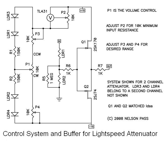

Peterm100: Peter, could you diagram here what you did for balance? Anyone else?
Thanks,
Paul
Thanks,
Paul

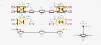

Parallel Approach
This is a schematic from the pcb production, should get the idea across. Happy to share the gerber files if anyone is interested... RV1 is the balance control, RV3 is volume.

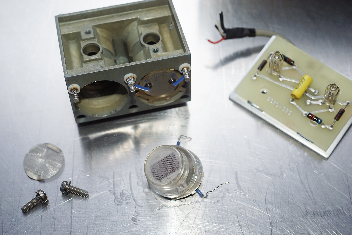

Diameter of each plate is 22mm.
If you can get a hp 3420b cheap somewhere...
This thing came back to the surface...
A pair of LDRs on each side, but on one side there is a mesh in front of the LDRs, dimming the light, also the plastic is scratched. So it needs polish and remount without the mesh.
Close to the bulb of a working light it goes down to 90 ohms.
Are the LDRs usable for a lightspeed ?

If you check the starting page of this thread, most of your questions are answered there.
The LDR matching is done at three places between 1mA to 20mA. (Usually 2.5mA, 10mA and 20mA)
If you’re at all uncertain on construction, I’d suggest you purchase an assembled Lightspeed & proceed from there.
Hope this helps.

Series/shunt design.The LDR attenuator is a shunt design.
Log dual 100kohm pot, as linear will come on too strong early in rotation.The quality of the 100k pot does not influence the results. I am not sure yet wether logaritmic or linear is preffered for the pot
I used to wax pot all 4 thinking the same early on, then I stopped. As it's built on page 1 you don't need to wax pot them as nothing makes them shift out of being matched. You may have to wax pot them if inside an amp.The LDR will be sensitive to differential temperatures over the LDR's.
Cheers George
