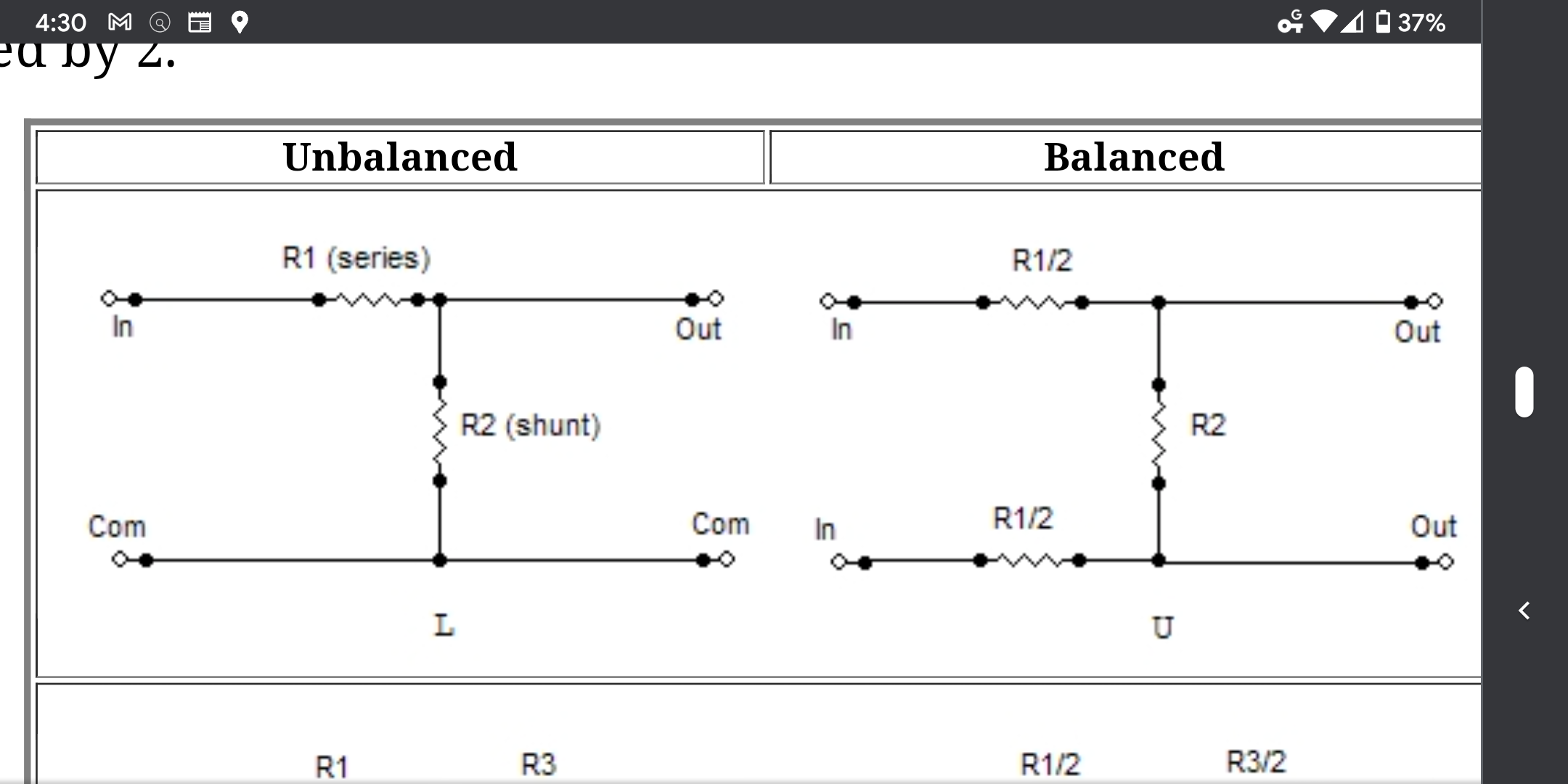

Like on the left channel you'll have a positive and negative line. Each line gets a series resistor and those series resistor terminate into another resistor which is the same resistor. I'm on my phone so I can't draw it. First series resistor A terminates into resistor C. Second series resistor B also terminates into C. Then both A And B lines continue on to the amp.
Few minutes later... Found a pic of what I mean online

Thank you! The schematic in #5742 is my missing link. I can calculate the voltage dividers with constant equivalent resistance. The following scenario should lead to the goal - although it is quite labor intensive:
Instead of potentiometer (100K) and the individual normal resistors stored in the circuit, set the target resistance in the signal path 6 times for each volume level and measure the electrical values for it, which are then electrically adjusted and tested in the control path. The best possible heat dissipation must be ensured. The whole thing then works like a stepped attenuator. In my case software controlled.

What do you think about this idea?
6 Resistors:
https://www.gearslutz.com/board/att...ed-volume-control-pad-balanced-20db-rev1-.jpg
8 Resistors:
https://www.gearslutz.com/board/att...ed-volume-control-pad-balanced-20db-rev2-.jpg

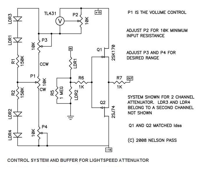

TJF, You can also take a look at the simple circuit that Nelson Pass made.
Mind you, I think the circumstance he is particular to, so sort of a requirement, or one might say, relaxing a requirement, is that only the upper 10-12 dB need be lineair. So he does one test at that range.
Explain: Within a chain with minimal amount of amplification (his power amps typically do 5*, preamps typically 1*) you need only a small part of the attenuation. Idiots like me use a preamp after a potmeter that attenuates 40 or 30 dB's . . in my case, possibly ruining everything called HiFi, because you mght loose something even with the Black Beauty I have on one preamp. Because GeorgeHiFi uses a dynamic shunt so to say, he improves a lot on a standard shunt I think.
The bonus: he uses two LDR's. For balanced, this is easy to convert to four.
The pass circuit is not suitable for me. I need a very precise matching of the impedances and above all a constant equivalent resistance.
Ah, that is a very good argument. {I have a set of constant ohm studio atts - I can understand why}
If anyone's interested, this was a buffered Lightspeed Attenuator for driving his low input impedance power amps of the time that Nelson Pass kindly donated, it was later to be called his B1 buffer.
