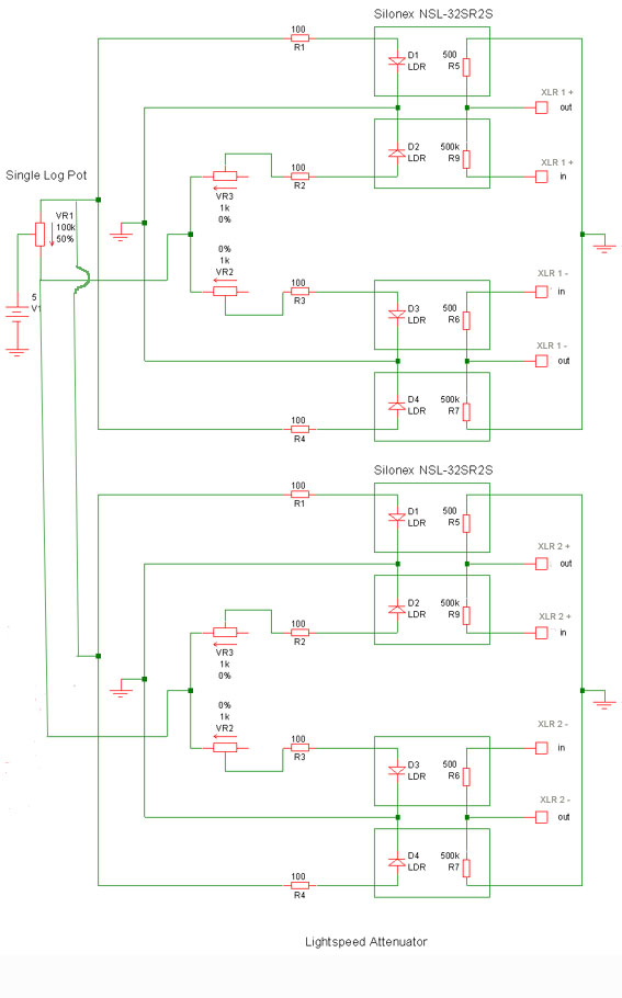

I understood that the LDRs are not identical and therefore it is necessary to do a search to find those that are closest to equality between them.
I did not understand if this difference concerns the current (mA) -resistance (ohm) curve or if it is the total resistance measured at its ends that is different.

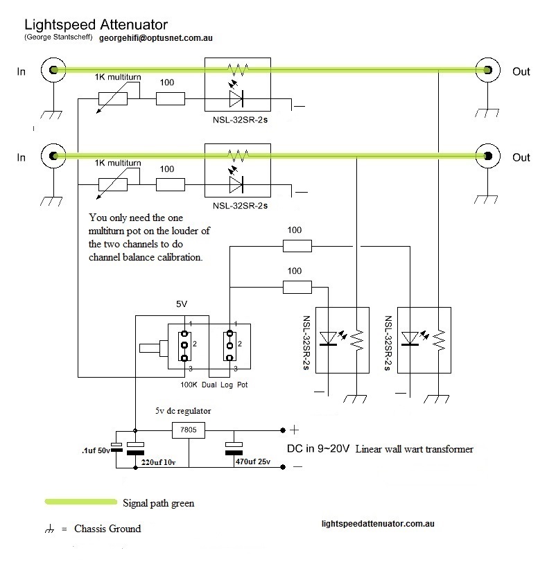

@arivel
You know each of the 4 x NSL32SR2/S have 4 legs in each package ? 2 are for the LED section and 2 are for the LDR section.
You power up the LED section (2 legs) using the led tester on my first post and measure the LDR section (2 legs) using an ohm meter.
And at 5 different led power from 1mA to 20mA you match the 5 different ohms readings of the LDR section for a total of 4 NSL23SR2/S Then you have a quad matched set.
You "can" match at 3 different powers but you won't get left and right channels tracking as good, and probably hear the imbalance.

so if I understand correctly, the problem is the curve of the resistor , which is not superimposable one on the other.
Yes the ldr resistances are never the same for the same given led illumination intensities, they have to be matched up.
Some Lightspeed clones try to auto force match them with active circuits with extra mA to the weaker ones on the run, not only are they then included into a sort of active feedback network.
But there's a big problem with that some led/ldr could easily be over powered to meet the lower resistance of other led/ldr and will lower life expectancy greatly.
That's why it's best to do them manually as I've outlined, as none get over powered or under powered, as they all receive the same current.

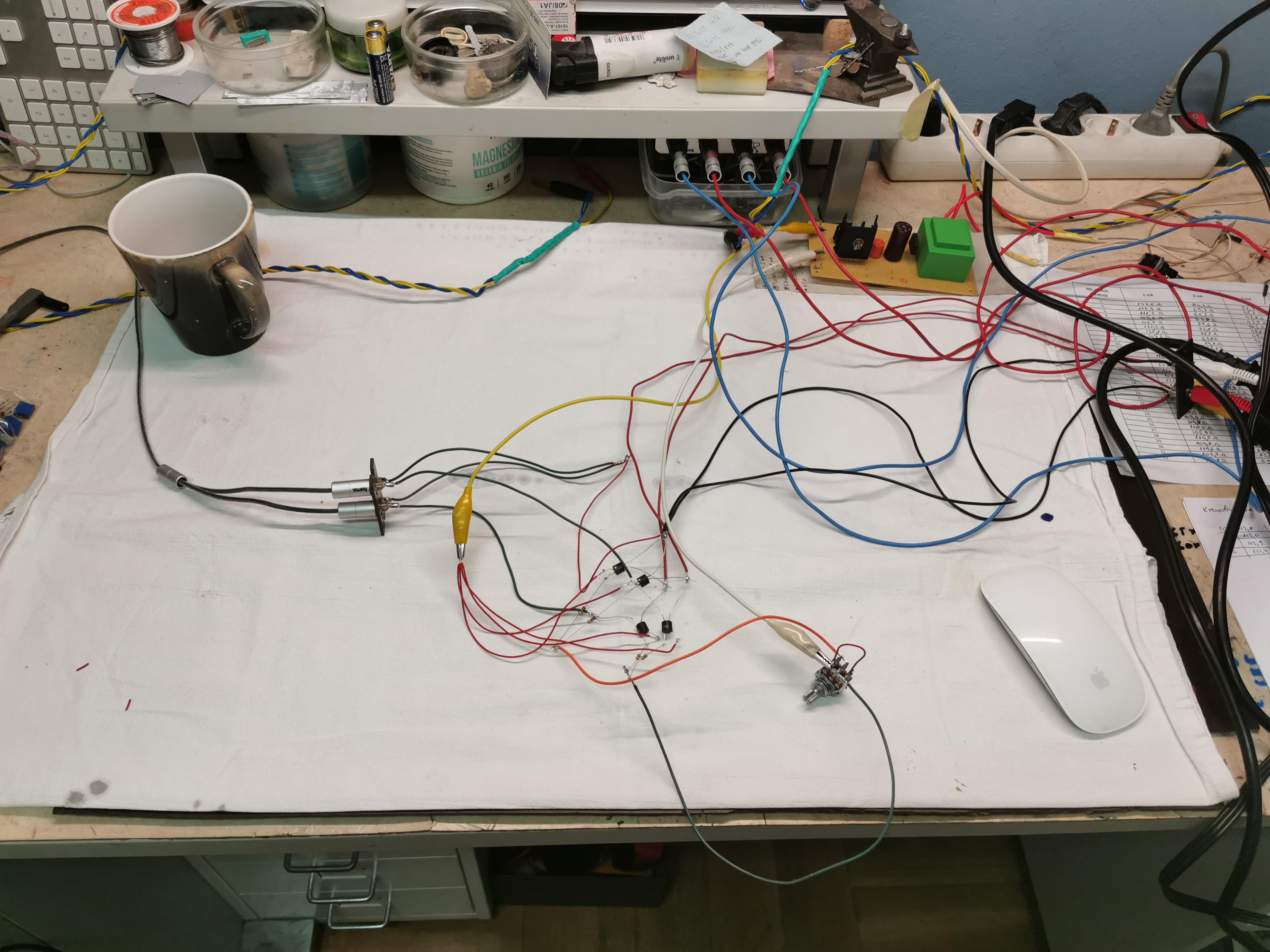

Yes... I did it today...
After many hours of measuring and selecting...
Works perfect, but it seems that I have some crackling and noise... Because of bad contact or long wires that collect all dirty things. Or perhaps something else...?
Now is connected output from Apple Mac mini (youtube) and output is LM3886 amplifier. It's not recommended chain, but works wonderful...

Question for George... In minimum potentiometer position I can hear the sound. I tried to read and find where is this problem described, but there is over 5700 posts and I read about 200 pages. Cannot see... Is there any fast solution for this in a few words...? I did it exactly as you explained. No problem, fine works and souns great, but in the lowest position still have the music and it's not silent...

No problem as they can never go to 0ohms, there's always some very small amount of signal.
Hint: never leave them powered up full up or full down, if not listening for a few days, as this powers up one pair of the leds to full power, and "could " halve their life expectancy
