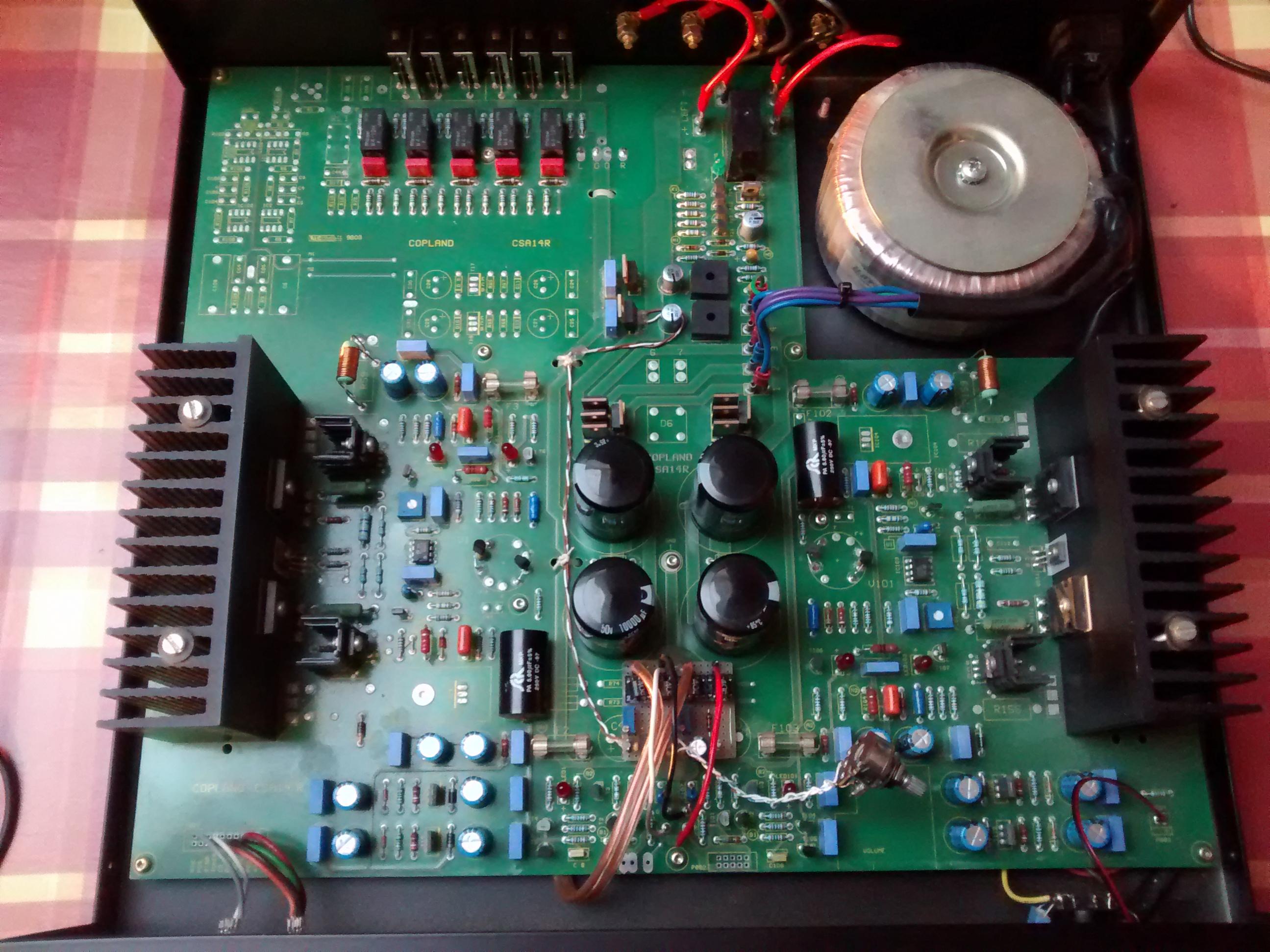

Hi guys, just a feedback:
mounted the second kit provided by Uriah on a Copland CSA-8.
I choosed 2way pot for 20k total impedance. Perfect balance tight, round and powerful bass, airy mids, more refined highs, stable and focused stage.
What can i say?
Many many thanks George and Uriah!!!
What can i say?
