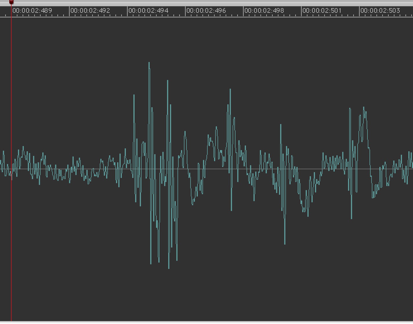

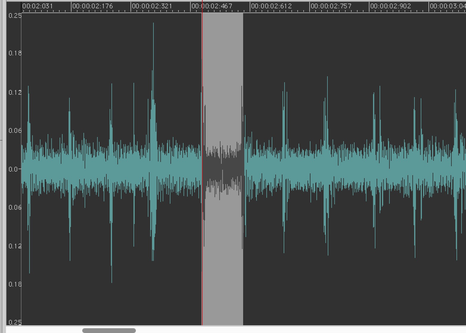

George, I just opened the sound up in an editor and the peaks of the rhythmic noise are about 0.1 seconds apart - so it's something happening at about 10hz, and I too think it is something with the Sonos. Has your client tried a simple pot to see if the noise is still there. Maybe a Bluetooth or streaming resync thing?

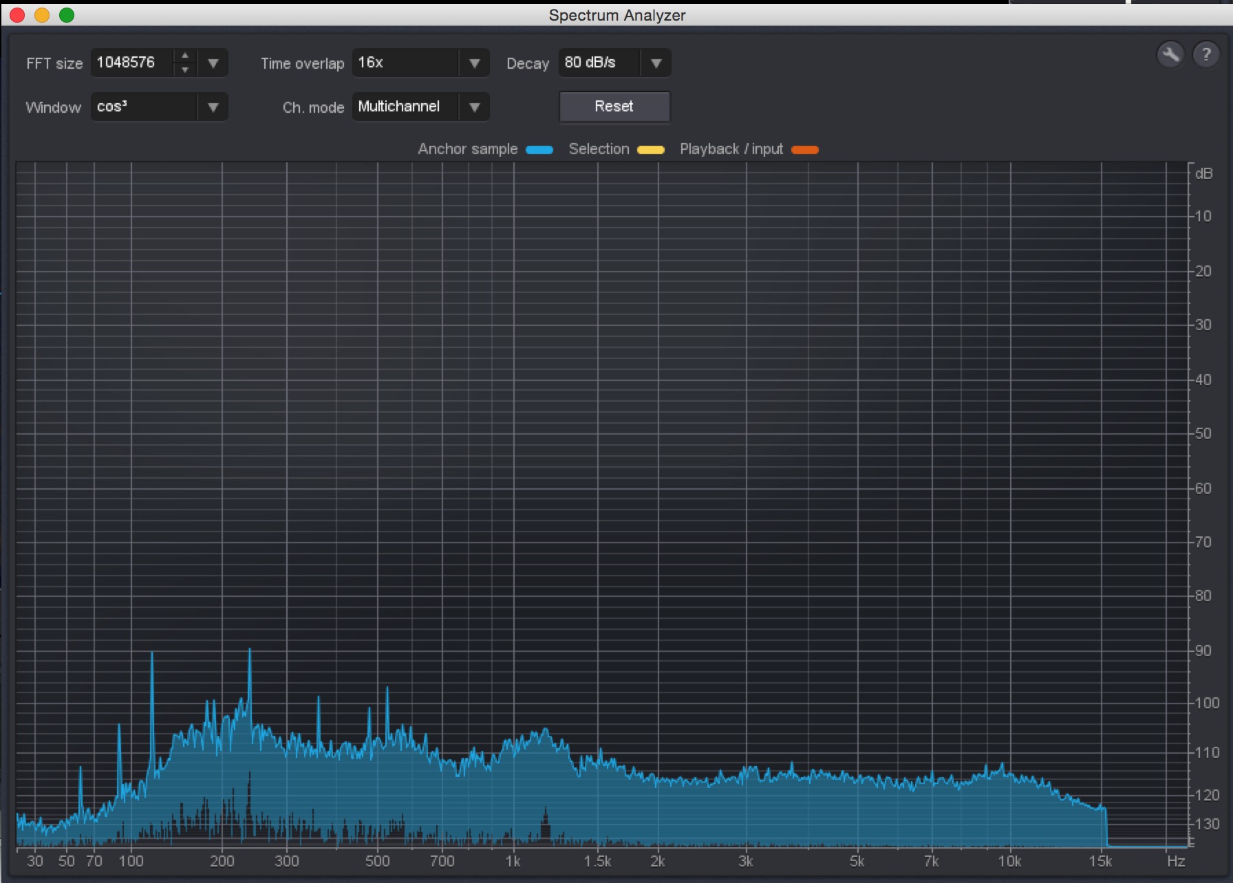

I did a spectrum analysis and there is nothing much to see. I can post it if you like, there is a little 60Hz, 120Hz garbage at around -90db. Each of the 10Hz blast has 3-5 cycles - I'll just include some pics.
