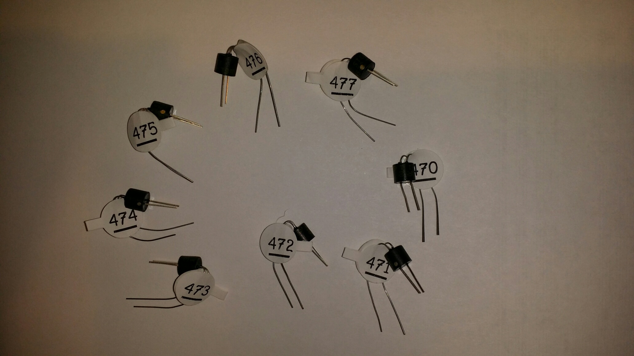

I have 5 matched pairs supplied by Udailey that I will part with. Problem is I lost the sheet with measurements that show which of the 10 are pairs. If someone wants them as is PM me. Otherwise at some point I will get around to measure them and put each pair in the swap thread so they get used. 🙂

Pic of matched set
They are reserved already so it looks like they find a good home.
