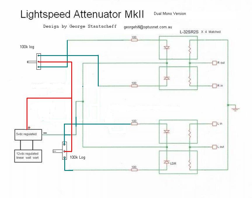

Andrew is right, dual mono (attached) will solve your problem, of not matching well. About 20% of my sales now are dual/monos, And for some unexplained reason customers that have both units say the dual mono sounds better, I believe it's because they can get prefect imagining even with unbalanced system/rooms configurations.

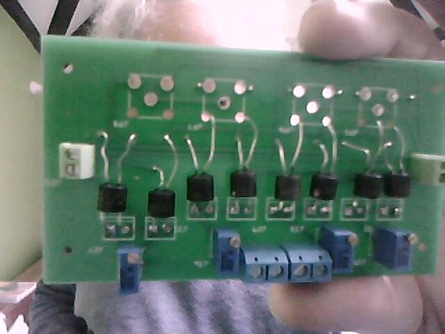

Easier to use a LDR board where Left and Right anode current can be trimmed
and if current is stable that stays that way.

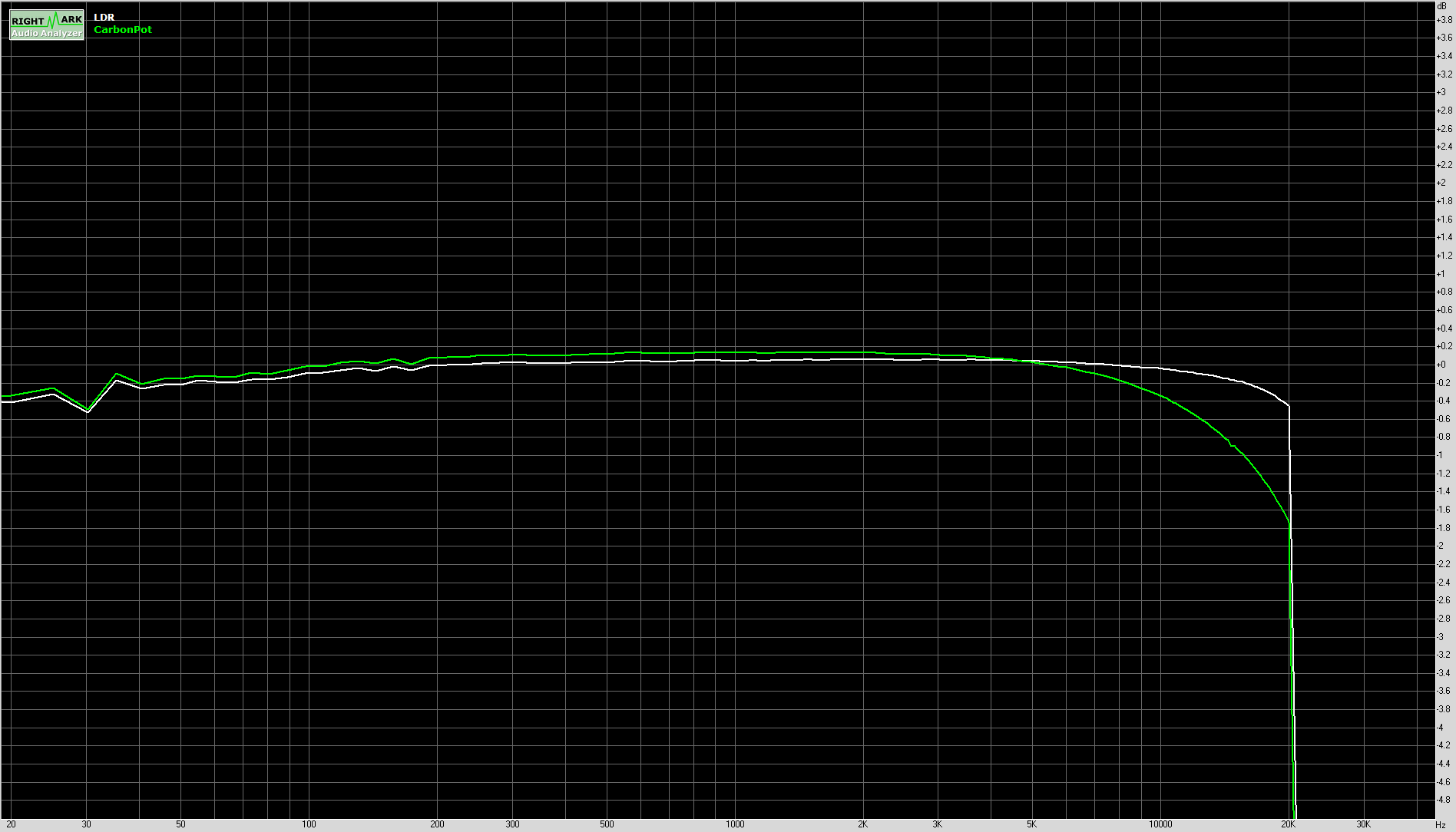

I found the attached pic very interesting, i used RMAA to plot a frequency response with the LDR and a regular carbon pot. I was surprised how much high end gets lots in a cheap pot...

I have never done a frequency response measurement comparison, between LDR's and potentiometers.
This is very interesting mcander what brand and value pot was this, as -1.6db at 20khz would easily be heard?

The pot i used for testing was an Alpha so it was of somewhat decent quality. Its fairy new but hasn't had that much use as its spent its life on my prototype board testing out different amp circuits. In other words, its not an old dirty worn out unit.

A 100kohm pot would have a high output impedance, and if your measurement leads that were attached to it's output and had high capacitance, this "could" be the reason for that hf roll off.
The measurement lead would have had to be something in the order of 200pf for a meter for that to happen, if that were the case for the HF roll off.
Try a 10kohm pot to do the same measurement again instead of a 100kohm, as the Lightspeed mimics a 10kohm passive pot in input and output impedances.

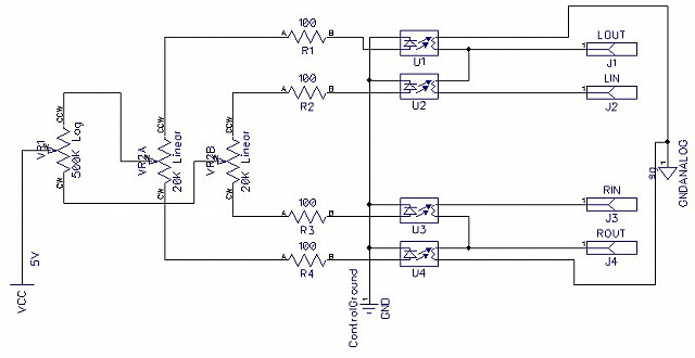

The problem in that with the pot in minimun, the sound is very high. I think, I can put more value for R1 to R4, but I´d like know other opinion.
I suppose the reply any post of this thread but I´ve don´t cant find it.
Thank you very much in advance for your help.
I use this schematics:

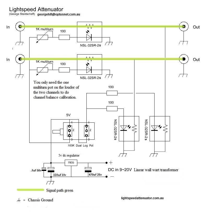

Dumb question I guess. I have been looking into TVC passive preamps as the optimal solution. But now I find this thread. I have not read it deeply yet. However, the idea presented at the beginning is that the signal path only sees a single soldered resistor and does not see a potentiometer with its rubbing metal to metal connectors.
However it seems to me that any bad effects due to the potentiometer would be passed onto the signal through the opto-resistor chip albeit perhaps buffered away. So is the system truly isolated from the pot? A devil's advocate might say yet another interface in addition to the pot has been made.

Hi bcc1955, attached is the schematic, the green overlay is the signal path.
The volume control (led controller) has nothing to do with the signal path.

The opto chip modulates the resistance which is how it works. But I guess it is fair to say that the connection with the pot and the signal is indirect and perhaps any pot based distortion (as opposed to weed based distortion which intensifies music satisfaction IME) is buffered/muted by the NSL32SR2S opto-coupler and improves the sound we hear. That would appear to be the case for this system?
No modulation. The ldr is a resistor so if you look at the schematics you'll see the ldrs create a voltage divider. Thats how it attenuates. There is no electrical connection between the pot and the resistive side of the ldr. None at all. Its light that increases or decreases resistance which then changes voltage division equation. So the pot could distort all it likes...you'll never hear it as its not in the same electrical circuit.
