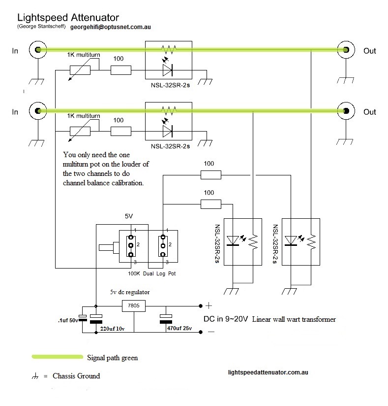

No modulation. The ldr is a resistor so if you look at the schematics you'll see the ldrs create a voltage divider. Thats how it attenuates. There is no electrical connection between the pot and the resistive side of the ldr. None at all. Its light that increases or decreases resistance which then changes voltage division equation. So the pot could distort all it likes...you'll never hear it as its not in the same electrical circuit.
Oeh, my brain hurts. Does the pot not change the light and reflect its distortion in that manner? If not how does one change the volume? I am not getting it.
The pot changes the light. The light shines on the light dependent resistor. Thats not an electrical connection.

The pot sets the level of constant bias current in the diodes, which then emit a constant level of light
that shines on the LDR, which sets the operating resistance of the LDR, which sets the attenuation level
and hence the volume. The pot has nothing to do with the audio signal directly. There's no distortion
due to the pot in the light going to the LDR. The light is NOT modulated with the audio signal.
However, the LDRs themselves DO generate significant distortion because they are not as linear as
conventional resistors. Some measurements can be seen here:

Only when over driven, if the signal is at Redbook CD source level outputs, it remains way under .1% (even on heavy transients) and that is mainly the "nice" tube sounding one 2nd harmonic. Which is maybe why so many like the sound of the Lightspeed. Also another reason maybe, it's conductor instead of being metal film or carbon as in resistors or pots, is Cadmium Sulphide, and no contacts like resistors or pots need, which are dissimilar materials and very light weight contacts, which they need to change their resistances.
And Rama is right bcc1955, a led does not flicker (is what I think your getting at) when driven from a good power supply and has no modulating effect on the LDR. Beside LDR's are very slow to react to light changes and in a way are self damping to that as well.

There appears to be a claim on this thread that ... the LED light emission is absolutely constant regardless of current distortions caused by the pot this device claims to remedy.
OK, let's assume that you are right, that the potentiometer that controls the LED's has "current distortion". How would you characterize this distortion? Is it harmonic distortion? The pot is controlling a DC voltage supplied to the LED's. What is the second harmonic of DC? The third harmonic?
OK, maybe it's intermodulation distortion. The pot is only passing DC, so what are the IM products?
Or maybe you mean noise? Fair enough, but because of the slow response of the LDRs and the filtering across the pot/LED, even a very noisy pot is unlikely to cause significant noise-based modulation of the audio signal.
Again, the audio signal does not pass through the pot.

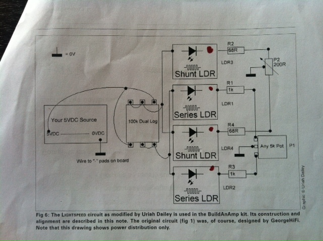

The input impedance of the LDR is roughly equal to the sum of the series and shunt resistances.
For higher values of attenuation the shunt LDR needs to go low and that is set by the 68R+VR (~200r/2)
The series LDR has little effect at low levels of attenuation and thus does not need a resistance as low as the shunt LDR.
The minimum series LDR resistance is set with the 1k+VR (~5k/2).
These two sets of LED current limiting resistors can be any value that suits the builder provided that the maximum LED current does not risk damaging the LED/LDR in the long term.
But the input impedance is not significantly affected by these current limiting resistors.
It's the current fed from the tracks of the 100k volume setting pot that sets the input impedance.
More current = lower impedance. Less current = higher impedance.
These impedances are not constant. They will vary with volume setting, much more so that with a conventional vol pot feeding into a load that is 10times higher.
If you want to experiment with varying the LED current to see what effect it has on the input impedance, you can replace the fixed 5V supply with a variable supply.
I'd suggest one that can be varied from 3V to 6Vdc.
At 6V a bit more LED current than standard will flow and this will lower the input impedance and lower the output impedance.
Conversely as you lower the voltage towards 3V the LED current will drop and the input/output impedances will increase.

I have a vario source with LM317 put in 3v or so and the music sound a litle high. Maybe isn't be the other way.
Another question is if is necesary join de ground signal with the ground's led the same of the last George's schematis.

Jose
Try giving the lm317 a few more volts and give the ldrs at least a bit more than a diode drop. You can give them quite a range of voltage so long as you make sure they dont get too much current. In most cases 10mA is enough.
